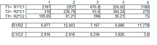

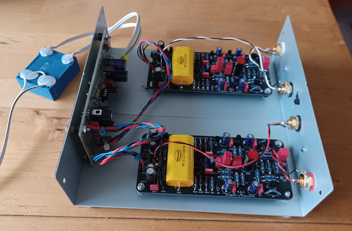

Time constants:
Elektor has selected network number 2, also known as the passive AllInOne solution, with R1=150kOhm for its SUPRA; let's just stick with that, also presented in 1980 by W. G. Jung.
R2 = 150kOhm / 12.403 ==> (12kOhm plus 93.85Ohm)
we choose
12kOhm *
C1 = 2937µs / 150kOhm ==> 19.85nF
we choose
10nF FKP || 10nF FKP *
C2 = 81.21µs / 12k094Ohm ==> 6.715nF
we choose
3n3F FKP || 3n3F FKP *
* just like (in) the Elektor-Original

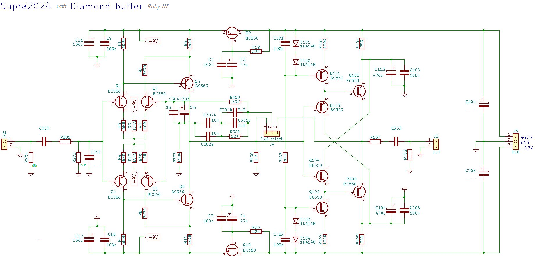

As we do not want to have a DC offset, R202 and R302 must be the same value, i.e. 150kOhm. A possible DC offset also distorts our beautiful diamond - another reason to use R202 ..!
R202 || r_core_inp || R204 should be 47kOhm

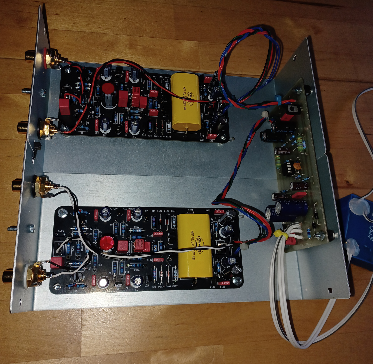

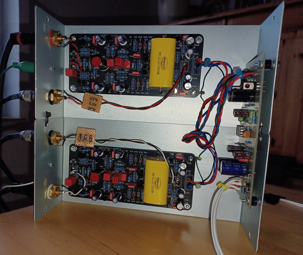

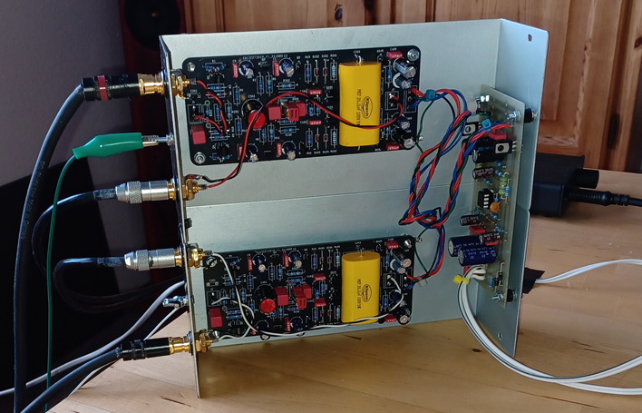

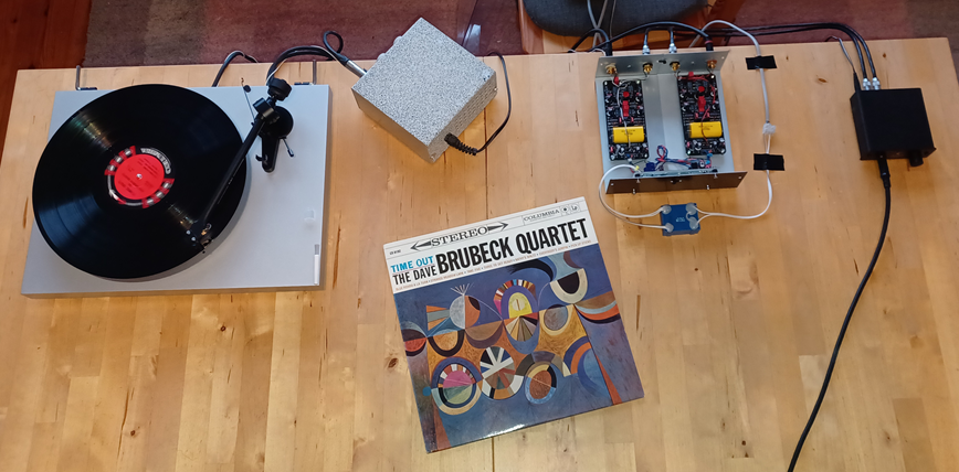

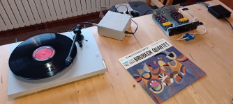

A quick word about shielding:
I'm currently playing with the electromagnetic coupling on my test surface (a normal beech dining room table).
The analog speedbox has to be far, far away,
the thin aluminum sheets have to be connected to the PE (and GND) ... experiment a little with the setups (i.e. interferences) ... turn the headphone amplifier all the way up ... and listen to the interference(s) ... Noise? Not a chance!
With the most careful setup, there will be practically no noise, no hum. At the moment I'm using the simplest and cheapest (balanced) power supply in the world.
I use the already mentioned power supply (original from Matsushita, brand Technics and Panasonic, Japan) to demonstrate that equalizers do not necessarily need an overkill super-duper PSU.
But this is about shielding: To shield H and B fields, we need three layers of metal: sheet steel, tinplate and copper or aluminum.
I wish us all a lot of fun,
HBt.

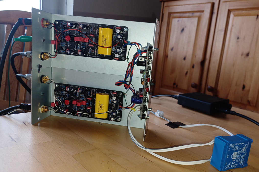

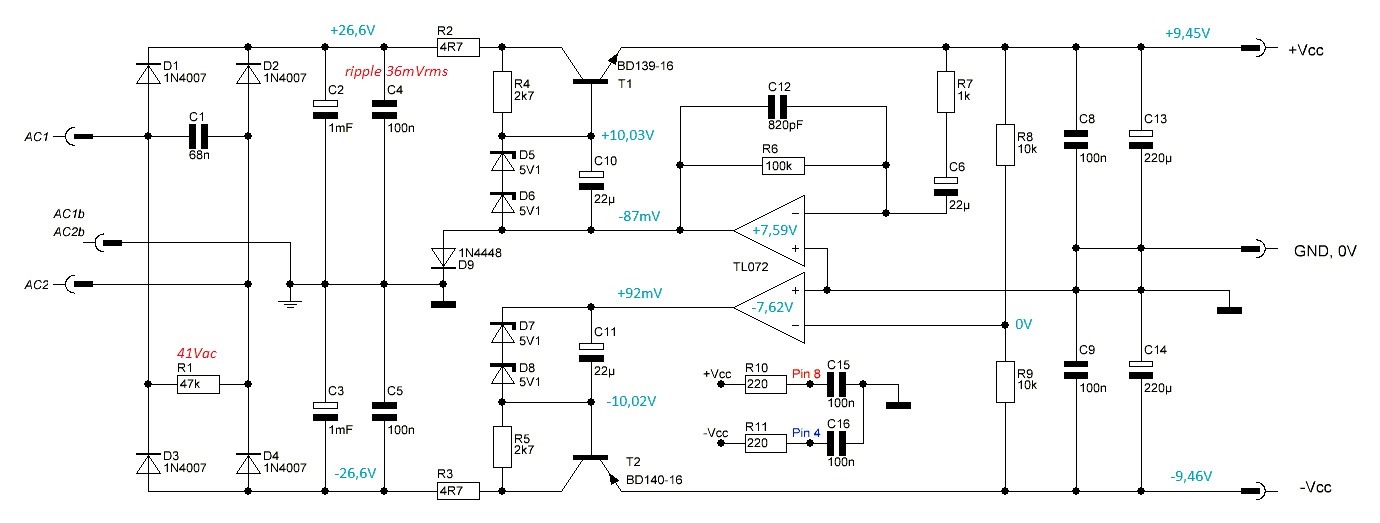

the smallest psu
If you also want to test this variant, please increase the charging capacitors C2 & C3, 4700µF is practically optimal, 1000µF is unfortunately the absolute minimum - the circuit is too simple, but still very clever.
my testdriver
I'm still amazed at the progress my old Project Audio MDF board has made. Amazing.
By the way, I think I like the oread equalizer a bit better ... purely subjective, because it was less intended for the high-end sector 😉.

However, our wish for a diamond buffer has a price that we now have to pay, I'm sorry:
with the present design it is not possible to take the buffer into the global negative feedback, i.e. the jumper j4 always remains in its default position.
These are the little technical messes that are only understood retrospectively - "it could have gone well", yes, it could have! No problem, the solution is already working as an approach in my head - the cause is also quite clear. You're always smarter afterwards. No, these points are always part of a development process - we can never do it without a test setup.
I'm sure the JFet buffer will be on my original test setup, but also outside the loop. So either you abandon the idea of having two possible feedback points (and thus also two different equalizers in one) to choose from, or there will be a second version with this option (i.e. a solution). To solve the puzzle, you need two more components.
Devilish, I'm just posing the riddle, I want to be mean for once.

Well, if there's one thing supra24 and ruby3 can do really well, it's low and ultra-low bass - this EQ really beats up every woofer.
Several hours with a SuperDuper
It effortlessly reveals all boundaries. Unfortunately, you can no longer change whether you would rather not know them.

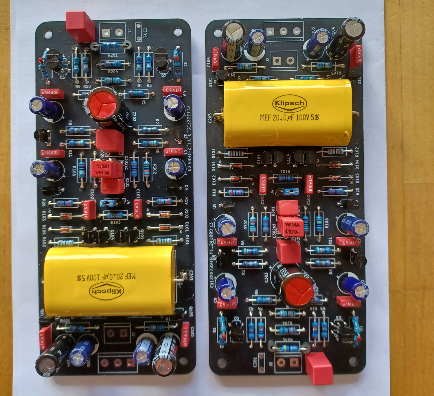

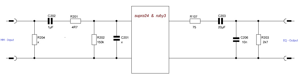

My equalizer has undergone another change, which I recommend as a general recommendation:
R107 = 75Ohm
C203 = 20µF MKP
R203 = 2700Ohm (|| 1Meg)
10nF in parallel (I have 11n)
This load is absolutely no problem for our diamond, at the same time we correct the legendary +1 error and create a kind of rudimentary subsonic filter. We halve C303 and set the DC blocker to 470µF. All in all, our total lower cut-off frequency is now around 3Hz. fh at around 200kHz.
Cx
So I haven't decided on C201 yet, it is still unequipped. Whether with or without, there was no change with the individual tones of the test LP ... My line capacity is already fully sufficient. In the end, I will solder in the same value that I use for the OREAD.
Before I get out the big cutlery, I prefer to listen to a few more LPs - because the Supra24 and Ruby3 pair work perfectly.

A few more quick facts
Input impedance(10kHz) = 44.55kOhm || 40.6pF
6.4pF of which falls on the chinch panel jack
For a MM system that wants to be loaded with 47kOhm, this means that we have to increase R204 (from 68kOhm) to 75kOhm or replace it. Conversely, we can now simply calculate r_inp ---> 931kOhm --> Core-Impedance || 34.2pF.
SNR (unweighted) > 75.5dB with connected MM system, connection cable, no shielding-case, with standard level (test record); i.e. A-weighted we are /will really good.
Overload reserve > 12dB in relation to the standard level another 5dB are added, i.e. clipping is completely unlikely (even though the core is only supplied with +/- 9Vdc).
Quick and unembellished in the evening -
tomorrow perhaps the real deviation from the RIAA characteristic curve.

About the complex input impedance
Of course, I automatically loaded and loaded the sensitive MM input of our switched-on preamplifier directly with a digital super duper (made the same mistake again? ), a test that anyone would perform unthinkingly these days. Why? Because it's convenient, simple and quick. |Zin| -> 44.55kOhm || 40.6pF is the readable value of an LCR bridge. Today we still call it a bridge synonymously, although the determination method has nothing, absolutely nothing to do with that of the classic analog measuring bridge - so be it.
However, we are not at all interested in this automatically generated Rp plus Cp value, because we do not know how our high-impedance input of the core reacts to the unknown level of the test signal, nor do we know the further determination procedure of the digital super duper (for now).

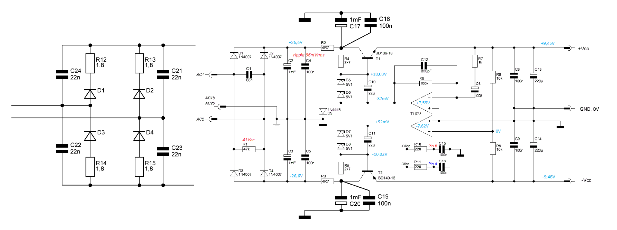

On the (possible) power supply design
If you look deep into the noise that can be measured at the output of the EQ (here Ruby), into the noise, you will find tiny (and really very narrow) switching pulses in the 100Hz rhythm ... How to make something like this visible is a topic outside the scope of this thread, I just want to point out that there is still something hidden.
Let's flux expand the simple and discrete symmetrical voltage regulator - and pray that we will no longer find any artifacts in the noise.
I'm going to take a break for a while and enjoy a few more records with a flawless supra24 plus ruby3. Perhaps we are now experiencing a veritable wave of replicas and interpretations of the two EQ concepts, their respective cores. That would be nice.
From my side:
everything is on GO.

Hi-five, hbtaudio! 🙂This load is absolutely no problem for our diamond, at the same time we correct the legendary +1 error and create a kind of rudimentary subsonic filter. We halve C303 and set the DC blocker to 470µF. All in all, our total lower cut-off frequency is now around 3Hz. fh at around 200kHz.
Ed
Thank you very much Ed,Hi-five, hbtaudio! 🙂
Ed
your praise makes me very happy. However, the compliment must also go to Morten, because Morten is responsible for the freely available layout, the PCB. Without Morten, there would be no new Supra approach (put into practice) for a long time yet.
Not to forget, Alugner was the first to bravely embark on the adventure.

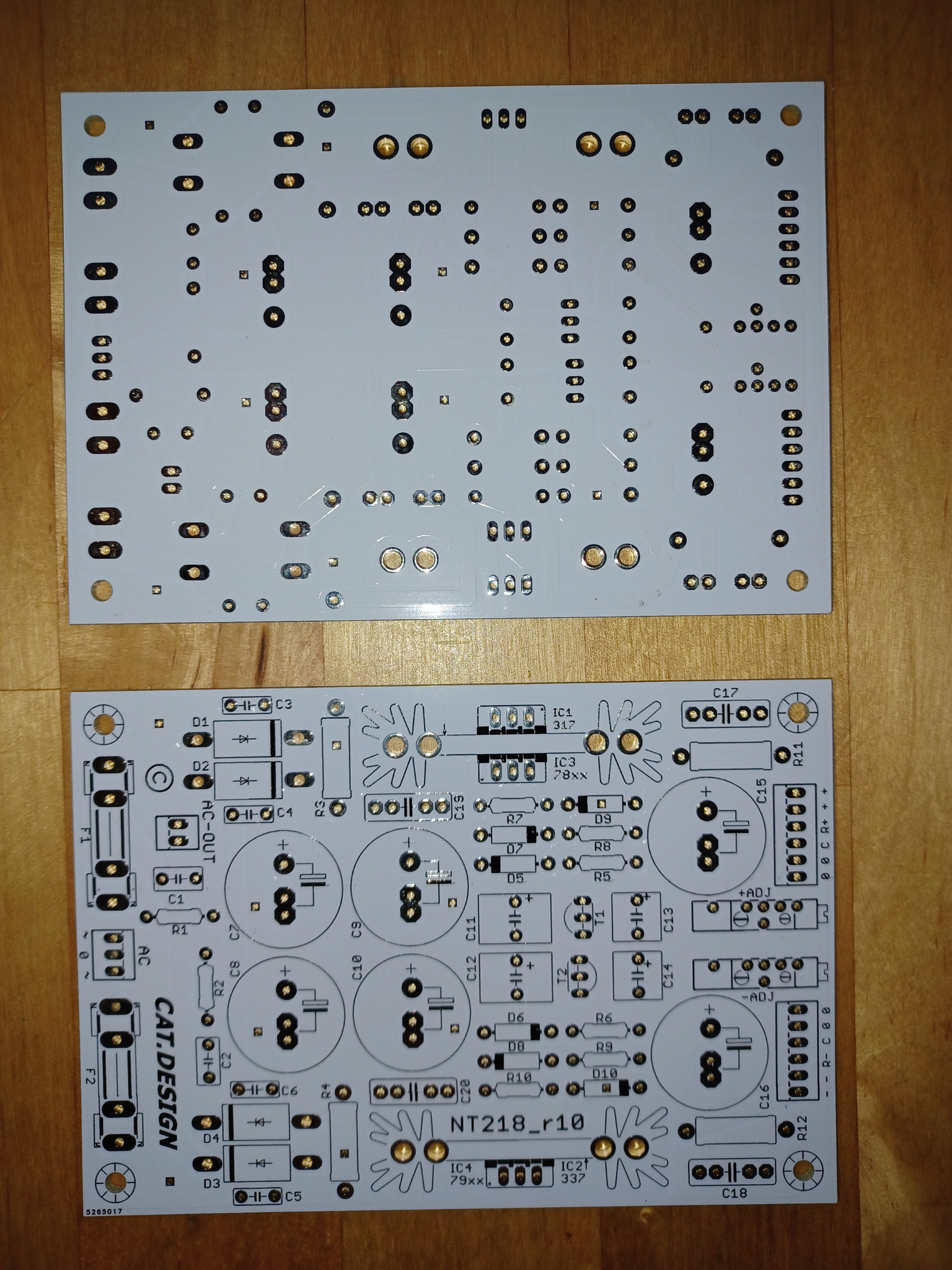

I'm undecided, what am I going to do with these two wonderful circuit boards? They are actually predestined to be used to implement an adjustable laboratory power supply, but they are far too good for a small RIAA EQ.
PCB and here
All that's missing is a housing and the package is complete.
For the sake of completeness, the following should be mentioned here:

A brief summary of the last checkpoints:
The simulation confirms the value of the resulting input capacitance, so we believe the automatic measurement.
R204 essentially determines the real part of our terminating impedance. 75kOhm now leads to the desired 47kOhm. It is best to make this X and the other X variable, i.e. interchangeable, perhaps using a small base /socket.
220nF < C202 < 2µ2
100pF > C201 > 0
R203 should not be smaller than 2k7, it depends on the size of the input resistance of our further processing amplifier, i.e. the downstream preamplifier represents a load for Ruby3. A value of 10kOhm || 470pF would not be atypical. Now we have to increase R207 to 3k9Ohm. The added C206 is also less than or equal to 10nF in total.
Jumper J4 always short 3 and 2, there is no option any more !
220nF < C202 < 2µ2
100pF > C201 > 0
