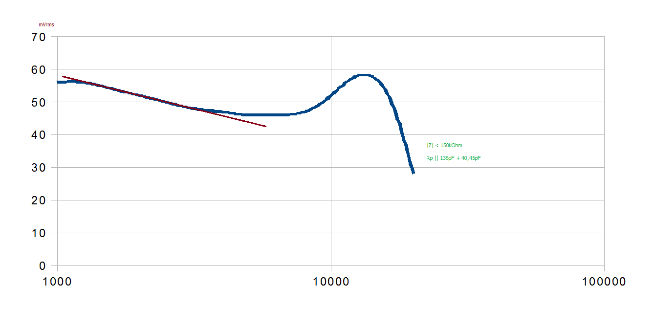

The right channel, outer flank of the groove!
The MM system is now terminated with <150kOhm. Whereby the results at the end with <47kOhm up to 1kHz are completely undisputed and can be considered reliable with the extremely small, relative deviations to RIAA-de emphase. The totally primitive setup for data recording is remarkable.
From 1k6Hz it gets worse, but why, that is the question here.
If you keep an eye on HiFi-DIN, everything is still perfectly in the green zone. Nevertheless, one can safely assume that fh shifts to the right and is now close to 19kHz. However, there is no longer a termination with a Q of less than or equal to 1. Nevertheless, I have corrected for 1st order just for fun.
The story continues ...

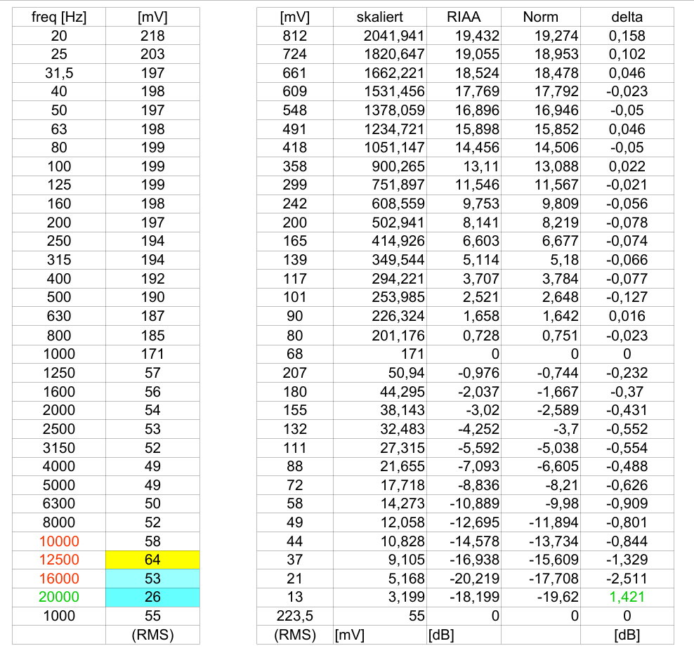

tbc

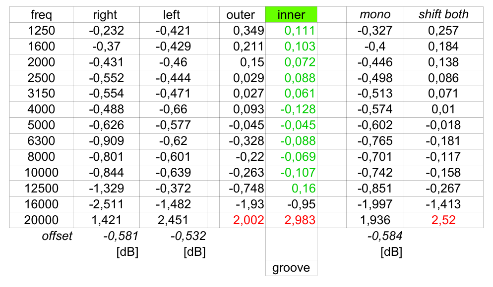

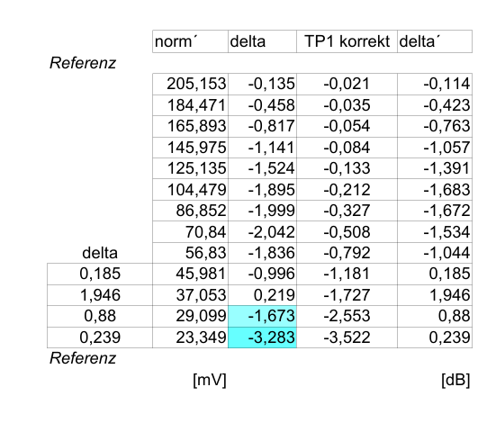

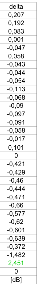

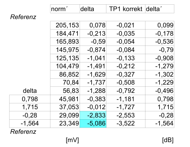

The left channel, inner flank of the groove!
The third, offset column represents the groove cut without EQ, i.e. linear. It should also be noted that the modulation represents a mono signal. This means that each edge contains the same information.
One should also consider the measurement requirements for the measuring range and the TrueRMS converter in a band from 20Hz to 20000Hz. Actually, if we leave the typical measuring range of 200mV, we need a measuring amplifier! The low voltage values should therefore be viewed with reservations - at the moment (almost only) the trend is important. The limitations of the vinyl, the groove, the falling radius and the constant circular speed of 33.333 rpm are completely ignored in the current test.
The sixth column of the table represents the correct transfer factor (related to the reference frequency of 1kHz), our target, the actual RIAA-EQ with the known time constants. Overwritten with “Norm”.
The appendage attempts to perform a very simple correction with the presumed upper cut-off frequency of the MM system (but as first order, i.e. Q<1).
Up to the 18th row (1kHz) we can read that the cut is extremely accurate to the equalization specification, extremely ... everything above that should be treated with a little caution, but we can still do a lot with the data points obtained.
tbc
tbc

And now the long overdue correction of the "second part of the measurement".
You can clearly see the precision with which the VMS80 machine - and Daniel Krieger (from SST Brüggemann GmbH) cut the test LP. However, above 12k5Hz a filter (or filter mechanism) of unknown type seems to be in effect.
This finding is completely independent of our MM system and correct or incorrect termination. Either a treble adjustment has been made or, more likely, it is a mechanical effect that is directly related to the speed of the stylus relative to the different radii; the maximum permissible groove deflection is known to decrease steadily from 1kHz (for the inner flank, the outer flank looks somewhat different).
We start at 140mm (RIAA on) and end at 120mm. Now we continue (RIAA off) to 95mm - approximately. Always in two columns, 20Hz to 1000Hz and 1000Hz to 20kHz, with levels adjusted for each. But the reference level (on average it should be approximately the same across the radius) increases on average with a smaller radius.
tbc
tbc

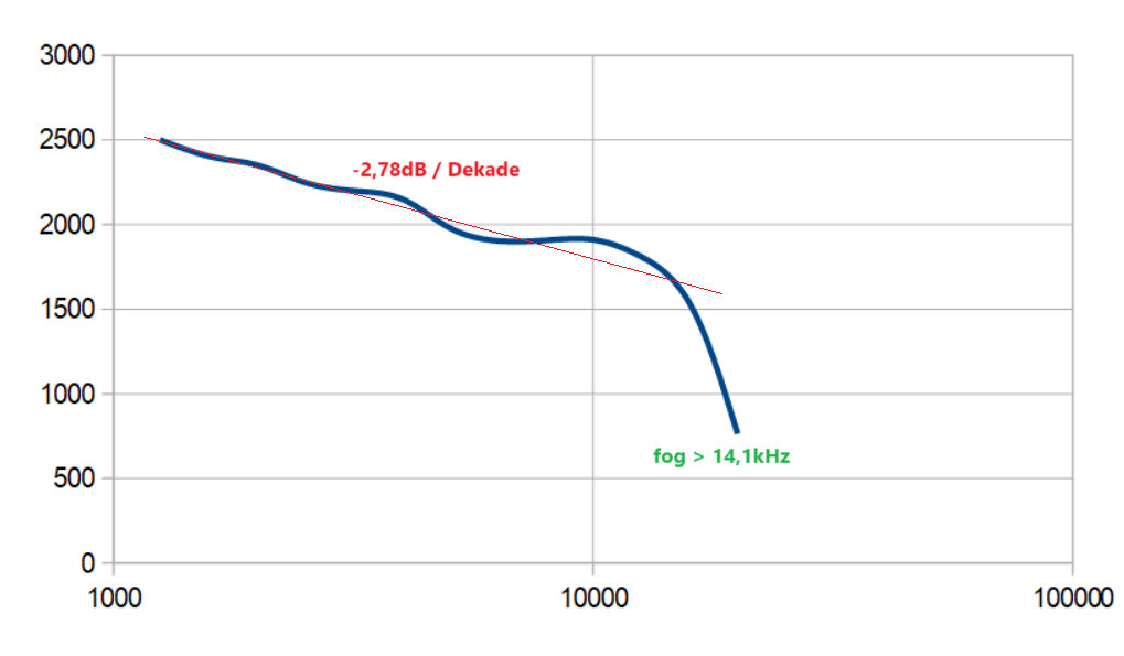

Back to the topic and let's take the second column from 1kHz to 20kHz single frequencies:
Related to the reference level at the beginning and end of the track, freq = 1kHz,
Have a good guess, the system is still the cheapest MM on the market, AT VM95C,
HBt.
- there is an approximate constant downward trend of -2.893dB/decade
- there is now an approximate falling tendency with -0.828dB/octave, followed by a low-pass behavior with a Q > 1.
HBt.

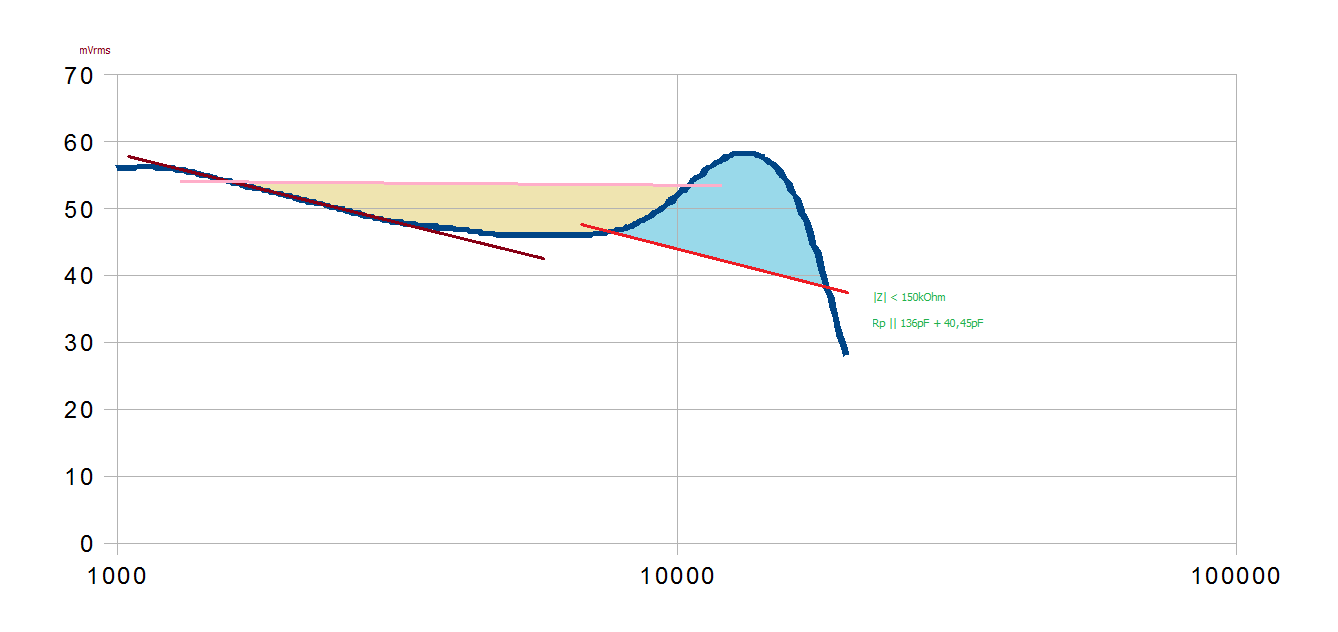

The big question is always:
can the light blue area (below the superelevation) fill up the "bathtub"?
And the answer is:
Yes.
Which MM system termination is the correct one?
Or to put it another way, how do I get more energy out of the top without it actually being there? Well, one have to stimulate another resonance circuit.
Correctly terminated, practically, every simple MM ends above 15kHz - and this already means a 1/sqrt(2) limit.
The storage medium limits us in the needle tone process by itself. A 15kHz sine wave requires a length of 34µm at the beginning of the large disk for one period and 12µm at the end - and that with groove speeds of 50.6cm/sec or 17.4cm/sec.
The speed of the moving diamond at 1kHz is approx. 8cm/sec in order to induce an original voltage according to DIN 45547, which corresponds to the full scale.
So it all depends on the instantaneous diameter and the permissible limiting deflection at a given frequency of a sinusoidal oscillation.
Incidentally, the ride of our diamond is pure madness in terms of force or better expressed as pressure on the groove flanks - with a groove width of approx. 40µm with perhaps rounding of the diamond of 15µm (an ellipse or other cuts is of course better) - you can happily assume 100bar as the pressure equivalent.
The mechanical challenges are very high if we want to break the 15 kHz barrier. We must not forget that there is a speed for / to voltage conversion.

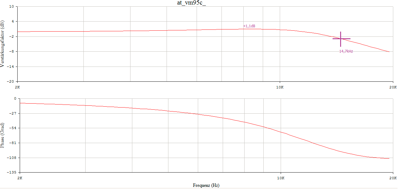

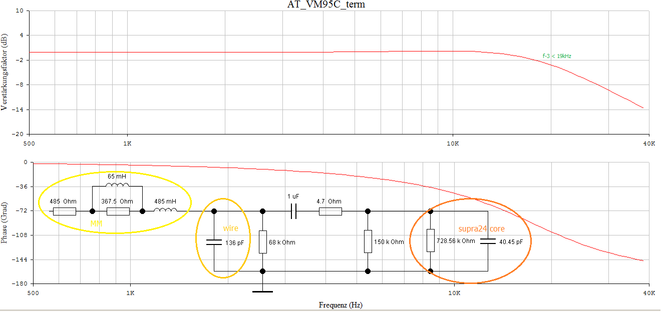

All guessing or good estimation is not enough for a reference point. At least a simple electrical series model of the magnetic pickup is needed.
A good half hour later,
the simplified (but completely adequate) model is available and confirms the previously estimated conclusion. Of course, this requires at least a few electrical specifications (measurements) and the manufacturer's data sheet.
From the manufacturer's technical data I take the upper frequency limit and read 20kHz, at the same time the rounding radius of the diamond with 15.24µm, glued on a fat aluminum cantilever ... So all in all, I'm sure you can't get more than 15kHz out of this, rather less.
tbc
tbc

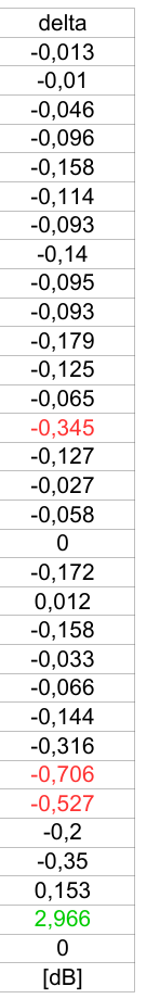

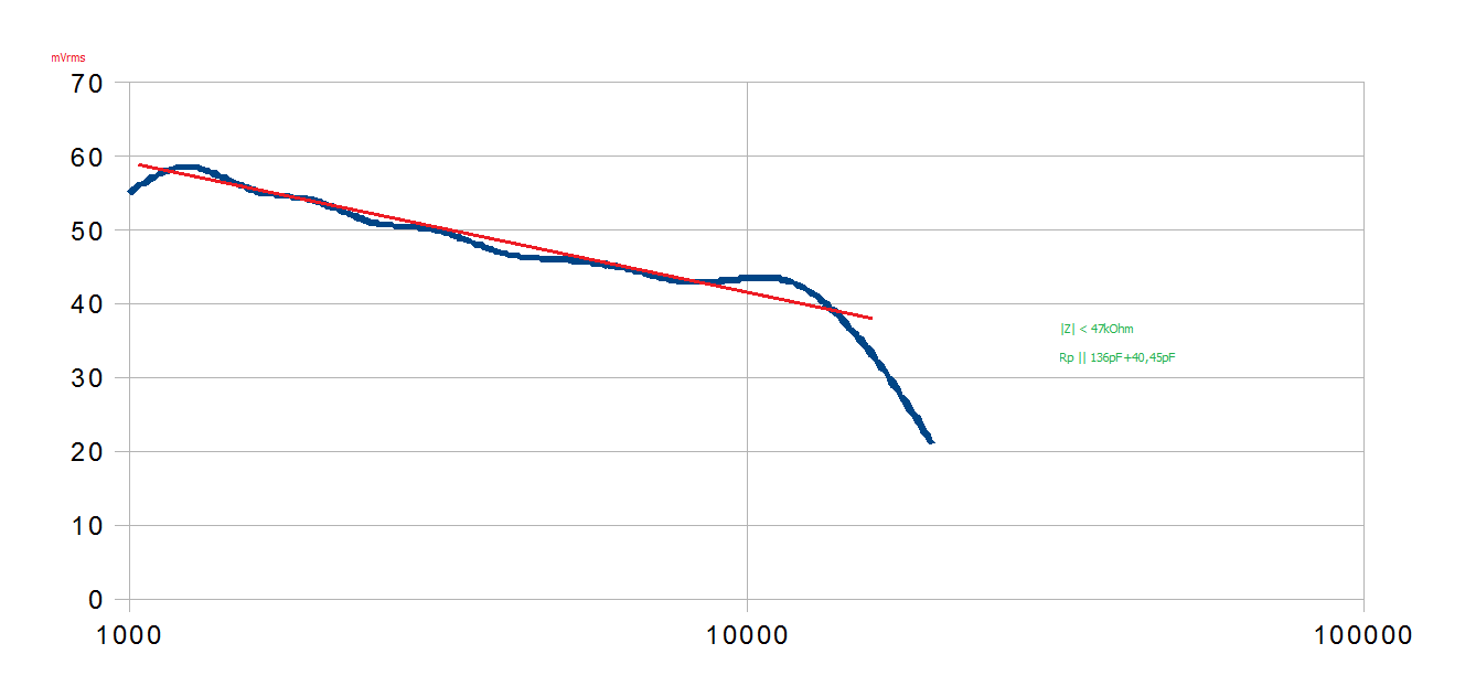

A final result, terminated as shown in post #195.
This time I used a measuring amplifier and an AC-DC converter and of course Supra24 plus Ruby3 (right channel). I'll spare us all the raw data set.
MM:
No words - what a load of crap. It's just as well that old men can't hear anything up there anyway. But we can still hear the important upper mids very well - even the insane distortions of these cheap systems.
MM:

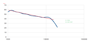

The abscissa is plotted logarithmically as usual, while I have plotted the ordinate linearly, also as usual.
I could submit this right away if it helps?
At the moment it's not about what we might hear - and the “we hear logarithmically” narrative is not entirely correct either, but it's another exciting topic (worth its own thread).
kindly,
HBt.
For the vertical axis should also a logarithmic or dB scale be used.
This will give a much better and more realistic impression of the cart’s behaviour.
Our auditory system doesn’t follow a linear level law but a logarithmic one.
Same for frequency.
kindly,
HBt.
