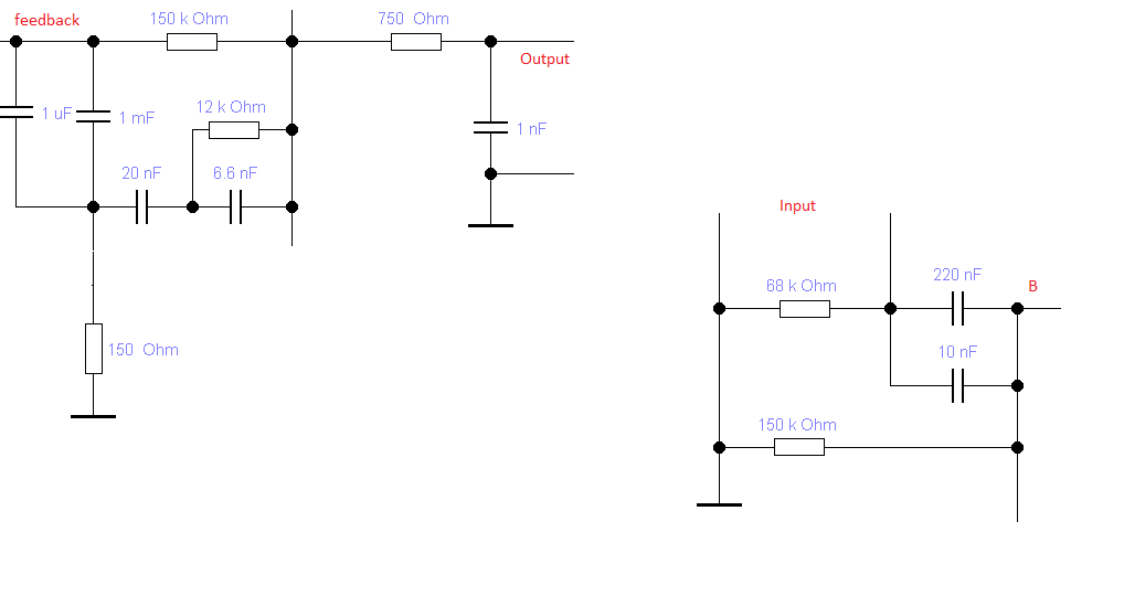

If we do not want to or cannot take the suspension and fixation (i.e. the damper) of the tongue (cantilever) for responsibility, then all that remains is the rounding of the tip, i.e. the huge, conical diamond. He will rise out of the groove base with higher frequencies - to be cut (scanned) and, above all, towards the center of the circular disk. It glides over the modulation, over the wave. The useful level drops and all kinds of distortion products are happy to exist.
Without an optimized needle cut and reduced mass (due to the acceleration), undistorted treble reproduction up to over 15kHz can be ruled out.
For this reason alone, the transducer is electrically terminated in accordance with the manufacturer's specifications. A comprehensive electrical equivalent circuit diagram (with an extended range of validity) will not be of real use with a conical needle (heavy and large).

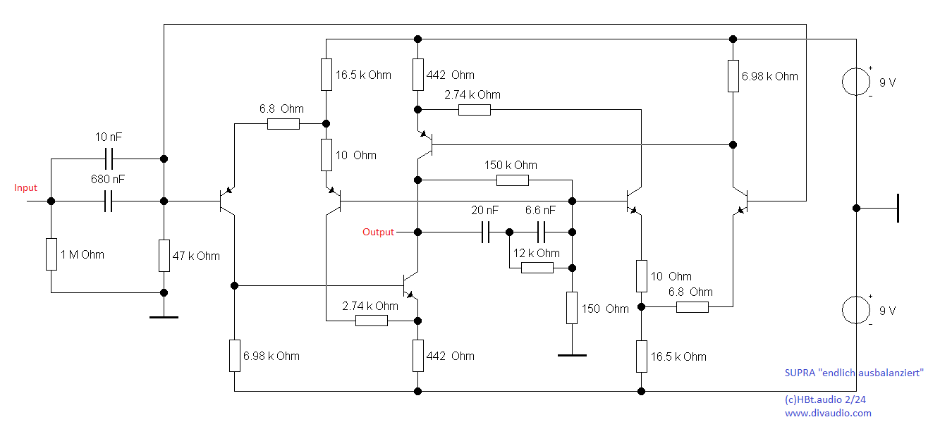

AT-VM95-C with Supra24 plus Ruby3
If I have not made any significant mistakes in the manipulation (correction = equalization) of the 96kHz / 24Bit data stream /set, the Ortofon sweep (known test LP), then the FFT confirms the frequency response above 1kHz already determined in the steady state case.
The dynamic picture is therefore almost identical. 14k7Hz < fh < 16k9Hz, i.e. a geometric mean somewhere around 15kHz. So the pickup meets the age-old hi-fi standard flawlessly, and our equalizer preamplifier does too - it's a class above. The spherical diamond tip in undamaged condition is also not an exclusion criterion. Its actual mass is also completely uncritical, it is a joke. It is the entire moving mass, consisting of the adhesive /glue, cantilever and permanent magnets, that is essential.
