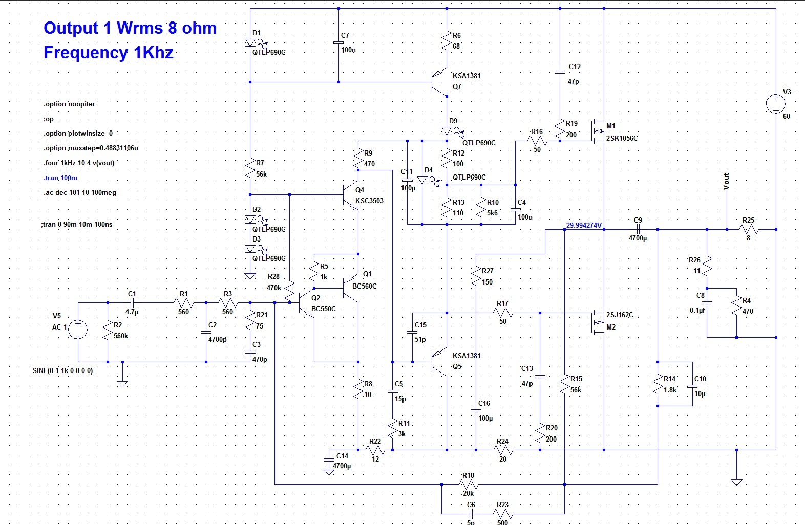

Thanks for the comments Mike.
I just looked again at the sim. Iq is 93mA, I could make it nearer 100mA by adjusting the bias chain a bit, but I suspect it will not make much difference.
WRT the layout: the distortion is very similar for both channels i.e. the one that is close to the smoothing caps (0.005%) is very similar to the distant channel @ 0.0051% (where the inductor is >6" from the caps).
LTSpice experts... am I interpreting the HD figures correctly?

Ok, 93mA should be fine. I noticed R12 and R13 in your asc file are set to 110R, so I had thought maybe you just set the 220R preset to the mid point, but if that's ok in both the simulation and the real amplifier then I don't have any good ideas what else to try. The simulation result appears to have the 2nd harmonic as the highest, so different to your measurement, which has 2nd down closer to my own results, so that's an additional puzzle.
Regards, Mike
I get a similar Total Harmonic Distortion result using your schematic and LTspice commands.
The error log also has the text .maxstep=0.48831106u Unknown control card.
I think that to have an effect it should be .options maxstep=0.48831106u or be included in the .tran command to set the maximum simulation step size.
I then get a slightly different Total Harmonic Distortion result.
The schematic on the Renardson Audio website has a 100uF connected between Q7 collector and Q5 emitter which I added to the simulated schematic.
I have increased the sine wave voltage source amplitude to 0.317 V to give about 4 V rms at the output which is the level used for the measurement results on the Renardson Audio website.
I also increased the Transient analysis time to 100 ms to allow the circuit to stabilise.
The results are then:-
Total Harmonic Distortion: 0.000185%(0.000910%). I don't understand why there are 2 results. Perhaps the first is calculated by summing the harmonics including the effect of phase so there is some cancellation giving a lower result and the second is just summing the amplitudes?
I also used the view FFT waveform arithemtic (right click in the waveform viewer window > View > FFT) on V(vout), number of data points, default, 262144, Use Extent of Simulation Data, Binomial smoothing, default, 3. Windowing Blackman-Harris.
The 2nd harmonic is about -125dB relative to the fundamantal.
I don't know how reliable the results are. The semiconductor models are only approximations, no account has been taken of power supply impedance or any other parasitics.
Thanks PChi.
I can replicate your results. The one that makes the real difference to the distortion is the use of 100 cycles.
I also amended R12 to 100 Ohms to get Iq = 100mA and R14 to 1K8 to get the "midpoint" at 30V.
I need to learn more about LTSPice to better understand the results!

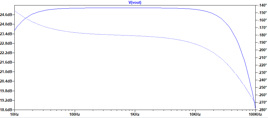

The sim is able to achieve the gain and THD spec'd by MR, but the phase is not linear from 1k-20kHz as shown on his website
I tried simulating MJR7-Mk3 to see if the gain/phase plots would be any different, but they're the same.

Hi famiac,
your phase plot looks about right, but you have used a linear scale for the phase and a log scale for frequency. If you used linear scales for both it should agree better with my own plot, being more or less linear, at least from 1kHz to 20kHz. Looking again at my own result the phase scale looks wrong, but I used AIM-Spice which does strange things with the phase, it only plots phase from -180 to +180 degrees, and anything more negative than minus 180 is shown as a positive phase. I need to correct the scale sometime.
Regards, Mike
Haha, what a silly thing to overlook. Thank you Mike.
I see now that by changing the input cap from 2.2u to 47uF i can get a group delay between 3.4-3.2 microseconds from 1kHz to 20kHz.
With a 10uF input cap, the group delay is still between 3.6 and 3.2us
