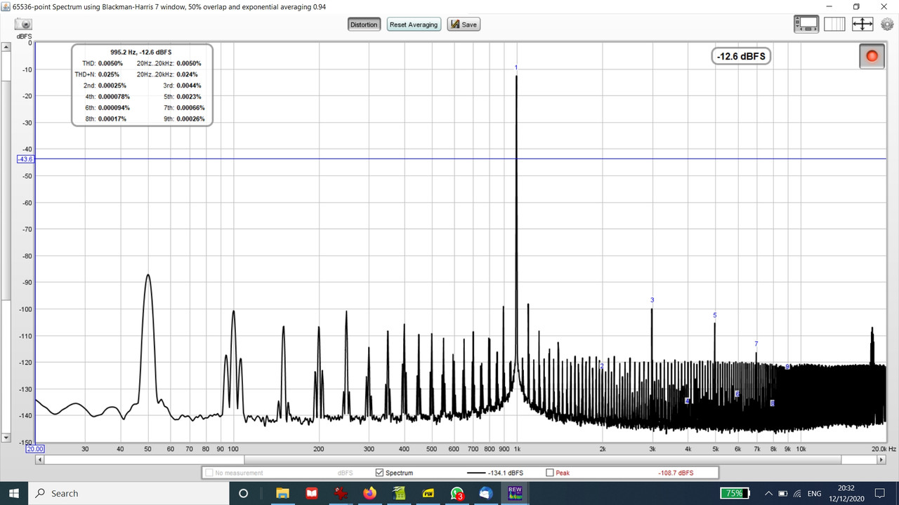

I recently measured the distortion of this amp and it seems like I am not getting anything like the performance that I should be:
I used a very similar layout to the original and used 2SC2240BL & 2SA1085E as the input CFP. The other devices are exactly as per the latest schematic.
The other thing that is strange is that I have never seem the 90 and 110Hz "sidebands" on the 100Hz signal before.
Any ideas what is going on here?

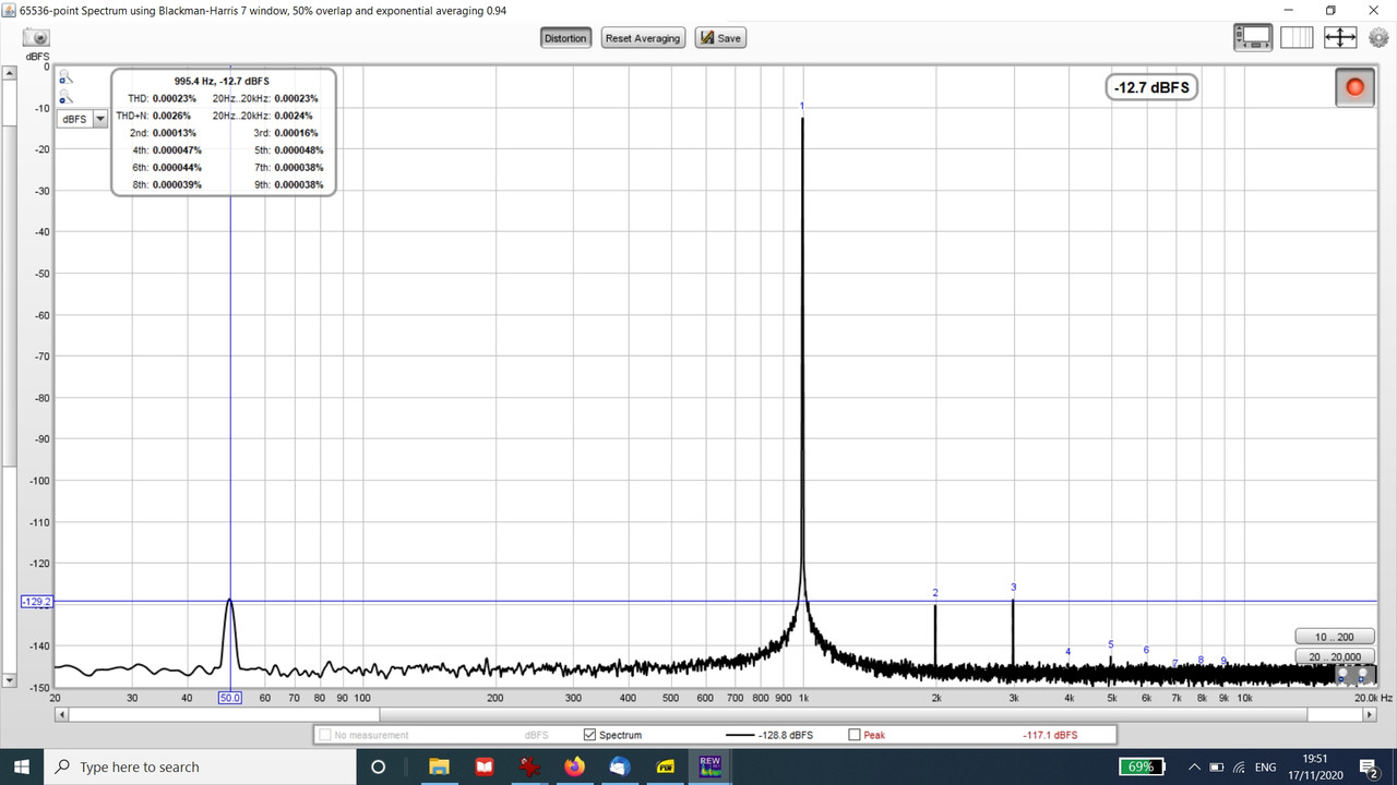

Measurement is by battery powered 1KHz sig gen and ADC is Focusrite 2i2. Baseline performance is:

That doesn't look good. You only specify the output level as -12 dBFS, I assume that is just relative to 'full scale' so I'm not sure what level this is in volts. My first thought is that this looks a lot like being close to clipping. The increase in odd harmonics supports that, the 2nd harmonic is still low. Near clipping the supply breakthrough will also rise so the 100Hz and higher components are to be expected. Those sidebands at +/- 10Hz are less easy to explain, I would guess there is only conditional stability at 10Hz because of the way the output capacitor has been included in the feedback loop, and I actually found a small negative resistance output impedance around 10Hz, so I guess that is being triggered by a fall in loop gain near clipping, but at -120dB that should be nothing to worry about. Did you try reducing signal level a little to see if there was an improvement? Looking at the output on an oscilloscope as the signal level is turned up could be more informative than the frequency spectrum. If this is also happening well below clipping then I have no good idea what could then be the cause.

Sorry I should have mentioned that the spectrum was taken at 2.9V RMS into a 10R load (not too far from your tests at 4V).
The reason for the -12.6dB is that this seems to be the sweetspot for noise versus distortion for the 2i2.
However I have realised that my results could be flawed because the sig gen has a 10K pot on the output :eek:. So in the worst case the amp is being fed by 5K resistance which will tend to reduce the gain of the amp (inverting mode!).
I think it's more likely to have been fed by <1K ohms - I would need to measure the pot at its test position.
Anyway, I need to buffer the sig gen to do the test properly.

Thanks for the clarification, at 2.9V the result is far from what I would expect. I assume you have a stereo pair, is it the same on both channels? The signal source impedance shouldn't be a big problem apart from increased interference pickup, but that wouldn't explain the result. Other possibilities include earth loop problems, but again that doesn't entirely explain the spectrum. The increased odd harmonics and 10Hz sidebands only seem to match the onset of clipping, which is impossible at 2.9V, unless the supply voltage is very low. I suggest to check the supply voltage, that the mosfet sources are close to half the supply voltage, and that the quiescent current is at least 100mA. If you don't have an oscilloscope to check for instability maybe try increasing the 100p capacitor to 220p and the 1R5 resistor to 2R2 or 3R3 to see if there is any change. That 2SA1085E could be a problem, I got a few fakes with low current gain the last time I bought some, that could affect stability. The BC560C is also discontinued now, but at least is less likely to be faked. My own tests and those of other constructors have never shown a similar problem, so this is something new and unexpected.

Supply voltage is 64V. Output is near the middle, I cannot remember exactly but I set in on the 'scope for symmetrical clipping.
I had a quick measure of the pot resistance, I estimate the source impedance to be ~1K Ohms.
The 2SA1085Es were bought from Maplin about 20 years ago (they were specced in the famous Maplin mosfet amp). Measured gain was high, >500 IIRC.
The 2SC2240s were from Toshiba sample stock - I used to work for Tosh.
Both channels have very similar measurements.
I will check again for instability, but didn't find anything suspicious when I originally built the amp a couple of years ago.

I get a simulated THD of 0.0047% which tallys well with my measured THD of 0.005%.
Both are an order of magnitude away from the results MJR and Forr achieved:
MJR7-Mk5 Test Results
3rd HD is 0.0044% measured by me and <0.0001% in Mike's measurements.
I hope my pal will fire up his AP set soon to shed a bit more light on this quandary.

The feedback loop gain should be around 80dB at the 3kHz frequency of the 3rd harmonic, and the open-loop distortion should be around 1%, giving expected closed-loop distortion 0.0001%. Your 0.005% would need either open-loop distortion around 50% or loop gain far under 80dB. I looked at your asc file with a text editor and checked you have the right values for the 1R5 resistor and 100p capacitor, which primarily determine the loop gain, so that looks ok. The only other question is how you set up the 100mA quiescent current in the simulation, that is the only obvious problem I can think of to explain the high distortion. The way I used the 220R preset to set the current could make simulation a little difficult, it needs two resistors adding up to 220R, and adjusting their ratio to set the mosfet currents. Low current will cause rossover distortion which can produce primarily odd harmonics, so that is a possibility.
Also, I have just remembered our earlier discussion, and looking back to post no.39 I said:
'The only big difference to my own layout is including the supply capacitors on the board. There are highly distorted currents flowing through those capacitors and they are close to one of the output inductors which could pick up the magnetic field generated by those currents.' Are you still using the same layout? If so that could be relevant to the high supply breakthrough, and those capacitor currents will include harmonics of the test signal, so there will be some added harmonic distortion. The layout diagram in the previous post no.38 is unavailable now. Other loops could be involved, not just the inductors. I would advise keeping the main supply capacitors further away from the amplifier board, with just a smaller value supply capacitor on the board. I doubt whether this can explain the whole problem, so again double checking the 100mA quiescent current is my advice.
