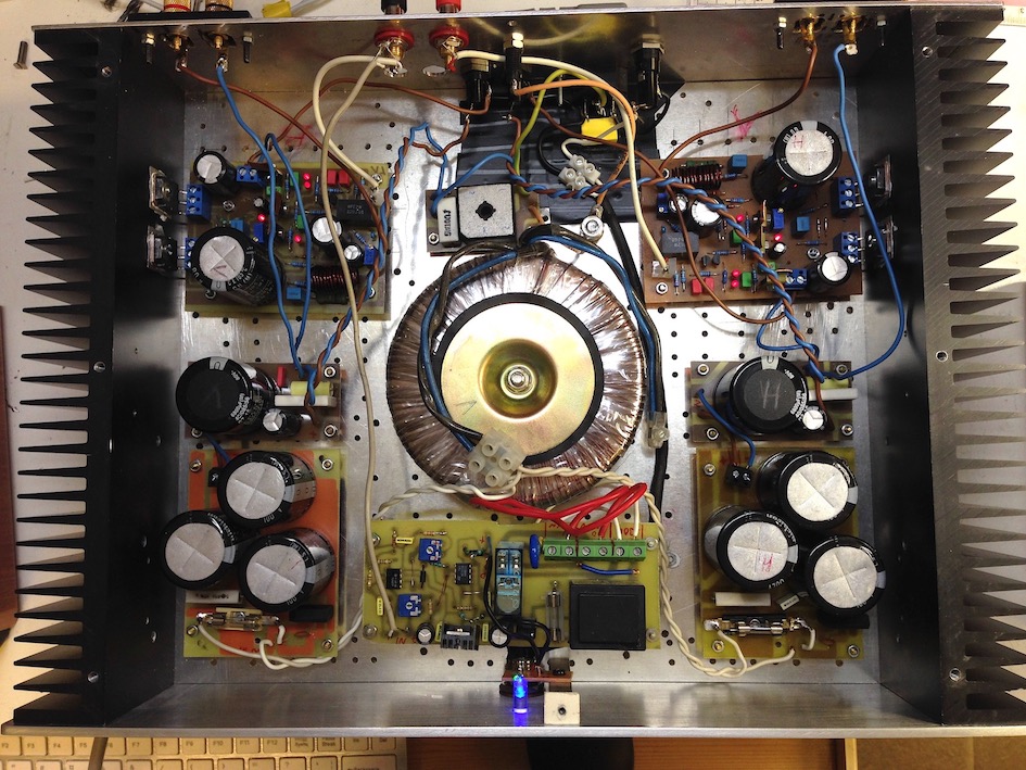

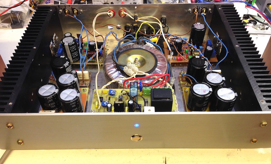

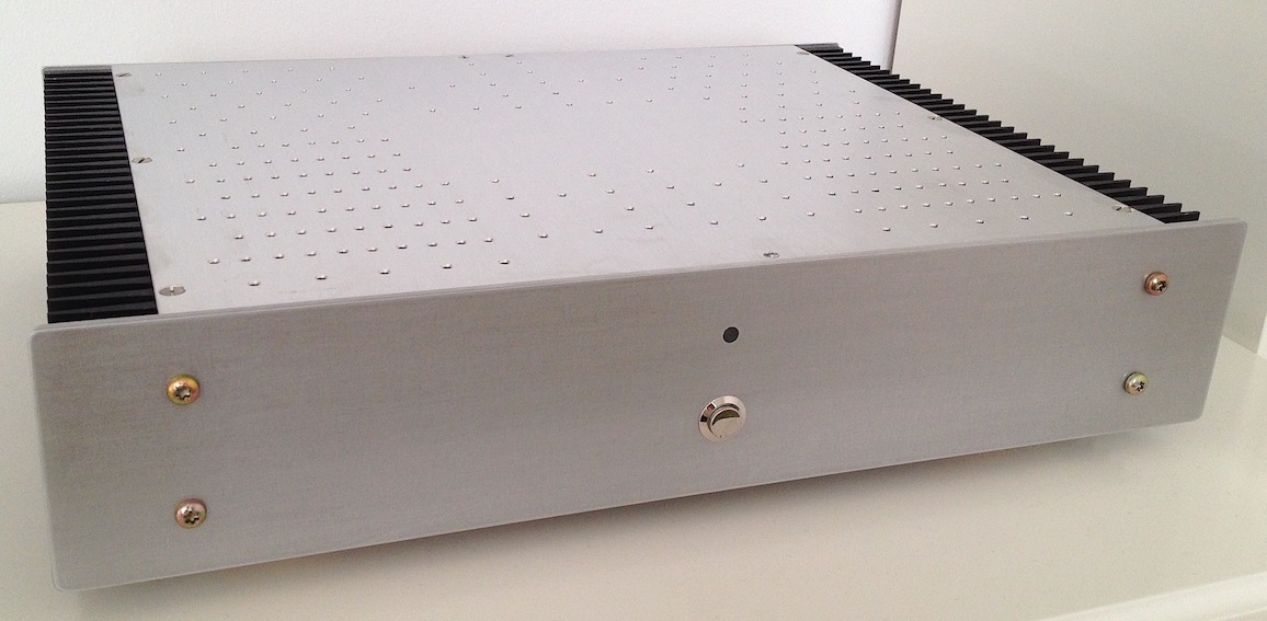

Hi
Finaly I finished the power amplifier. It sound realy good. I'm impressed with the sound quality.
Here is some picures off the amplifier and case. It's a 300VA transformer. Supply voltage is 66.6V and the quiescent current is set to 150 mA.

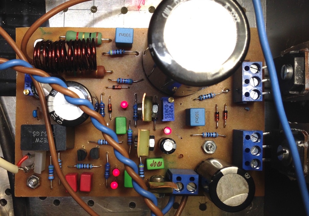

Board

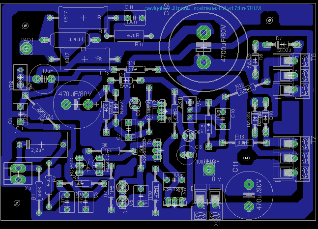

Hi
Off course you kan get a pdf. I like this amplifier very much so I am happy if more people builds this small wellsounding amplifier made by Mike Renardson.
Read his komments how you adjust the amplifier. Here is the link Audio Amplifier Design
If someone are interested in the Eagle-file I can post that too.
Livio

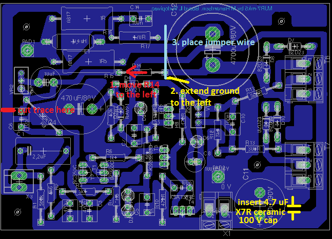

Hi Livius,
I like your board layout in that it is very compact so perhaps not prone to RF pickup. I'm tempted to build the circuit according to your layout, as soon as I made sure it's not prone to HF instability. Though I have 2 suggestions, but comment on that if I'm wrong.
1. The grounding can be made better by a simple modification. In the present layout the return ground current of the output compensation network R17, C14 flows through the input ground. This is generally to be avoided. I would cut the trace at the position shown in the atached image, and insert a jumper wire from a different grounding point.
2. I read about that the supply rail decoupling can be made better in the 100kHz...1MHz range by inserting a 4.7uF X7R ceramic cap parallel to the electrolitic, see atached image, and https://www.neurochrome.com/taming-the-lm3886-chip-amplifier/supply-decoupling/. According to this article the usual 100nF does virtually nothing.
I would try to make these modifications if you provide the Eagle files (although I have to learn using Eagle...).
Another question: did you test the HF stability of your layout? Under capacitive load as well? E.g. 8 Ohm parallel 100nF on output? If you don't have an oscilloscope, you can touch resistor R16 (1 Ohm), if it's hot, then there is HF oscillation. Don't use a real speaker for this test, because the tweeter may be damaged if there is HF oscillation within the amp. Layout can be a contributor to insability even if the theoretical design is mostly OK.
regards
István

Hi István
Yes I know. My board is not perfect. 🙁
I have built a amplifier whith this layout and it´s running good.
First I tested a board only whit a resistor load and later whit a speaker. R16 was not hot so I think it´s not oscillating.
I´m interested to see your board when you made the changes. There are always something new to learn.
The attached zip file contains the .brd and .sch files. Contact me if the files not working.
Regards
Livio
I was intrigued by the clever and individual design approach of this amp, so I built one. I used a layout very similar to the MR one. Sadly its sound was not quite as good as I expected 🙁
For a similar design but with sound that's more to my taste, I would recommend having a look at the Ion/Nytech circuit.
Hi Livius and all,
Attached are the Eagle files with some minor corrections.
There was an error in the schematic: pins 1 and 3 of VR1 were shorted. Fortunately this error was not replicated in the board layout. I corrected this in the sch. and also mirrored VR1 vertically in the layout, it should now increase the bias current CW (not CCW as it was).
As Mike Renardson suggested, I also included a diode serial to the D6 LED, just in case the VGS's of the MOSFETs are higher than usual.
Also included is a 4.7uF MLCC capacitor between VCC and GND (it's not important, can be omitted).
Grounding was made a bit different, now the grouding current of the output filter doesn't flow through the input ground point.
I hope I didn't make any new error and it works fine.
István
