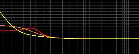

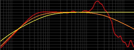

I have to admit that I do not fully understand group delay, but is strongly connected to mass and magnet strenght.
On the other hand Group Delay is just one of the speed factors. It doesn't tell everything. There are also moving mass, fs, size, suspension stiffness, power etc.
I'm not saying that Alpha is too slow. But please don't tell me that it is an ultimate high-end and that you cannot imagine it being better in terms of speed and accuracy. It is faster than most bass reflex systems anyway.
I bet that most of listeners wouldn't like too quick bass in their systems. It is not suitable for modern music at all. Only acoustic music sounds right, but is my subjective opinion.
I'm not an ezpert. I just want you guys to consider that there are some issues about high QTS drivers that we should be aware of.
Now just compare these divers:
Alpha 15a (red)
Selenium 15PW3 (orange)
Altec 416-8a (yellow)
First graph are charactreistics in 99999 liter closed box (smth like infinite baffle)
Second are Group Delay graphs.

Fakamada,
if the Selenium and the Altec were EQed to the same response curve as the Alpha, their group delay curves would be identical to the Alpha's too. That can be clearly derived from your comparison. If your comparison is not based on identical prerequsites, it does not qualify as a comparison IMHO. It is roughly like peterbrorsson is saying:
Hmm, I could be wrong but... If a speaker does not go low, as under 60Hz, it will sound faster than a speaker that goes lower.
Fakamada,
Well, it could be right. Does anyone know any better simulation program than mine that would show us Group Delay dependently of driven power ?
That could show us how equalisation would influences Group Delay.

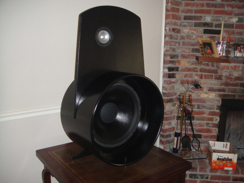

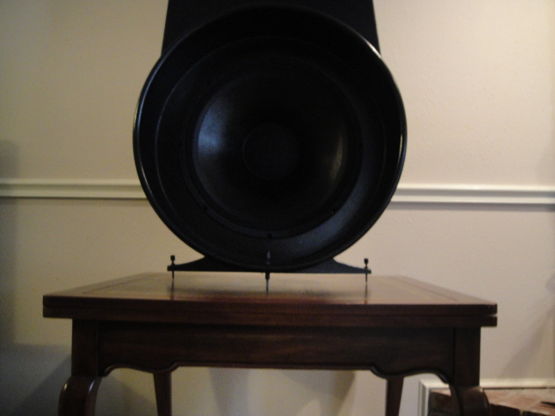

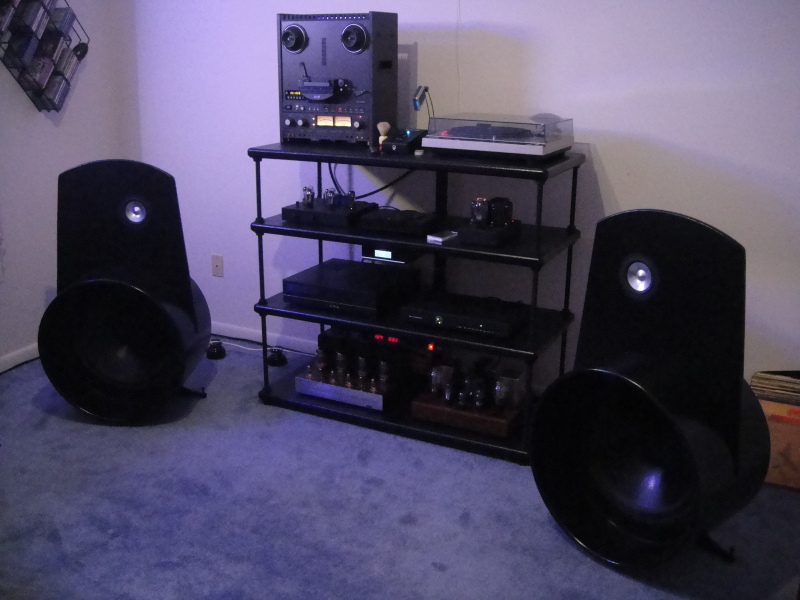

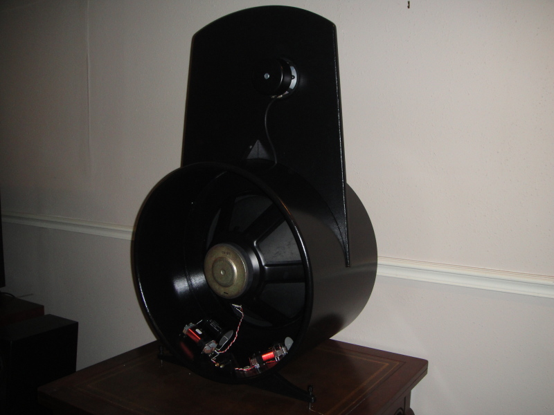

Very Nice!! The look great, how do they sound?
Love it when a plans comes together, thanks Martin and Aegnus.

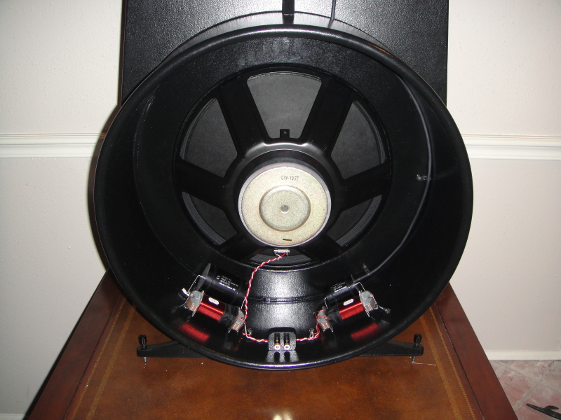

Brad,
Please send me those pictures so I can add them to the gallery. That has to be one of the wildest builds of this speaker design on the Internet. Are you happy with the performance?
Brad,
Whoa!!! that means alllot, HAPPY 🙂 is an understatement. I have to say the Jordan's are as smooth as they report. They handle allot of rock from the loudness wars time like I never heard. The hot S as we call it has tamed allot of recordings.
Comparing them to the FE87e and 15a OB I would say they are smoother with more detail and extend a little lower on the bottom.
I am driving them with the HK CII and have to say if they had any more bottom end it would be to much, I may try them in triode soon. I will send some pics in a bit.
Thanks,
Brad
Hi Brad,
Got the pictures, thanks. I will try to add them to the gallery this week.
