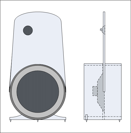

When Aegnus posted about using a tube instead of a box in post 243 I had similiar thoughts in the past.
http://www.diyaudio.com/forums/full...ood-gw-1858-woofer-h-frame-5.html#post1757261
After further discussion with Aegnus he drew up a couple of ideas that can be seen in post 265 -272.
http://www.diyaudio.com/forums/full...ood-gw-1858-woofer-h-frame-6.html#post1762602

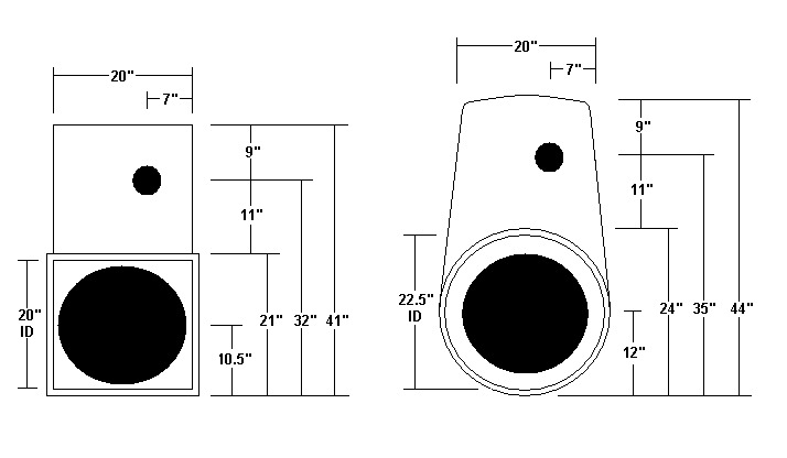

The internal volume of a 20" x 20" x16" cube is 107.77 liters and a 22.5" x 16" tube is 104.25 liters. The exact tube equilvilant would be 22.877 id x 16". I found a piece of 24" schedule 40 PVC that has an OD of 24" and an average ID of 22.544".
http://www.usplastic.com/pdfdatafiles/drawings/pipespecs.pdf
Now that I have all the parts to build except the PVC which is on it way I put together a drawing. With the drawing I now see I should have should have thougt of this more before acquiring a piece of pipe.
Note in the drawing the center of the Goldwood would be 1.5" above Martin's design on the left. I don't see a problem there but now with the 24" tube the Jordan may be facing some problems by being higher up and not having a flat surface at the bottom.
I normally don't like to vere from speaker plans but thought the tube was good idea outside the norm.
Martin in you article you made original measurements with the Jordan and Goldwood independently and merged the graphs since you software wouldn't allow a flat panel and h frame to work together. Should I revert back to original plans or do you think I can make this work OK without dramatic changes in measurements from the original?

Hey, Brad - glad to hear you're working on this one; I'm still interested but still about 7 projects behind. 🙁
I hope Martin sees and answers your question, since that would be definitive. But in the interim, I can't see that presenting a rounded surface at the top of the h-frame would make any real difference to Jordan; and I don't see why you couldn't set the Jordan at the original height as well - it would still be about the same _average_ distance above the h-frame baffle as in the original design.
I'd say it's worth a try (of course I'd say that, it's not me doing the work 😀), since you already have the tube all you can lose is the piece of plywood for the baffle...
Anyway, please keep us posted. Who knows, maybe you'll goad me into action.
At the crossover frequency, about 200 Hz, the wavelength of sound is approximately 67.5 inches. So my guess is that a few inches of difference in the design dimensions will not be an issue.
