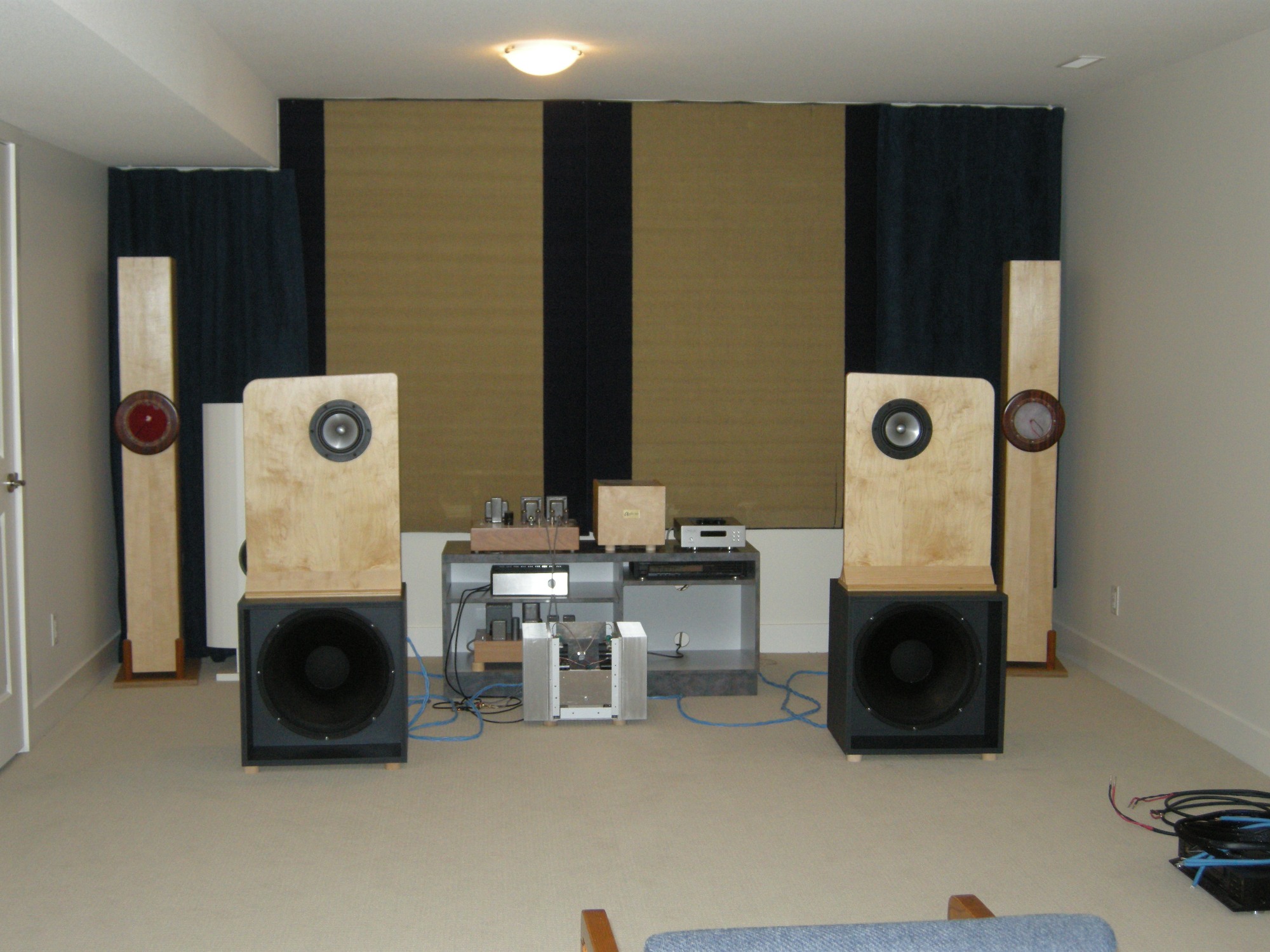

Thanks Guys, I will probably drop the overall height a few inches. Hoping over the next 30 days to get it built and post some pics.
Brad
Brad
What type of wood did you use for the top of your baffles? The one where the alpairs are mounted.
I've my baffle 6" higher for my Alpair 12. It works pretty good for me so far, and I've found the images are taller.
Very nice looking build. 😉
Looks like you are using the drivers from the bibs? If so how would you compare the sound of the two speakers, bass, mids, highs, and presentation?

If you ask me and I'd say I like OB more than any other box speakers that I've built.

I like building and experiencing, and learning. I also seek more refinement and better musical enjoyment. I also like simple things, and often find that it is way too easy to over engineer something.
When I made my first open baffle I was pleasantly surprised, but never was happy with the bass. This thread and Martin's other work had rekindled that interest.

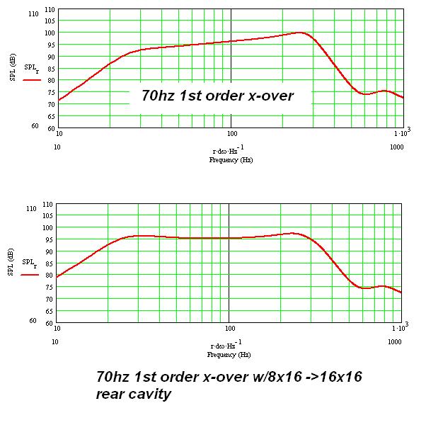

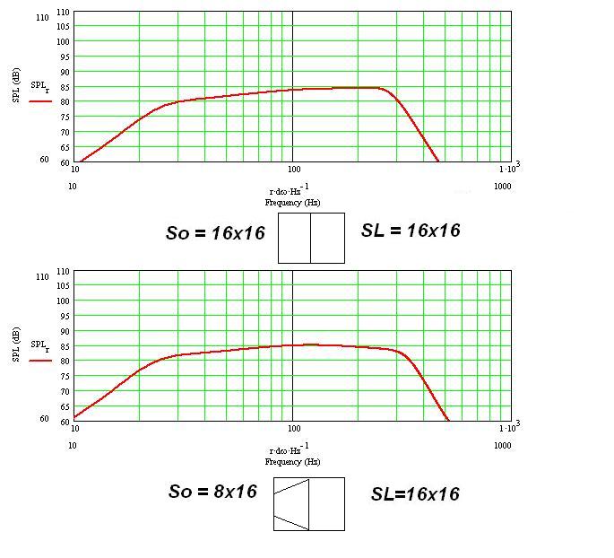

Has anyone tried changing the So/SL geometry of the H-Frame?
Using Martin's Model it looks like reducing the size of the rear opening can reduce the rising response.
Adding “wedges” to the driver side to reduce the final opening to 8x16 may be an easy option. Or does the expansion from So to SL need to be linear?

I'm having trouble replicating your results. I assume because you used a So and SL of 16x16 and 8x16 you're looking at the Alpha 15A in an H-frame and not the Goldwood GW-1858. If so did you change the Terminus Geometry Input so that Wmth = 8 in instead of 16? I'm using the H_Frame_Corner_7_03_09 worksheet.

I'm using the same sheet.

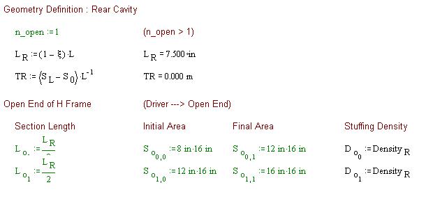

Martin indicated that the So-Sl transition is linear so my earlier models are junk. I *think* i've figured out how to model the wedges in the rear cavity. If I figure this out it may be possible to install either solid wedges or maybe even hinged flaps for tuning.
So n_open can be 1, but that still means two section lines....
I'm also using the goldwood 215/8/40.

Not sure how I'm make the wedge yet...
