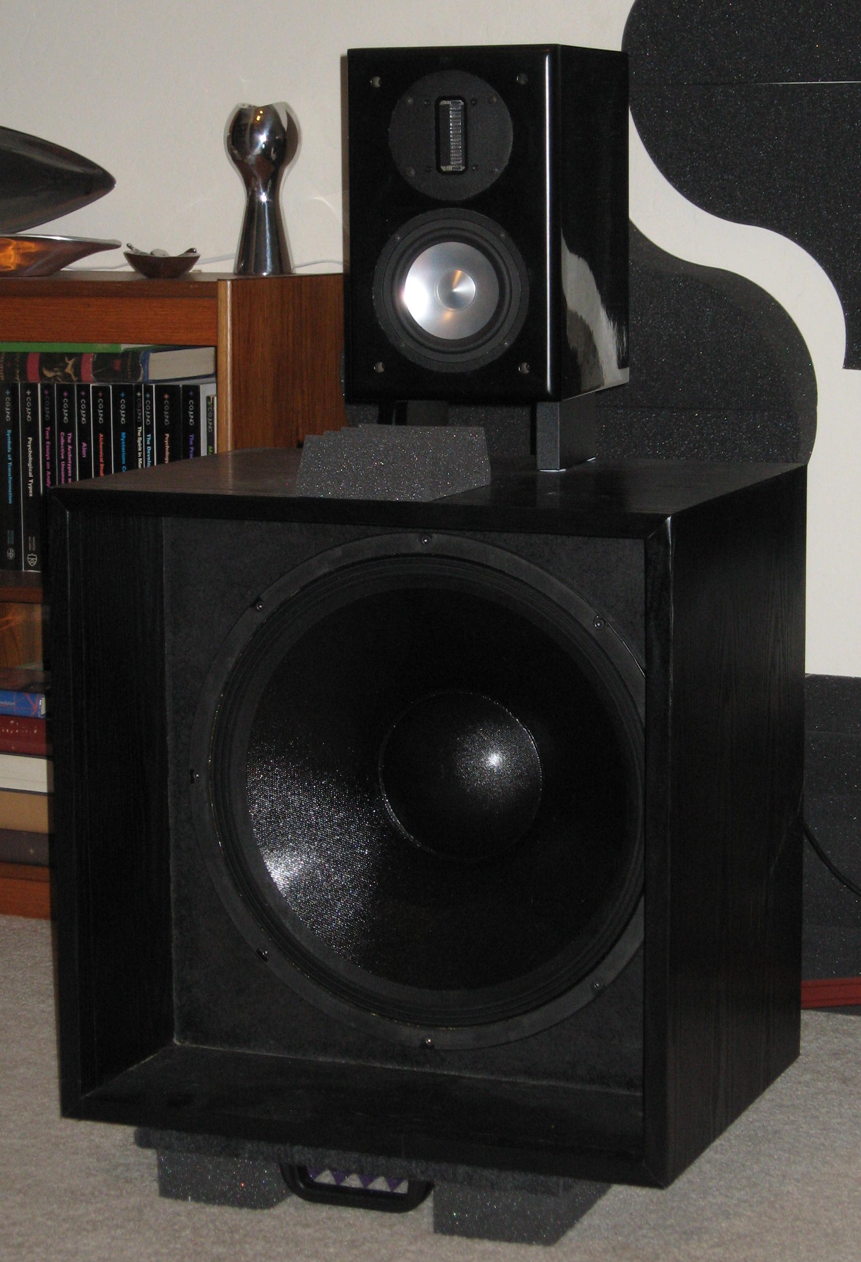

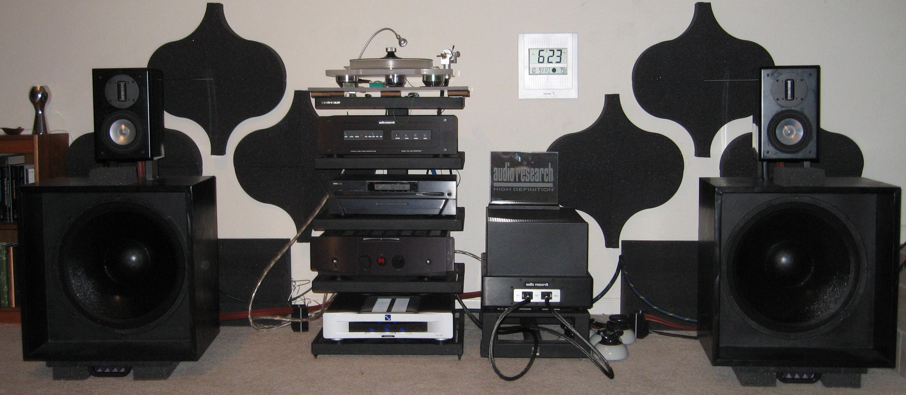

I have been running the Goldwoods with the Jim Griffin Mini-monitors for a few months now. I had some interaction on the high pass filter and switched to 98 uf capacitor only.
The bass still seems to be a couple of dB too high for many recordings, but most of the time, it is the best coverage of the full frequency range I have found for the price. The soundstage is pinpoint, after very careful positioning. I don't think I could do as well with commercial for a lot more than I put in to these. I have Vandersteen 3A sigs with subs on my home theater, and pair of Maggies in the corner now that I have this setup.
I definitely recommend the setup.

Craig, your systems look delish! I will build something similar in scale using the H-frames and sitting monitors on top like you have. I see this as yet another way to make amazing music... along with very simple BIBs (using just one driver!) and OB's that i am building and tweaking now (betsy/boomers... also using Alpha 15's). Building speakers has taught me there are so many different ways to build a high quality, high end set of speakers. They may all sound different but they can all take you places you can't go with moderately priced commercial gear.

I can speak of the Alpha 15s only (at the moment)... and realize others love the Goldwoods... but if these H-frames are anywhere near in performance all i can say is you will be spoiled for rich, full, effortless, dynamic bass.

Thanks for the comments. Actually, I am building an Alpha 15 setup right now to see if the slightly less bass they should produce is a better match. I found I could tune somewhat by toeing in the monitors a bit more than the H-frames. The Auralex Gammas the H-frames are sitting on also helped in detail. (No W, so no WAF to worry about.) The other piece I found was that lowering the monitor helped the focus in the lower mids. Might need to do some more simulation here, mostly just worked by ear. Also, just got a pair of Alpair 7's to try on the top side.
The detail in the bass, where you hear every note where it should be with no boominess, and the staging way down is just stunning. The new K2 CD of We Get Requests by Oscar Peterson is great. The bass, drums and piano all stay right where they belong and every note from Ray Brown is detailed and musical.
