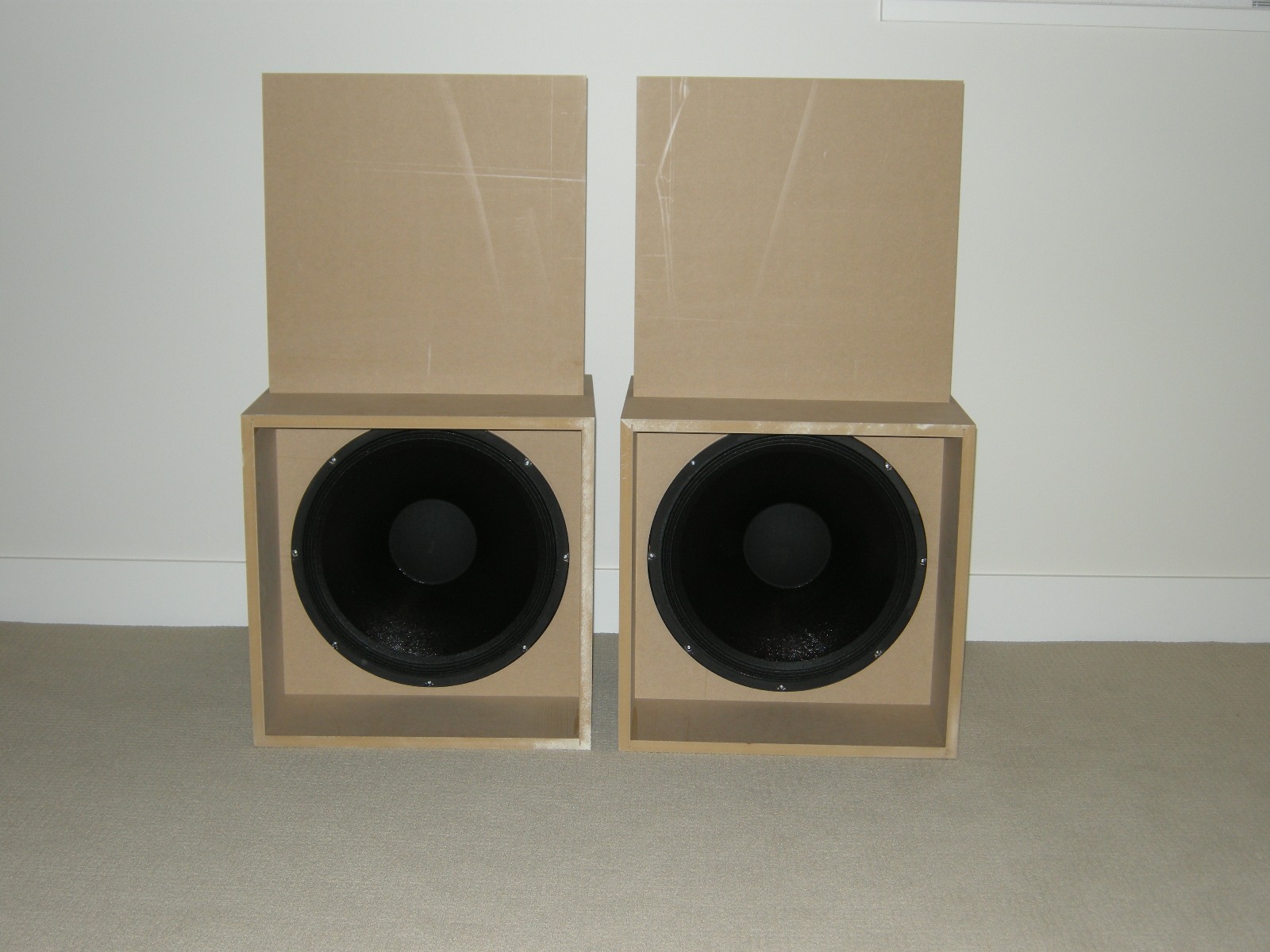

I believe that either the Alpair 10, Alpair 6, or the CHR-70 would all work well with the Goldwood H frame. I have not done the detailed design work so I do not know what baffle size, driver position, or crossover would be optimal. I think that there is an advantage to keeping the baffle size the same and offsetting the driver slightly in the baffle, that geometry is what dictated the crossover frequency and order so that the combined SPL respnse was flat on axis. If you change those variables you might need to rethink the crossover.

That would be a safe starting point in my opinion. You could also start smaller and add peices to the sides to make it bigger if small did not work. Building a new baffle to stand on top of an H frame is easy, quick, and cheap.

The OB with the Jordan or Fostex driver is 20" x 20" and sits on top of the H frame. It is not attached so it can me moved forward and back and tilted towards the listener. The driver hole center is 7" from the insde edge and 9" from the top edge. The description of the OB dimansions can be found on page 7 of the original article under Project 8.
