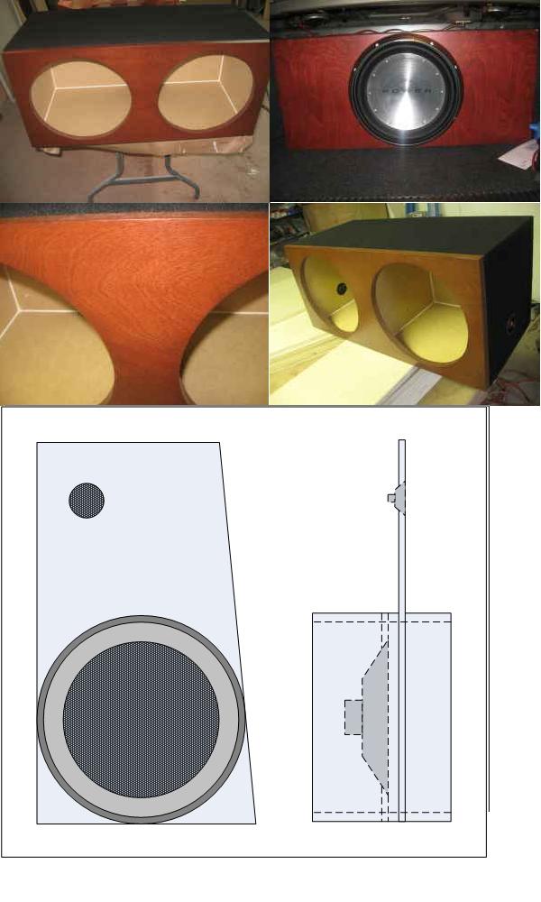

I could not believe it's so hard to find someone in houston, tx to build a pair of simple H frame... man oh man... I may just go to a a lumber store and have them cut me 8 pieces of 21"x15" and glue them together myself. Problem is i dont know how to glue/clam them together.....
Someone at my local area just quoted me $350 to build 2 21" x 16" H frame boxes (with top baffle insert) in nice red mahogany. Is this a fair deal. He said the wood alone are $140 and his labor are $210.
Pictures of his works included.
Aengus, i copied your design, hope that's OK.

tnc, I'm delighted. Just recognize that my "design" was a quick sketch, and comes with no guarantees - you might want to at least check it out using Tolvan's edge; and, in any case, let us know how it works out.
As to your quote for the H-frame, I've no idea how to value this stuff. If the guy is doing it for a living, and it takes him (say) half a day, including set-up time and shop clutter time while the glue dries, that seems pretty OK to me; but it's a function of how much per hour you are willing to grant other people's labour is worth.
You could do it yourself: you don't need mahogany, just a decent grade of plywood. Your local lumberyard will cut it for you for a nominal price (or you could DIY it with a circular saw and cutting guide). Buy a couple of 24" clamps and some glue, and you're there. Really, it depends on whether you think you want to go down the DIY path on this stuff - the decision is always whether to spend the money on the tools and amortize them over the next 10 projects, or whether to avoid the hassle (if it is hassle to you) and just have it done.
There isn't - or shouldn't be - any value judgement attached; the question is where you want to spend your time and energy. My own view is biased in favour of buying the tools and trying it for yourself, because when you learn to do stuff, it expands your abilities in unforeseen areas; but there's always a tradeoff. Given a universe in which entropy exists,

Thank you Aengus. That's very nice of you. Your design should work very well for me.
With 2 little young ones, it would be very hard for me to find time to put the baffle together so I may just bite the wallet and have the cabinets made; the cabinets would look nice and will be acceptable by the lady in the house...
