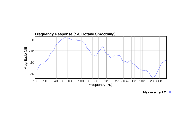

Here is the measurement, taken about 2" outside the horn mouth.
I am sorry to hear about the driver. Have you measured near field driver output both with the horn running and then with the final sections filled with damping material to spoil the horn. The difference will indicate how much radiation resistance and at what range the horn contribute.
