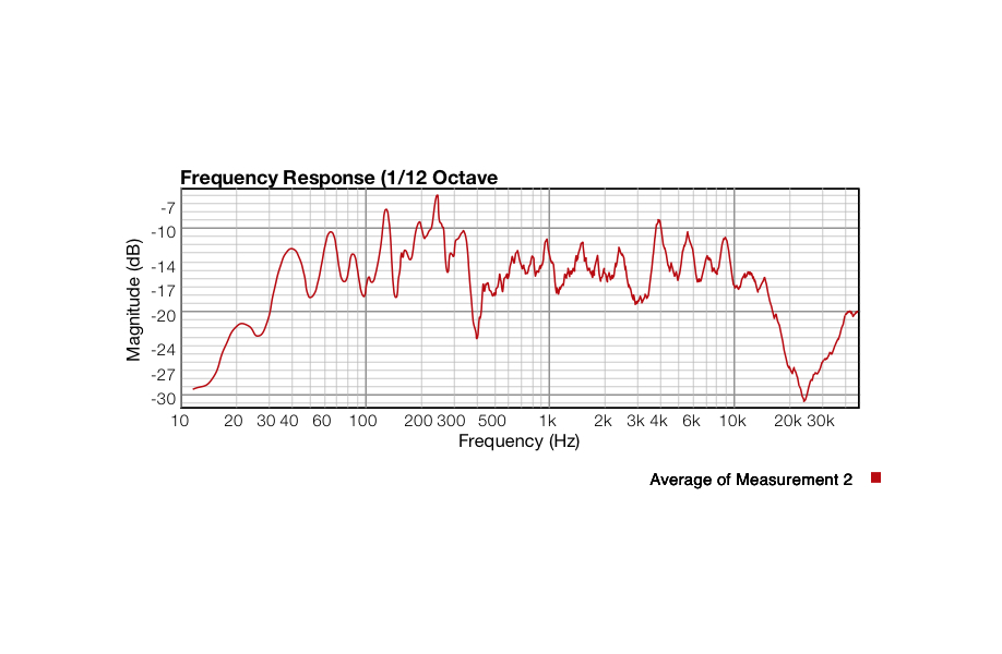

I just completed a test box of this design and loaded it up with a tang band W5-1611. Using test tones I found it to have good output to about 45hz before rolling off. Have not had time to run a FR sweep yet. I found that it needed BSC, and running it filterless it sounded pretty thin. However with some BSC in place it sounded good and it's clear that the horn/TL is doing its job. I'll try and post measurements and a picture or two in the coming days.

Looking forward to your photos and freq sweep. I am surprised it needs BSC as there should be plenty of bass gain to offset baffle step losses.
I had thought so too, but it sounded very thin out of the gate. 3db of bsc around 500hz up balanced things out (I was not being terribly scientific about the whole thing). MJK's article seems to hint at this, though I wasn't sure:
Looking back at my previous documents addressing back loaded horn designs, the original goal was for the horn geometry to be so efficient that when its low frequency SPL output was combined with the driver’s SPL output the need for any form of baffle step compensation would be eliminated. In a no compromise system where size is not an issue, this approach is probably still valid. Unfortunately as nice as this concept sounds, I no longer believe that this is possible for a reasonably sized back loaded horn enclosure design.

Speaker and amp are finally home, and my initial concerns about BSC appear to have been unfounded based on listening tests in my room. Bass response is very good. Here's a FR graph from close to my listening position, so this represents a LOT of room interaction. There's also a chance that the placement of my stereo is actually choking the horn output. I'll post a picture of the horn and its room placement soon...
