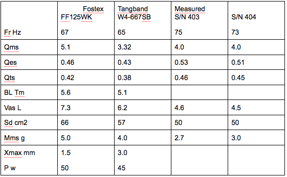

Regarding the Tangband
Stated cone area is to big. 57 cm2 correspond to a diameter of 86mm and then much more than half of the surround is included in the cone area
Diameter of cone and surround is 90mm, getting to half the surround 82-83 mm that is 54 cm2 but then the center is not part of the cone and there is 5.3 cm2 so in alles about 50 cm2 not 57.
They have been played a bit before and now I have had them unmounted and played them quite loud with cone movement of +/- 1-2 mm. With some few hours of play time they still had a Fr of 85-90 Hz. Trashing them with Ramstein Mutter and also the Sensucht album as loud as I dare with several mm of cone motion and me out of the house, repatedly have moved down the Fr to 73-75 Hz so far.
