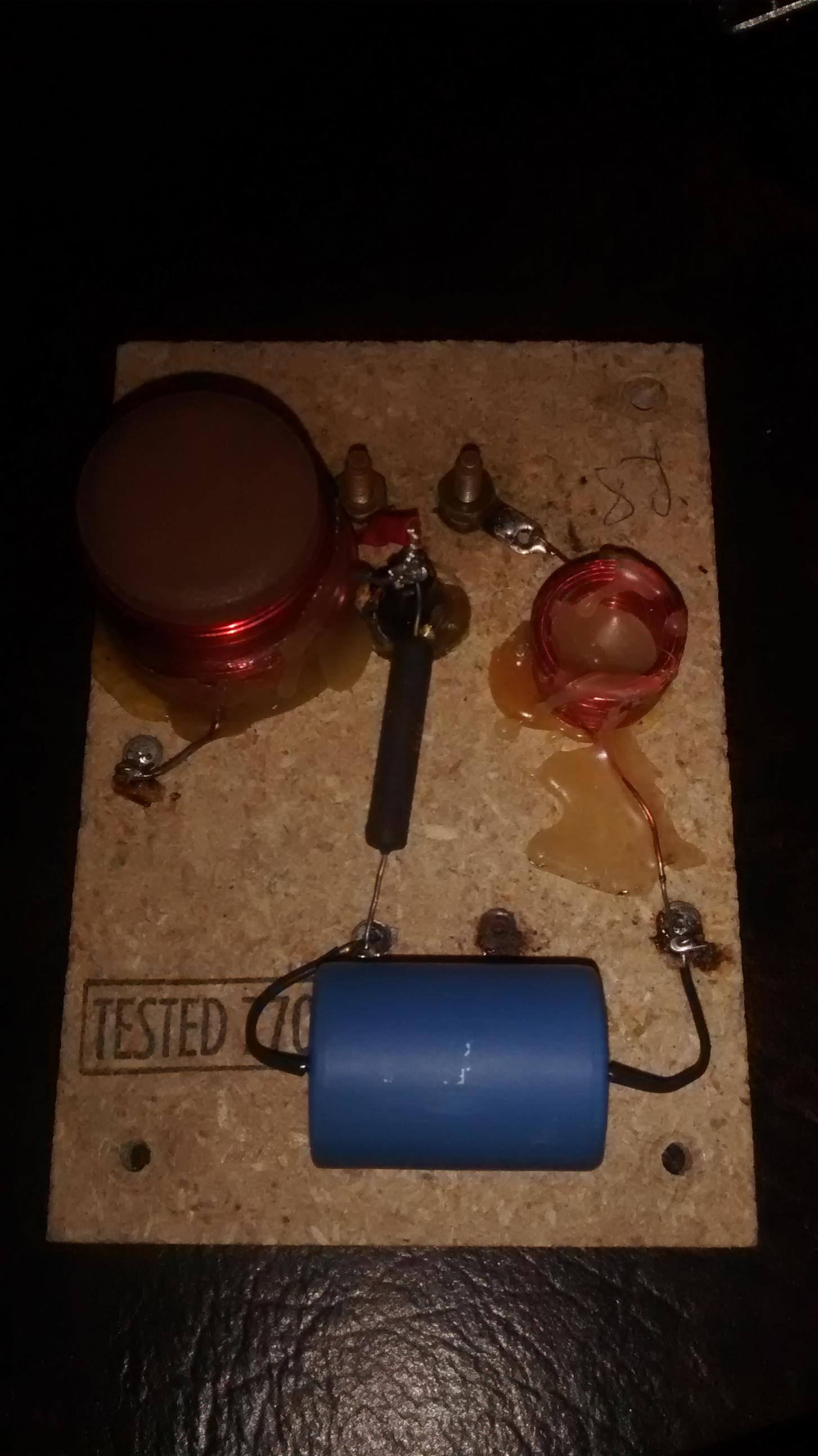

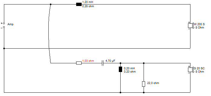

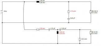

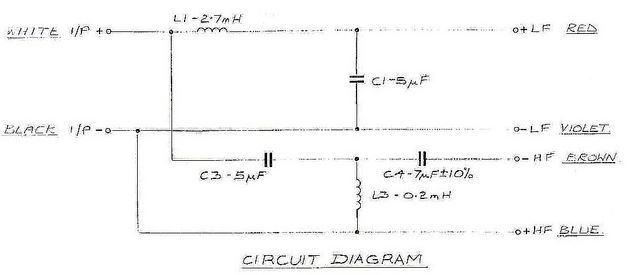

Original Crossover:

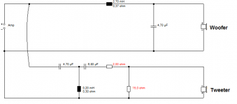

New 10uF polypropylene tweeter Crossover:
TBH, I can't imagine that original polyester was more than 3.3uF, but see how it goes. 🙂
The idea with SEAS 8" polypropylene bass drivers was they need little filtering. So a bass coil might do. 3kHz positive polarity crossover.
These days I do higher order filters. Along the lines of the classic KEF Celeste III. Maybe smaller bass coil, and bigger shunt cap maybe with some resistance added to avoid a peak at midrange caused by the bass units inductance. I don't like too much bass.

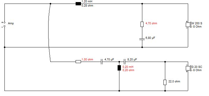

Hi Steve,
You are supposed to add a zobel network across a woofer to correct for the rise in impedance due to inductance. That is always an R-C combination. There are ways to figure out the correct value.

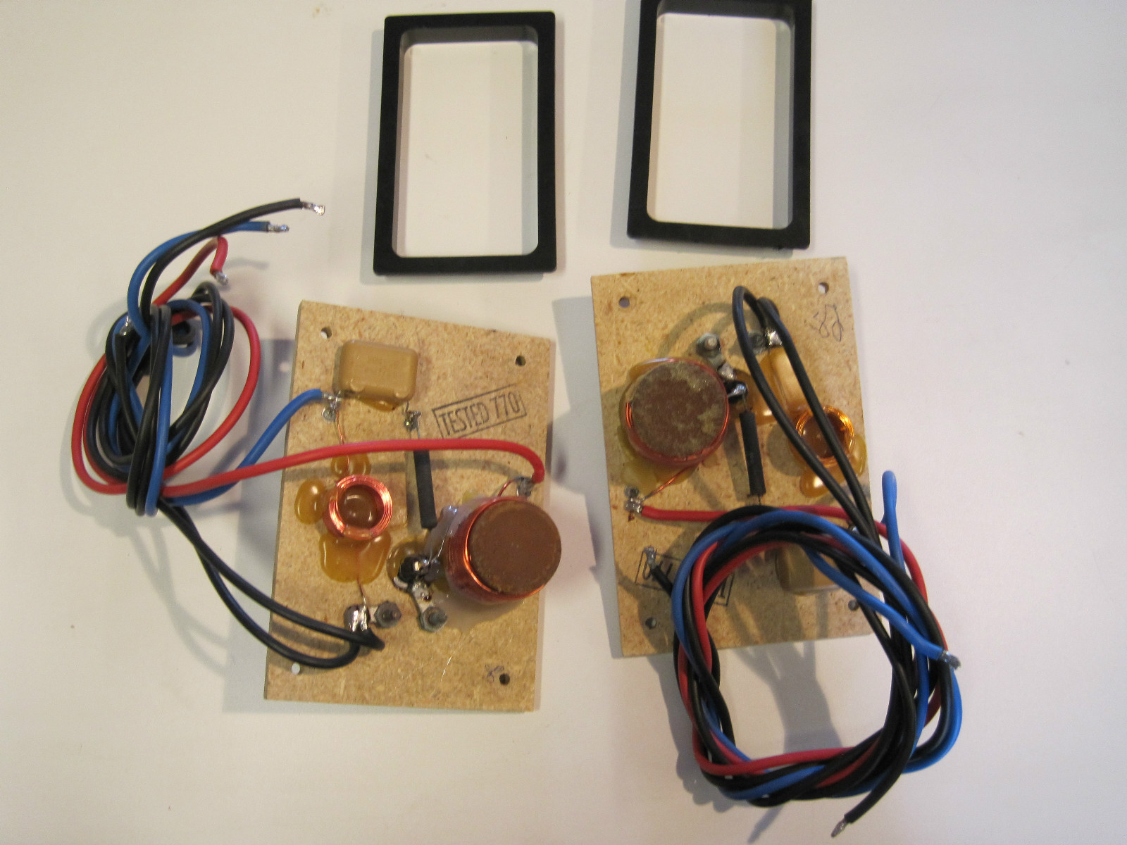

I had 770, my uncle has them still. they were both SEASes, tweeters replaced -93 and woofers -96
if i remember correct these have sort of BBC dip

A possible- even likely- improvement would be a complete redesign of the crossover to drop the handover between the drive units to 2kHz or so. The original SEAS tweeter wouldn't've coped with this, but the Morel will. This would give better directivity matching between the units and make more and better use of the tweeter. Should sound better, if done properly, but you would want to measure the drive units in situ to do that.

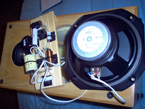

I had to send the capacitors off to be measured because the only markings on them were ITT on one side and 10/63 on the other side.
Forgot to say I changed the resistors first but it didn't sound right so I put the old ones back in

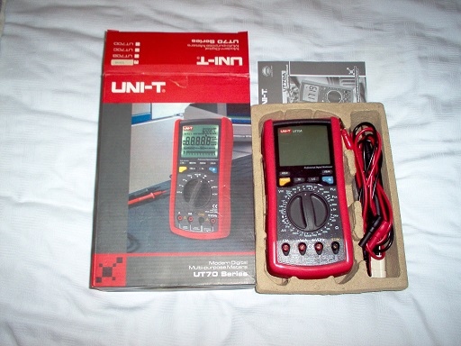

You really need a good multimeter to do any more than measure DC resistances. My one below does capacitance and inductance too. Very accurate.

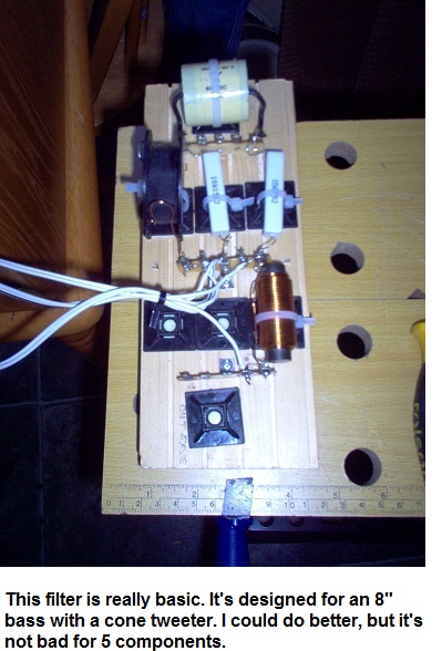

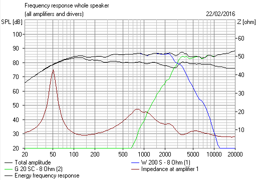

You then have a choice of circuit, but the SEAS 8" polypropylene units have a natural rolloff at 3kHz.
Along these lines. Resistances are a moveable feast, set by ear. Not hard. One of my BW3 modifications below. Probably the best circuit for this type of speaker.

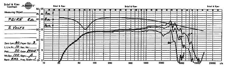

thanks i have to get a good meter i had to send my caps to wilmslow audio so they could figure out what they were. i tried just changing the resisters and they didn't sound right at all so i put the original ones back in but iv bean rely busy looking after my mum so they had to take a back seat for a while but i recently notist an imbalance and when i measured them they measured differently so i dropped the cap's out and sent them in and got new ones. just glad i court it before it did any damage.
Even a cheap £10 multimeter can measure a 2.2R resistor or a 6R voicecoil resistance. What's hard about that?Hi Steve,

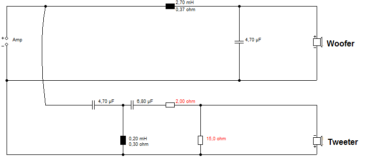

The business of added shunt resistance with a capacitor depends on the voicecoil inductance and the bass coil values. With KEF's 2.7mH and a bass unit below Le 0.9mH, you won't get a rise in the midrange. The classic 3:1 ratio of third order butterworth used in the KEF Celeste III.
With a smaller bass coil, you will need that shunt resistance. Lots of ways to do this. Troels even uses a 22R shunt on occasion, for only a slight rolloff:

p21RE does not have inverted outer rubber as p21re-m has, that might differ slightly top end response
I feel that 10uF on the tweeter is just plain wrong here.
This is a 3kHz crossover with 8 ohm tweeter. You can use 3.3uF/0.3mH with little change. The bass coil is a matter of taste. Bigger makes for more bottom end. I usually place close to the wall, so I don't want big bafflestep boost. The red resistor is level adjust. Those Morels are quite efficient, for instance, so 6.2R might be appropriate. Select on test.
if i have time i´ll solder re-m out from 765 and give you guys some responses
I really don't think it matters. 3kHz rolloff is just what well-behaved 8" bass units do. 😀
This is a 3.3uF/0.3mH tweeter filter. Probably 1.5mH bass coil. The only other variable is the series resistor in front of the tweeter filter. Depends on tweeter efficiency. Speakers are such an inexact science, I think you'd struggle to improve it without going higher order.

Your inductance / capacitance meter will be similar. Good meters such as the Fluke 87 series, or the new Keysight meters are much improved over what yours can do. That is why I bought and use an Agilent LCR meter + factory Kelvin leads (those cost more than your entire meter). The newer meters are improving, but you have to recognize their inaccuracies. Have you ever figured out the error budget for your multi-meter? Each function and range will be different, including where in that range you are measuring. It will be substantially worse than the basic DC accuracy stated on the box.
If you ever get a chance, compare your meter to a lab asset or calibrated instrument. An HP / Agilent / Keysight 34401A or better would be a suitable comparison product. They are a standard meter through much of the industry. A lab asset would be an HP / Agilent / Keysight 3458A (industry standard asset). If you have access to a Fluke 5500A or better calibrator, you can get a very accurate idea where the weak spots in your own meter will be. BTW, most cheaper multi-meters are inaccurate on their AC ranges once you reach 400 Hz. Really good hand held meters will extend their range to 100 KHz or better. They will also be true rms reading meters.
I am not trying to pick holes in your methods. All I am attempting to do is have you recognize the limitations of the equipment you are using, and what equipment you are recommending. If you are taking speaker design work on seriously, then you would be well advised to at least plan for equipment that will do the job you need, and at least buy a used example and have it calibrated. Then your work will more closely agree with the calculations.

Ye Gods, this Mission filter couldn't be simpler, could it?
Naturally I'd measure the DC resistance of the drivers and that one level-setting tweeter resistor. 10% accuracy would do. I could then guess the appropriate values. If it's a 10uF capacitor, we might be looking at a 4 ohm tweeter. IDK.
This is a bog-standard 3kHz simple filter. It plays nicely with 8" bass.
TBH, I have forgotten what we are trying to do here. Anybody remember? 😀

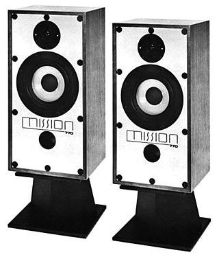

- mission 770 crossover
