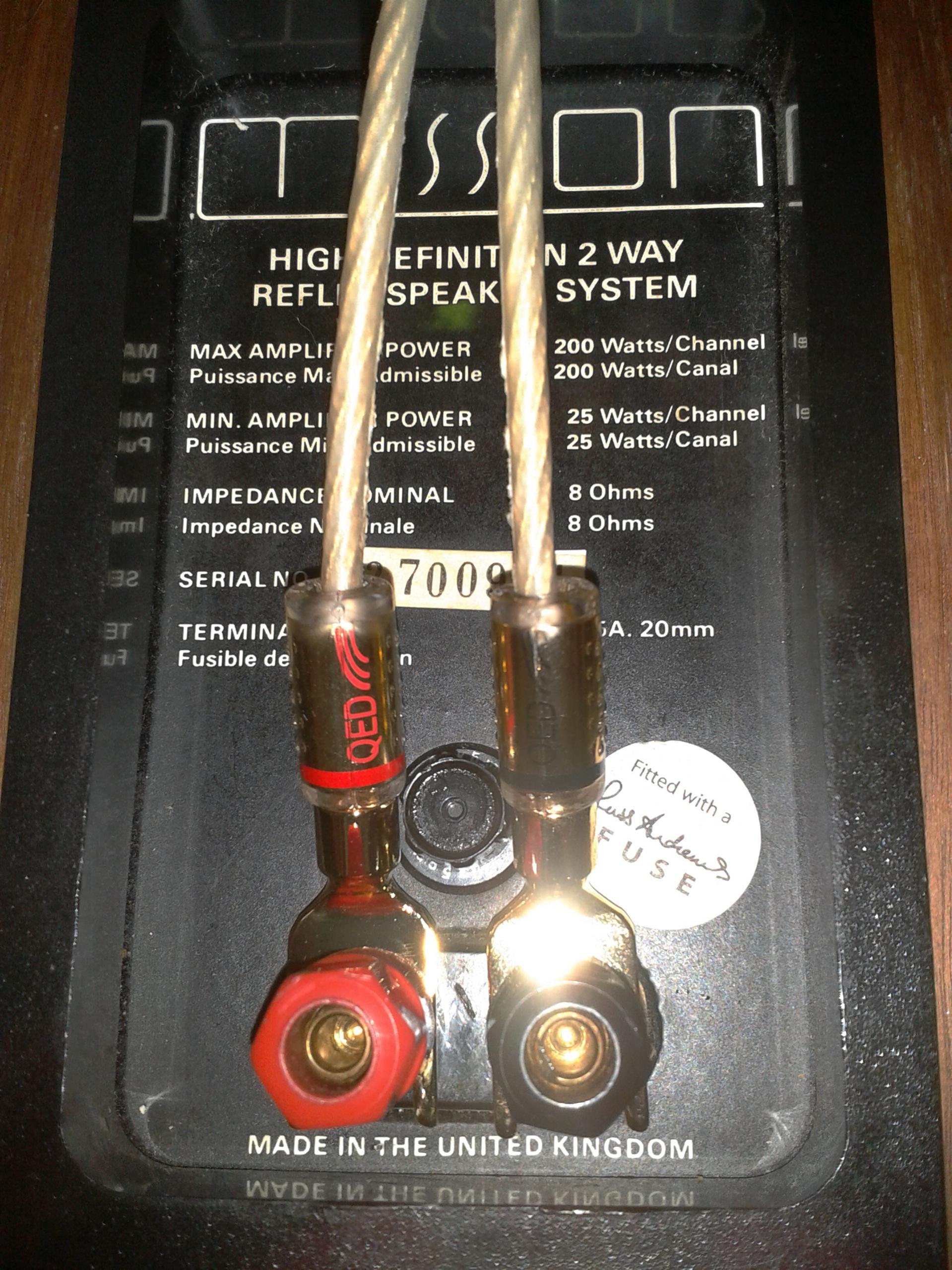

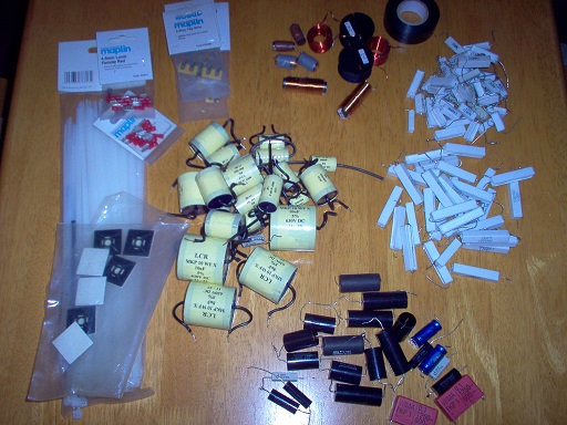

been away for a while but have sorted my missions got some good quality fuses in the crossovers and new foundation stands i put ebony cones in between stands and speaker an re bult my speaker cable with new qed spades and bannana plugs they sound loads better thanks for all the help ime hopeing to do more soon but for now they sound great.
martin 🙂

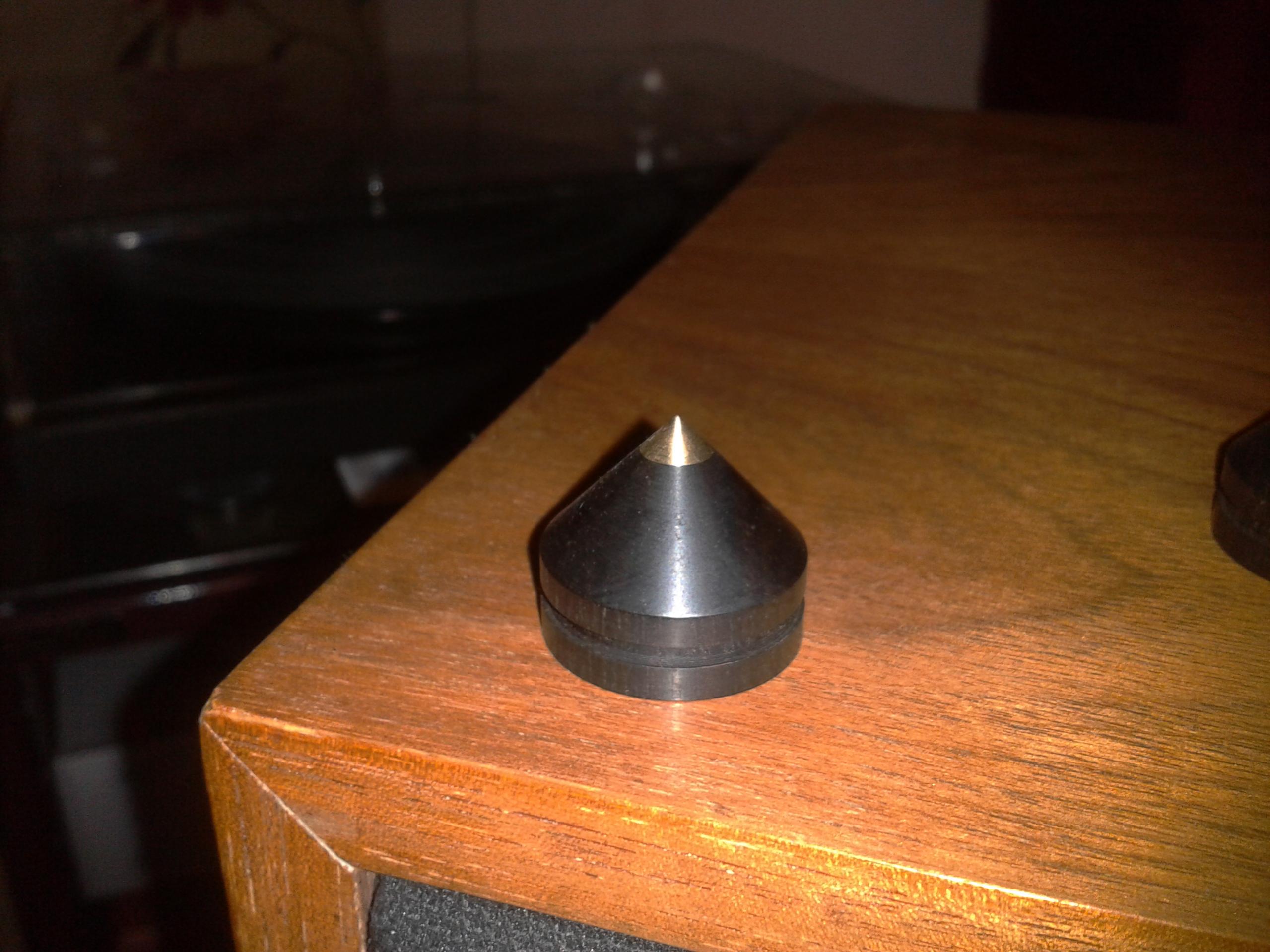

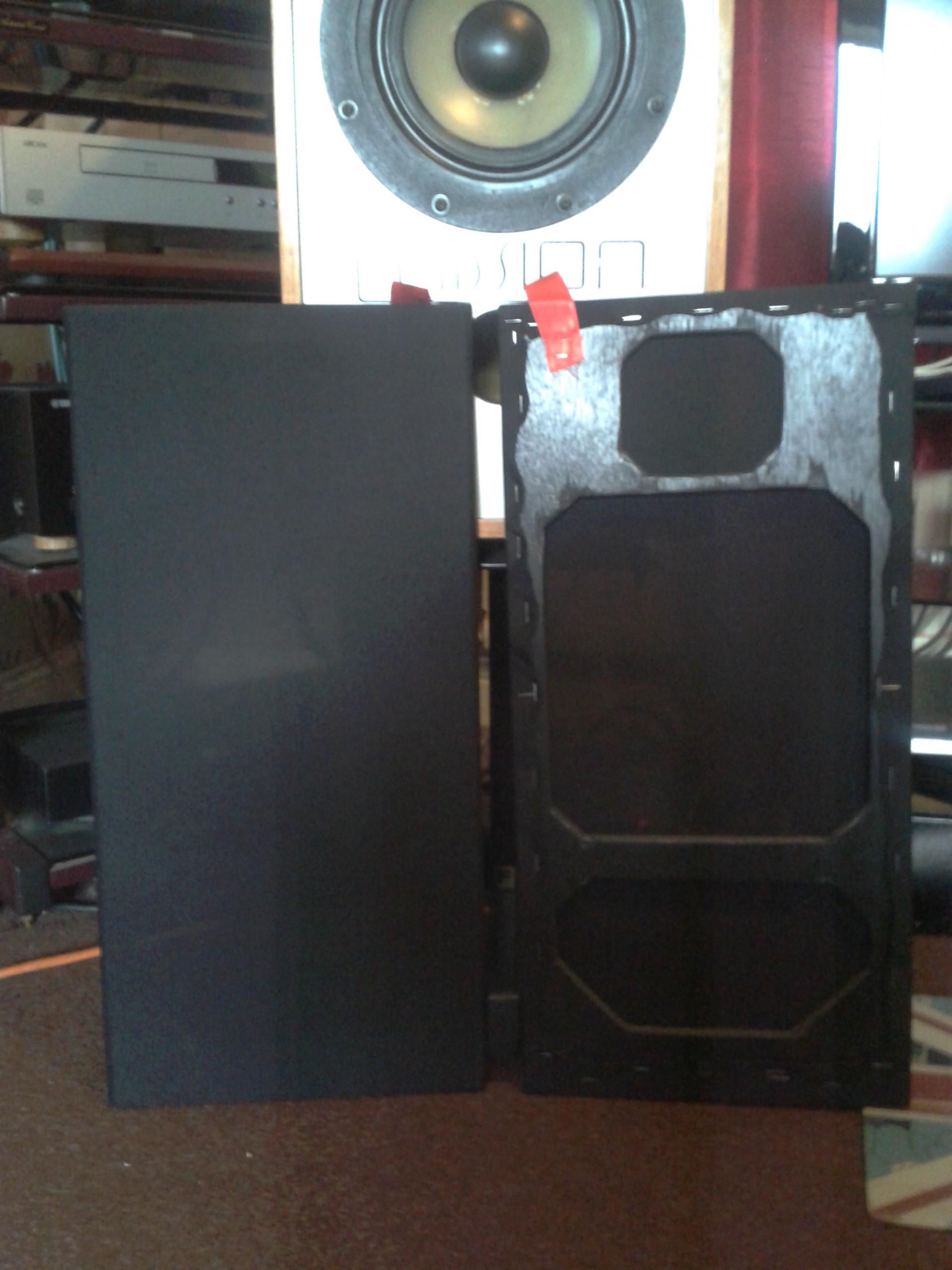

sorry forgot to show you all the covers i made

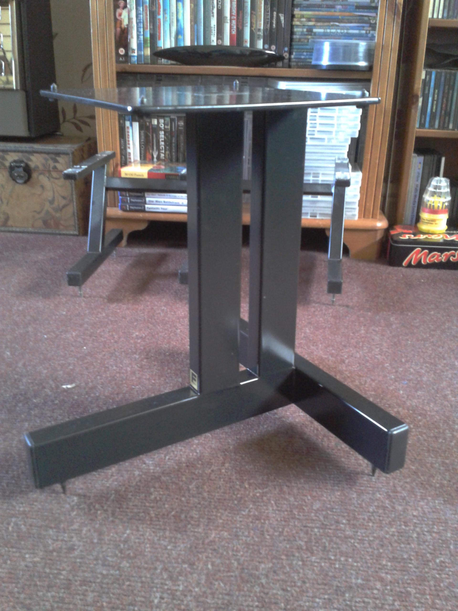

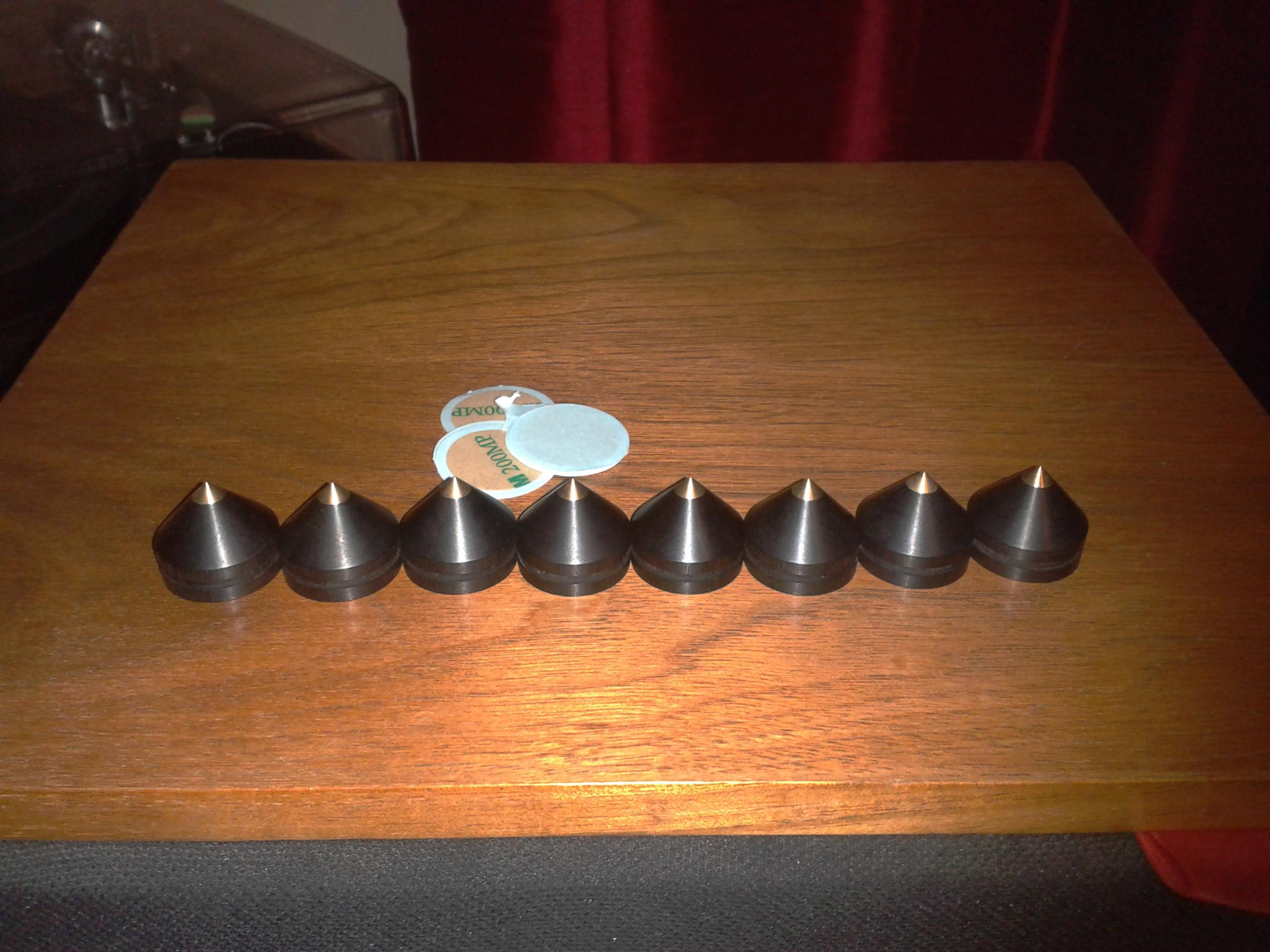

and here are the stands i got and the spades and fuses seem to have made them sound much more even in terms of left to right imigeing much wider soundstage you can realy here where the players are in there now
thank you again for all ive lernt so far on this forum long way to go yet but finaly starting to get results
I use rubber feet myself. More out of practicality than anything. 🙂
Very good tweak is to stick something rubbery or carpety or underlayish to the sides of the panels. With reflex you leave the centre of the cabinet mostly clear, but it always helps to get the noise floor of the cabinet down.

I do have a bit of a problem ive noticed there is some white corosion on the back of the basckets on the midbass drivers is there amything i can do to get rid of it and stop it coming back do you think.?
Just alloy rot, I'd think. Motorbike wheels and engines get it too. Big problem in the Far East where it is very damp. 🙂

Have you tried that Zobel I suggested? That can make a lot of difference to the top end smoothness. Something modest like 7.5R and 0.68uF across the tweeter does a lot to tame the very top end. Makes a speaker a lot more listenable IMO.
0 68 fd SuperSound Capacitor
Ceramic Resistors
You can also get them at Maplin.
I have a good idea how your speakers sound:
Ceramic Resistors

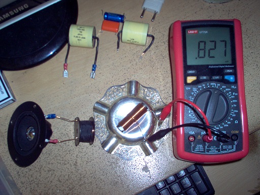

Why don't we see a schematic of the 770 XO with all the values?
Adding some brightness to them is a very simple task though.
It's just a 1st order low pass and a 2nd order high pass + resistor,
similar to most early Mission XOs.
Just replace the (only) capacitor with an poly/MKP and swap the
resistor (you called it the "long black thing") for the next lower value.
For this you'd need to measure the current value. That's all.

What setting on the meter will be needed to test the resister and the capacitor
from what ive been told the cap should be ok and wont degrade but the resister may need replaceing is this right ?

You need the 200 ohm scale. To get the level right, you may now need to change the input resistor to the tweeter filter. Wirewound 7 Watt 2.2 Ohm Resistor | Maplin
Bigger like 3.3R makes it quieter. Smaller like 1R makes it louder. This involves soldering too.
40W Soldering Kit | Maplin
You apply solder to the soldering iron the first time it warms up. This is called "tinning the tip". Otherwise it turns black (oxidises) and is ruined.
Capacitors are always marked. Yours will be 2.2uF, 3.3uF or 4.7uF.

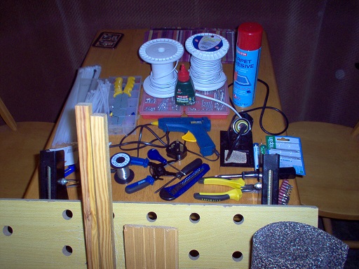

I hope you can start building up a collection of tools and bits too. Sky's the limit then!

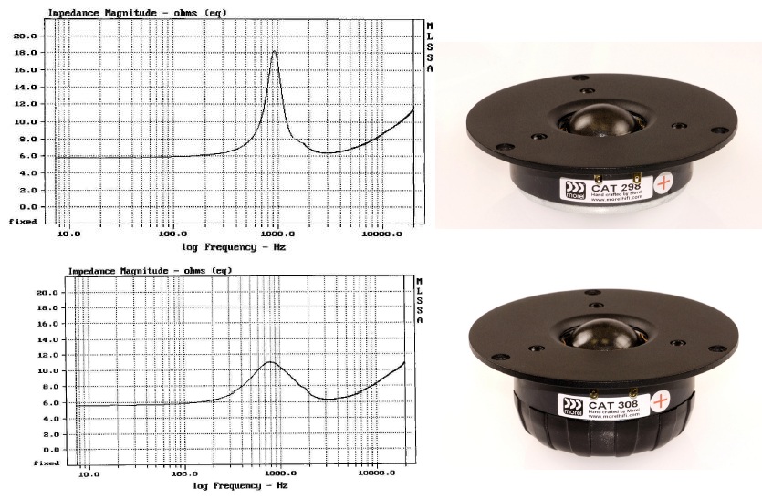

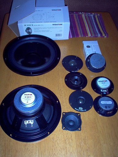

I nearly forgot. The difference between the Morel CAT 298 and the more expensive CAT 308 is interesting.
Essentially the same tweeter. Same voicecoil, replaceable dome and magnet with ferrofluid. Similar frequency response.
The CAT 308 has a bigger rear vented chamber. It's like a bass speaker in a bigger box.
So the low end issues might be less. The impedance peak is called the Fs of the driver. You usually try to get it well down in level with a steep crossover to avoid some ringing problems. Or notch it out with a LCR circuit tuned to 900Hz.
