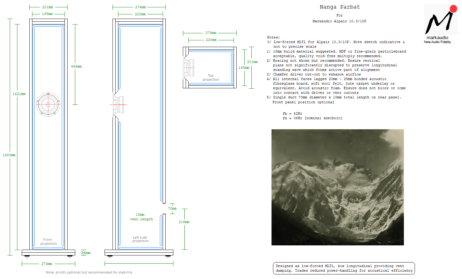

Hey guy,
I wonder if someone could address the Changtse to a newish speaker maker? I noticed in the last 6 months it appeared on the Mark Audio sight. Anyone make this speaker? Also I notice it has about the same volume as the standard Pensil but rear ported? Is the taller more narrow design more fore smaller footprint or does it have a significantly different sound to the Pensil?

At the risk of being slapped by Batman, if you wanted to make the MLTL's a bipole would you just double the cross sectional area of the line or do you have to change the port as well?
Yes, 2x net Vb, ~2x vent design for a given Fb, though differences in pipe end correction will shift Fb upwards an inaudible amount.
Scott,
Nice to see another design go public from your catalogue. 🙂
Quite tall, but should not be overpowering - with good cabinet work, the speakers should have a decent presence in the listening space.

do you have any feedback/reviews on the Oberon standmounts? Basic DCR for the 10.3. Dimensions and extension look good, quality of sound is where I have questions. Am I selecting the correct driver for sound quality, or am I just getting more low end extension with the 10.3?
Construction questions,
i built a pair of superpencils, and I will use a derivative of its internal bracing for the DCR.
How do you offset the brace to accommodate the ports?
Do you brace the lower chamber?

They're different; the 120 has about 40% more cone area, requires a larger cabinet, gets lower if given that, has slightly narrower polars by ascending frequency & so on. The 10 is arguably a bit more refined, so depends where your priorities lie.is the 10x the better of the drivers, or should I look into, for example, the chr120?
Essentially it's your choice: bracing in this design is optional rather than being in any way 'make or break' & I left it entirely in the hands of individual builders whether they wish to do so, & their preferred method.how do I cut the internal brace to avoid the ports. Also, do I need to brace the lower chamber?
