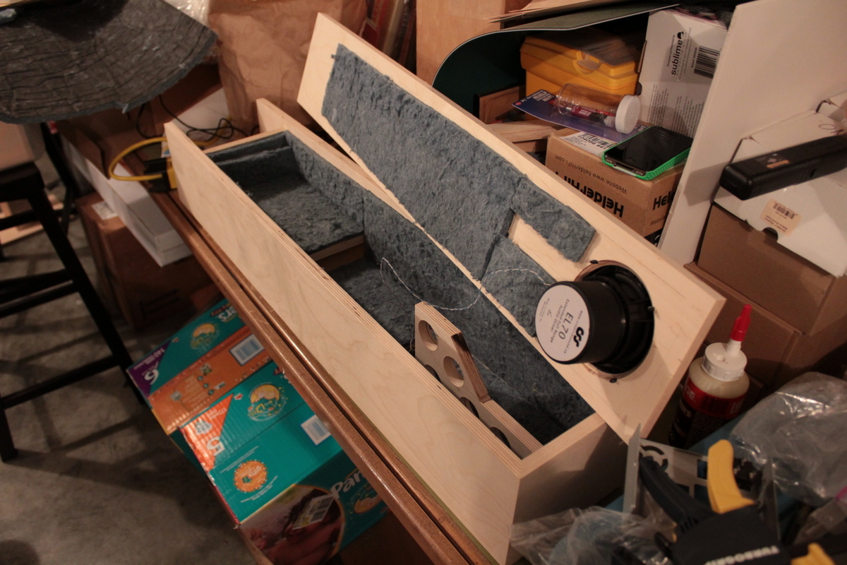

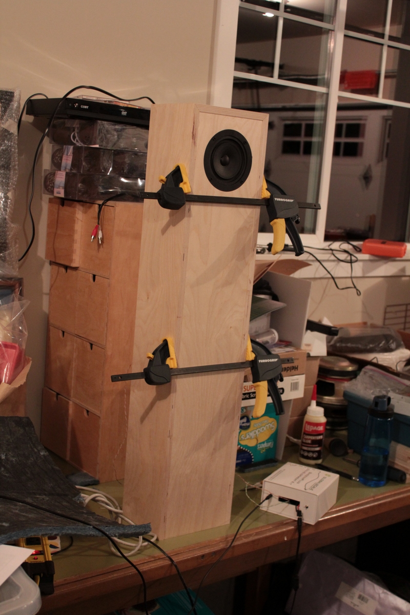

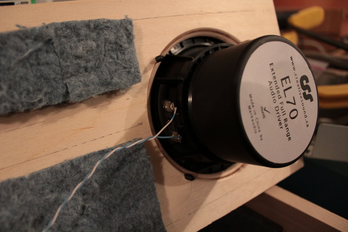

Hello,
Just got one side of my floor standing Mar-Kel70s together. The sound is right along Dave's description of sounding like book shelf version. I am very pleased. The baffle will remain unsealed until the second side is built so I can properly assess the stuffing.

Thank you. I lucked out with some Baltic birch that had some nice grain on it. The plan is to trim all round and chamfer the baffle edges. I am undecided as to whether I will veneer the cut edges. I'll have to see what it looks like. The top and sides are mitered together so they frame the baffle nicely. I am hoping to finish the wood with something called Osmo. A friend used it on his butcher-block counter top and it looks fantastic. I'll post results when I try some out.

Have you used the Osmo product before? I think that's the same material Bernie used on some boxes for Dave - nice look for a clear finish, and I understand very durable - as any finish intended to survives much time casa P-10 would need be.

I don't know what Bernie uses but the finish looks simmilar. It goes on like an oil but looks a little like a varnish when dried. Dogs, kids, Dave; it's a lot to take!
