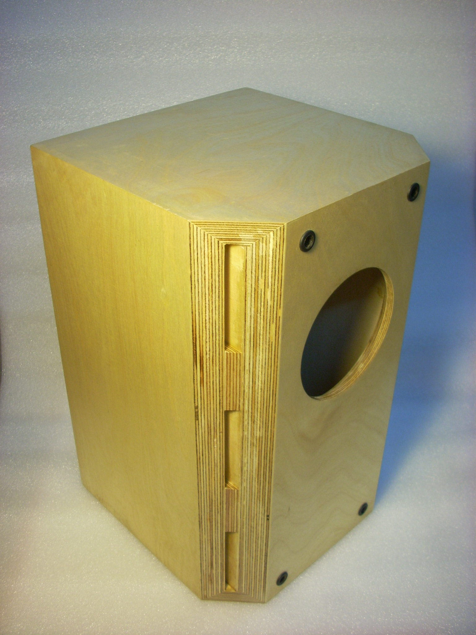

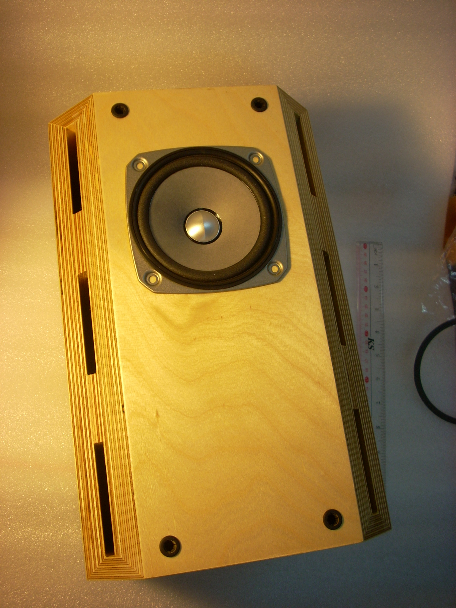

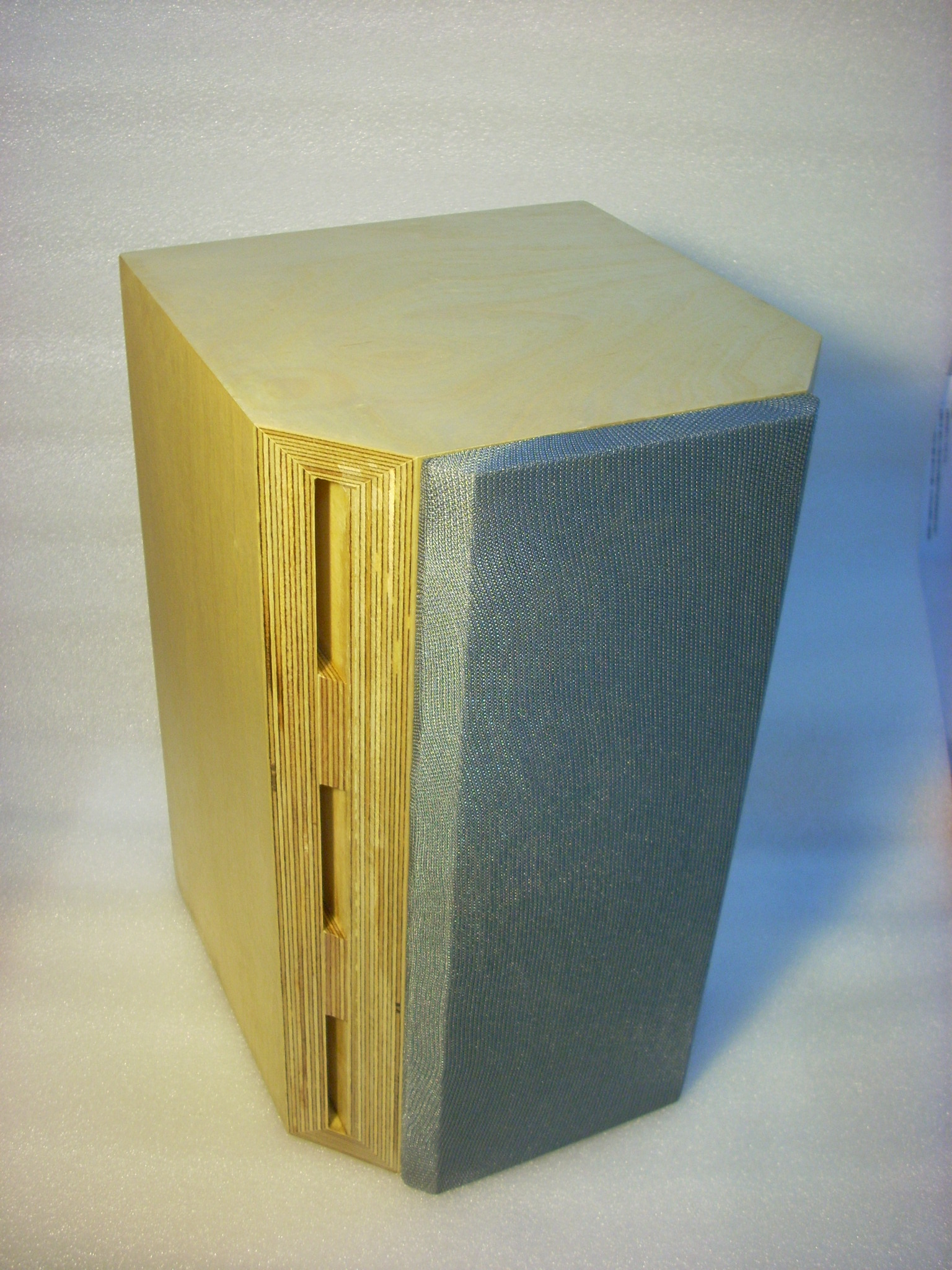

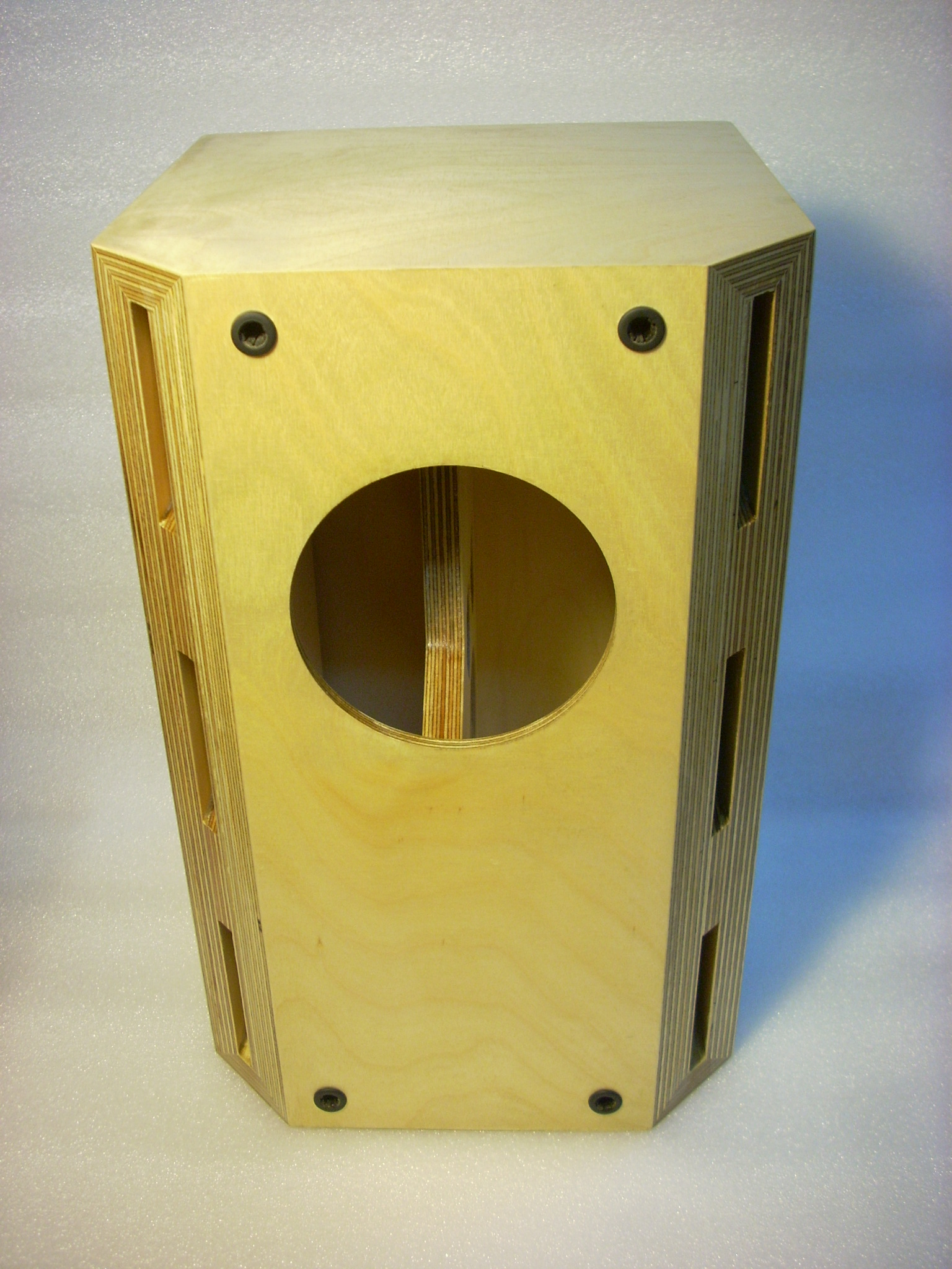

To reduce diffraction signature. Makes a greater difference where the baffle is large and the driver small. Centering the driver is not forbidden. On things like the CGR MK12 it would make very little difference.

Dave,
Maybe this question has been asked before, but why do CGR-Ken's have drivers offset towards one side?
-Zia
reduce diffraction effects (harder to do with narrow baffles such as the 'Kens, FH, Pensils, etc) and the chamfered 'Kens already have a fairly benign signature

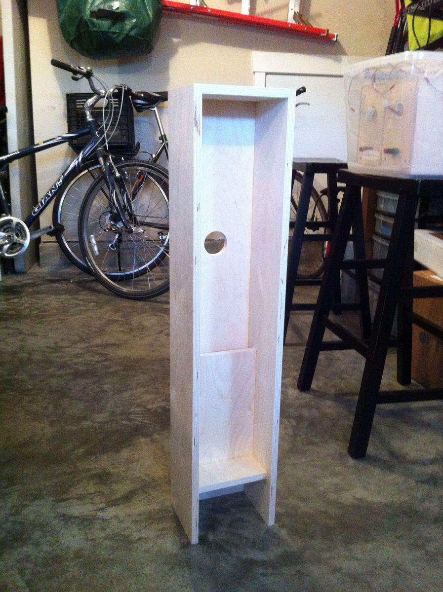

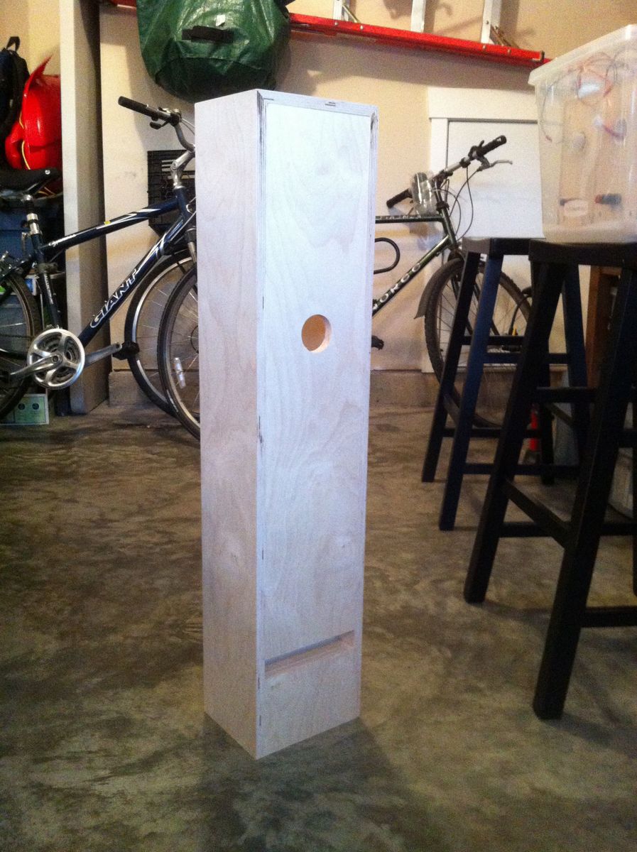

My set of floor standers is coming along. One side is ready to line with felt, braces and put the baffle on. Was any stuffing needed to stop unwanted resonances? I am a bit hesitant to seal them up without knowing. I'll try and have a listen with them clamped on first.
KM
I'dbe putting some fluff (or left over cotton felt scraps to at least a 75mm level at the extreme bottom between the baffle & the vent shelf.
dave.

I'll do that, thanks Dave. Do you see any major benefit to putting some random height blocks behind the driver to break up any reflections that might make it back through the EL70 cone? I saw the treatment you whipped up at last year's DIY fest on another speaker.
KM

the figure on drawings I got from Dave stated between 45-106g of poly fiber batting in - I went for full felt lining and 100g on the pair currently on the bench
in my haste /hubris, I elected not to make the back panel removable and they're already buttoned up, so it's too late to change now - we'll see how they turn out

could make for an interesting jenga puzzle to combine something like that with front to back holey cabinet brace - I ran mine long enough to interlock with the port slot
Quite beneficial. You don't want to eat up too much volume, and that close to the EL70 angled ends.
If the thot had occurred earlier the same thing could be done at the bottom.
