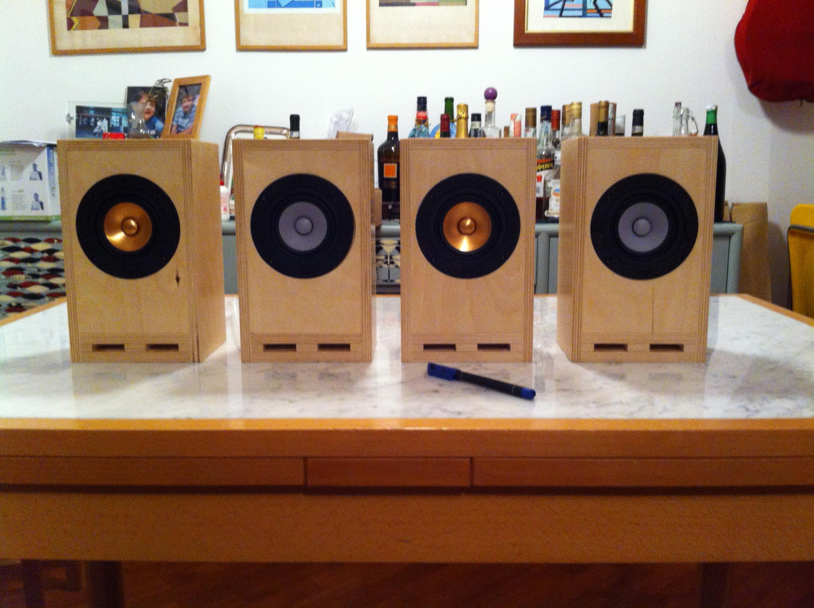

Bare - as I recall the "factory suggested" drawings for basic vented enclosures for the 12" ranged from 1.6 (45 L) to 3.6 cu ft (102 L) (Mallorcan and Stuart respectively)
The Tannoykens finished off at almost exactly the smaller of those two figures.
Unfortunately, something went terribly wrong with the veneer after a couple of months in the client's home (severe cracking along the flitch seams and grain pattern). They're currently on the bench after being completely stripped and I'm almost finished with re-veneering. They somehow feel even heavier than when I first built them 😉
Those look very nice - perfect for a desk.
How much bass response is lost in the smaller uMar-Ken6 vs. an mMar-Ken6?

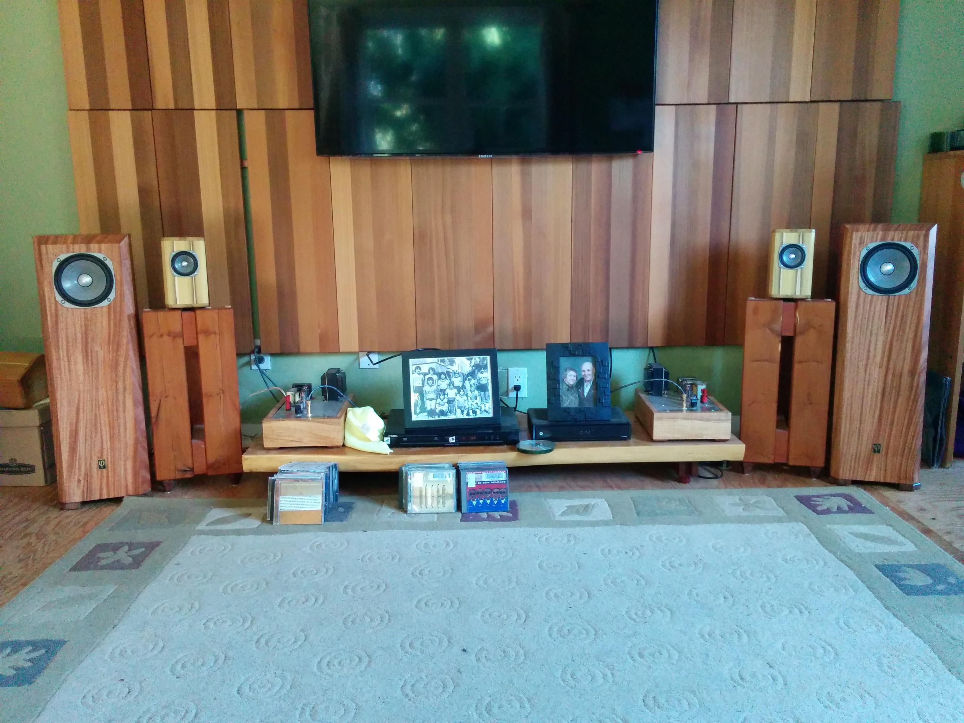

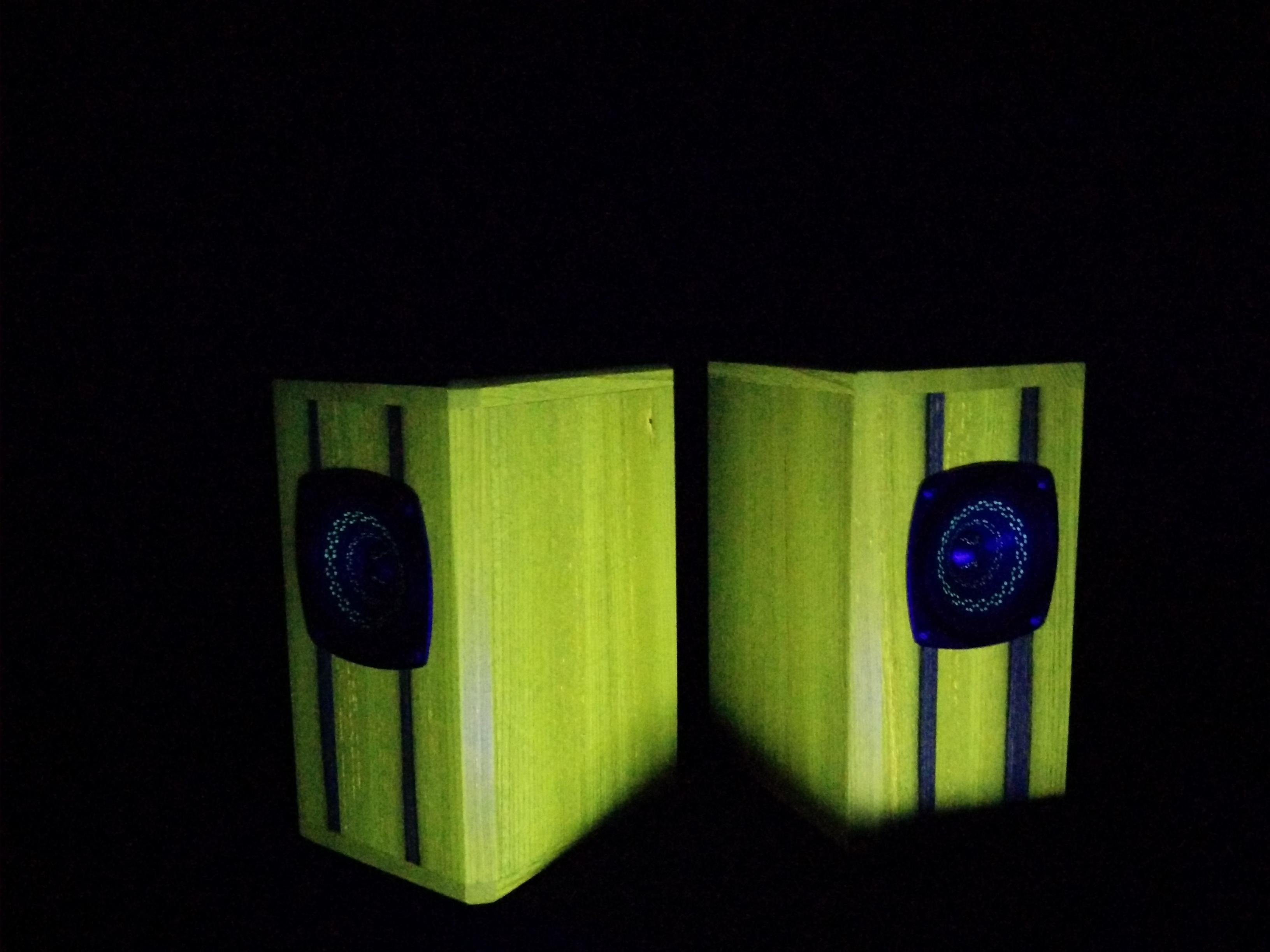

Fonken FF165wken floor standers made with solid 40mm mahogany baffle and ply enclosure. Microfonken FF85wken made from solid black locust. The locust has UV properties and looks pretty cool under a black light. Bernie
