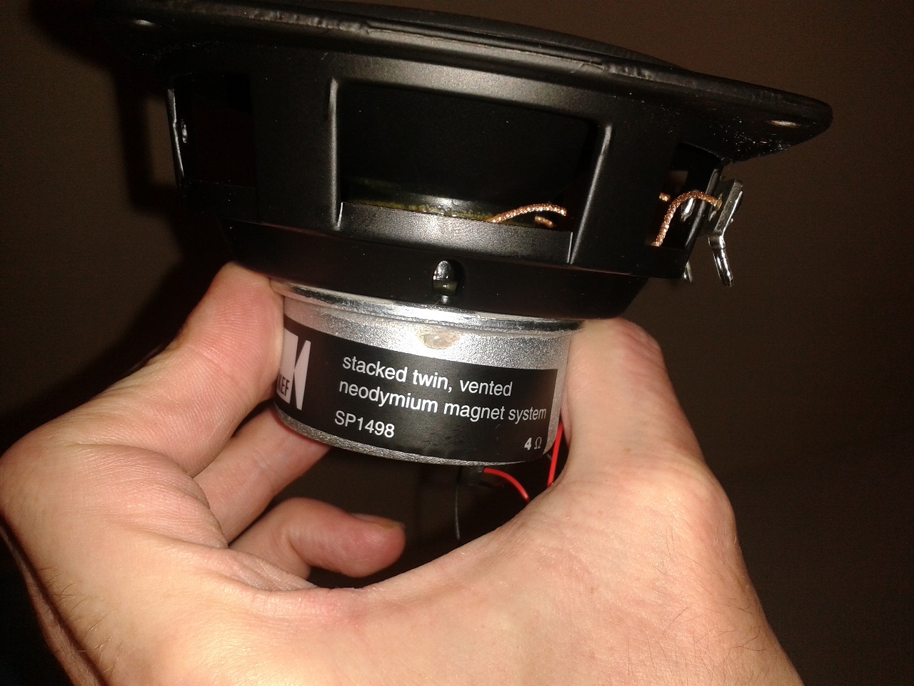

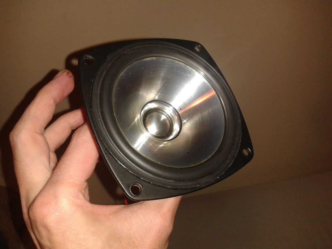

I have a pair of coaxial drivers in need of a decent cabinet 🙂
KEF Uni-Q's, 4" with 1/2" tweeter, I have a partial set of T/S figs - waiting for the engineering dept to get back to me with a full set (the Eng dept is still in recovery from flooding earlier this year).
The egg enclosure is a 'honkey mess' at the bottom of its freq range (60 - 50htz), but above that area the drivers are angelic.
Dave, if I send you the figures I have now, would it be possible for you to have a look and see if theres a design that might fit?
Yes. Fs, Qts, Va are the minimum required to figure anything.

Where do you guys get the drivers from? been after a UNI-Q either 4 or 5 inch Alu cone for a while...fleabay nothing....
Danny
Tell true!
You saw them and thought..... MUST HAVE 😀😀
Search 'that auction site' for KEF EGG or......
Explore KEF - KHT2005 - KEF International
or newer still:
Explore KEF - KHT3005 - KEF International
or even:
Explore KEF - KIT100, KIT200 - KEF International
A Single in good condition should set you back £35, you can still get them new, roughly £75 each (am after a second pair meself for another build)
