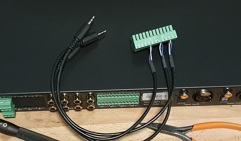

Before connecting to my amplifier I measured output resistance, to check my new cables.
On all channels, except channel 4, I measure about 10kOhm, on channel 4 the value was >30kOhm.

Anyone with a 4x10? Can you measure your values?

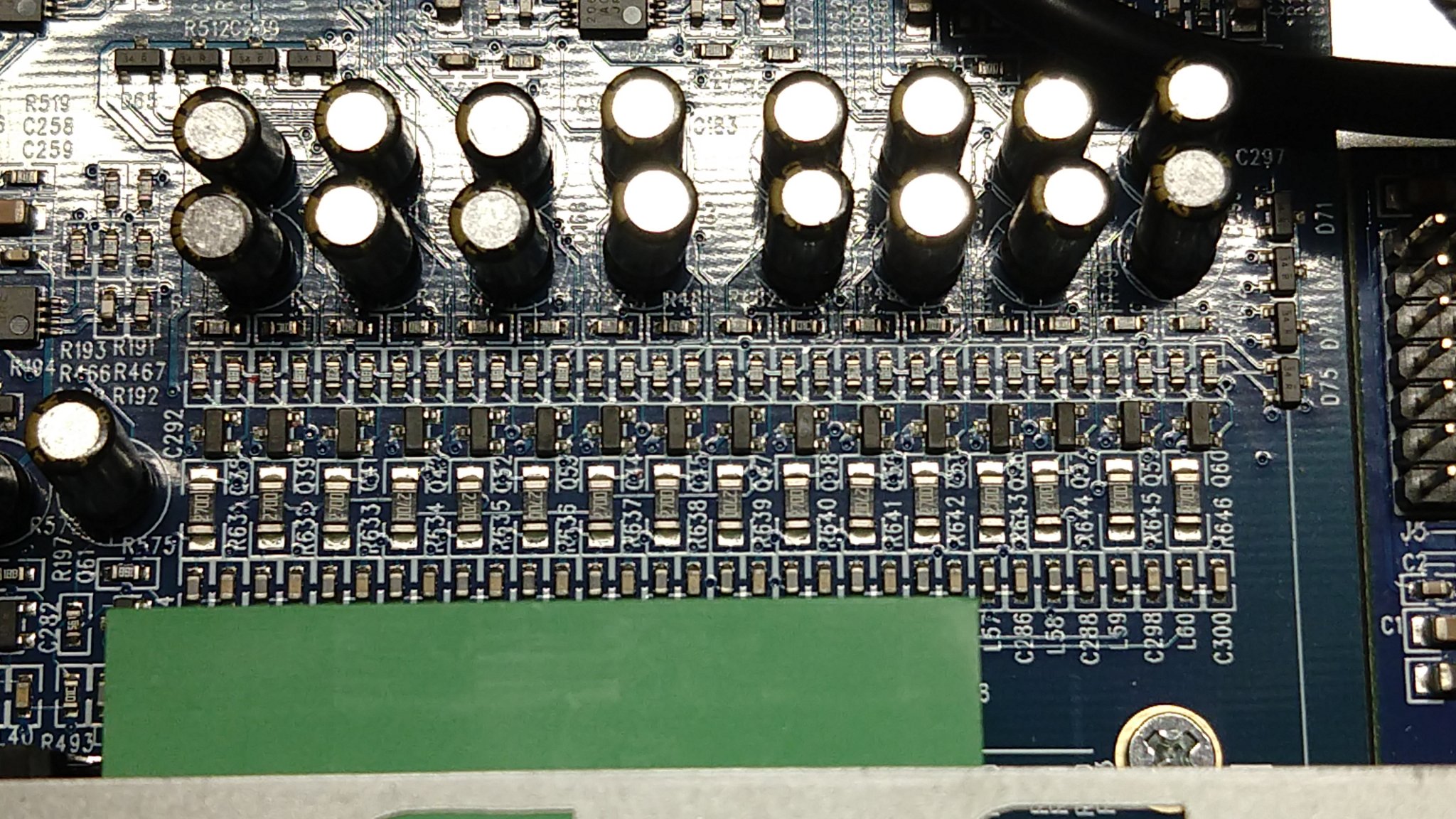

Yes, it is the wrong way to go about measuring impedance. I am an electrical engineer in product design and I stand by the evidence that channel 4 output resistance is different from the others, however it is almost certainly inconsequential to the performance of the device. It is merely interesting.
I opened my box and do in fact see that two resistor pairs for channel 4 are 51k (513 code, and as measured with my meter), while all the other channel pairs that are in the same relative positions are 10k 1% (01C code). These are resistors near the balanced output section. Now we know what, but not why.
Nice work.
Would be interesting to know why the design of channel 4 is different.
