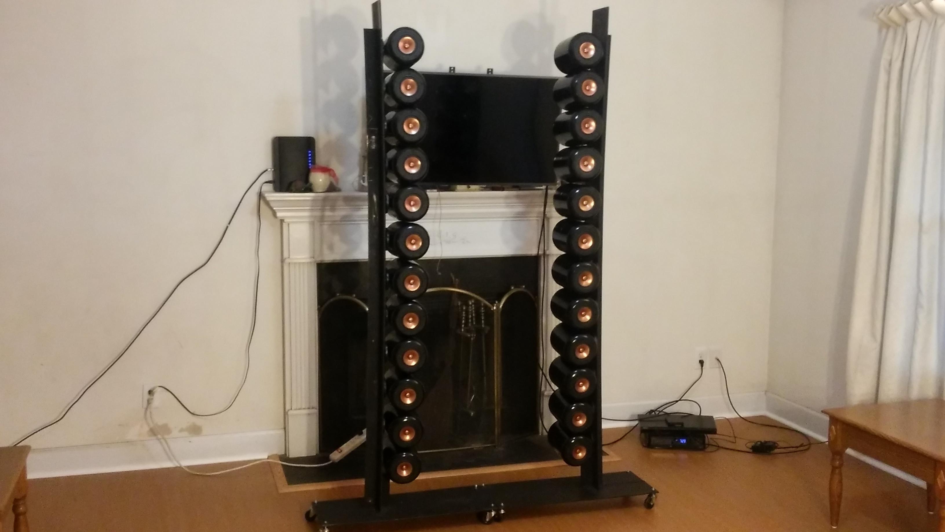

For the past 3 months I've transitioned all the enclosures to a 5" schedule 40 PVC enclosure using 2 endcaps and just about 3" of pipe. Finished painting them, stuffing them loosely with acoustistuff and using cat5e cable for internal wiring. (Credit to me for observing some of Dave's posts 😉)
You can read about it here.
A few developments:
1) There's now 12 P7 drivers per side, with room for one more since now my ears do not detect a lack of highs and can loose that AMT tweeter(present in above pics, not below), thus making room for 13 P7's per side.
2) No subs yet, sorely needed... Keeping the 8 SB Acoustics subwoofer drivers. Watch out for what I've got planned! Surely been done before tho...
3) Vinyl plank floors adding all kinds of artifacts I've not heard before when the rectangles were on wall to wall carpet.
4) Towers are wider apart and on casters so they're mobile.
5) I'm researching individual 40-100W class D amps and DSP per driver. Very difficult to find exactly what I want. I've begun posting on the class D section...
In this pic I was leveling them and eyeing the angle of each from a side view.
Hard to wire 13 up usefully. But separate amps would solve that. You wouldn’t need near that amount of power. But getting DSP along with might push you there.

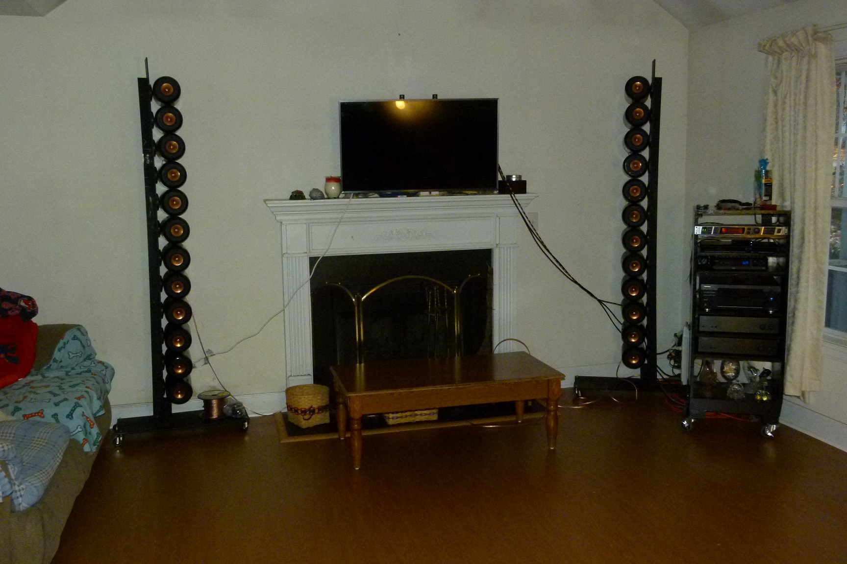

Here's the typical listening position: drivers about 9ft apart, with the option to move the couch and left tower 3ft to the left. The listening position centered about 15ft away with ears level from the 5th speaker from the bottom.
More cable management coming.

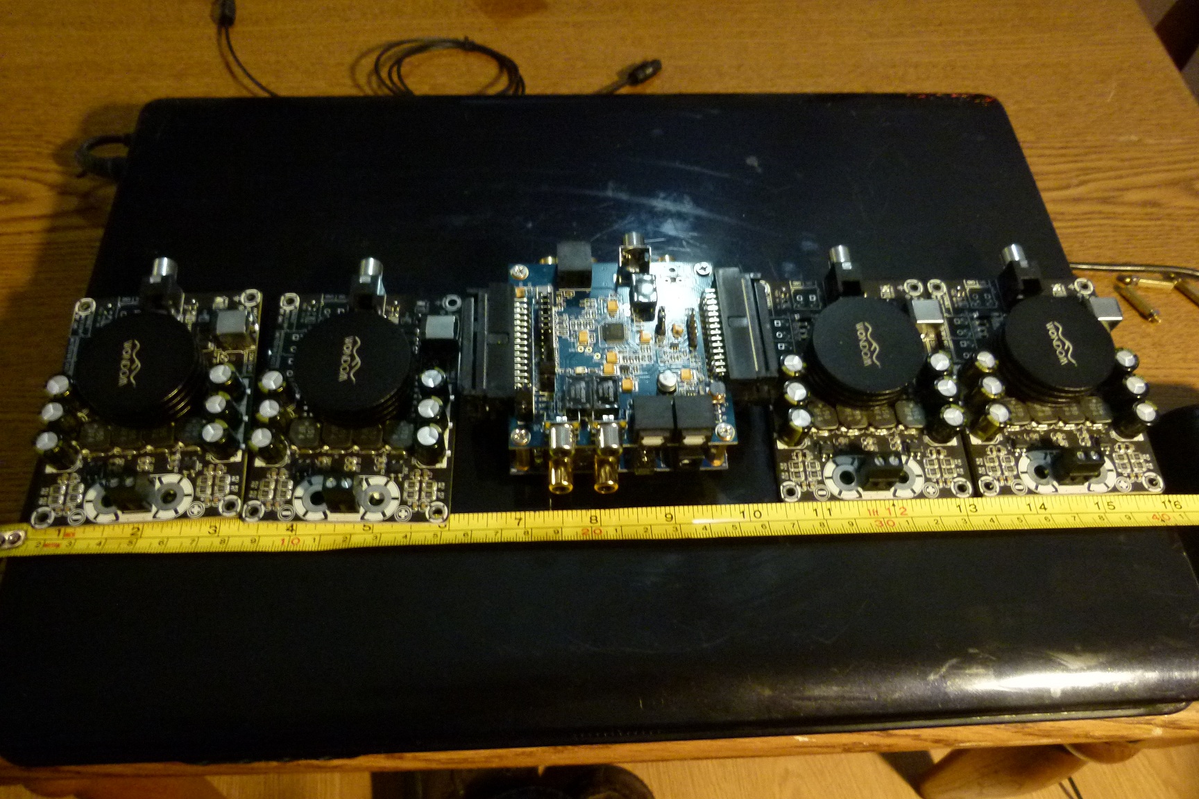

I think I've finally settled on the miniDSP 2in x 4out kit + miniDIGI. The miniDIGI will allow full digital I/O with the miniDSP2x4 programmed with the 31-band GEQ. This plug-in is only $10US! and can do so much more including delay in .02ms increments per channel.
Keeping 12 drivers per side, I would only need 3 of these combo's per side + the class D amp w/optical in. Still have to research that one. So far this part of the project is not overtly expensive, so I can build it up over time. About $350 per side, not including power supplies or USB communications...
So programming these things is going to be the challenge. I might try to make the USB wireless somehow with a wireless hub if this is even possible...
Well, you have to scratch some things with that setup. The EQ has to be the same for all drivers or, if you have something reflecting nasty on the left/right you cannot move, you'll only need 2 different EQs per side. You don't need an amp for each driver but that's not an issue because of the cheap amplifier boards. But it's really a waste of time and money to give each driver one DSP channel. Even a CBT does not need a dsp for each driver, 3 or 2 drivers per channel is really enough. If you want more, sure, go for it, but you don't get any advantage out of it.
You got a different problem though, your drivers are too far apart. They should be as close as possible together to avoid comb filter effects - because that's something you can't correct with a DSP.
I'd suggest you convert the optical input to coax, that way you can distribute it much easier. Most DSPs don't have a optical input anyway.

But I can say I did choose the 5" PVC endcaps because they are rounded internally and externally. So it was a tradeoff between close drivers or 'the best' diffraction loss. The cylinder shape came 2nd to the sphere shape so I went with it, having already experimented with the rectangular box made of MDF. At that point though, I had only 8 enclosures per side. Now I have 12 per side, so 4 new drivers per side plus all new PVC enclosures. I made the mistake of changing 2 variables at one time, but I wasn't ready/willing/or able to just build 8 more MDF rectangular boxes just for (possibly) nothing..
So yes, I can say when I had these enclosures stacked straight I heard the combing effect. When I started to curve the enclosures, the combing effect started to disappear at about 4 feet away.
Onward to individual powered drivers with miniDIGI+miniDSP2x4+4x(100W mono classD TP3116). This will take take of only 4 P7's. Also ordered 3x 19 rack mount aluminum cases for placement on the steel towers.
Here's what I've got so far:

The small PVC enclosures need EQ. They're barely reaching 150Hz. Also, I've also wanted individual powered drivers. I've chosen 100W mono class D amps, so the distortion should be very low with the P7 watt max at 20W.
The miniDSP can also do alot. Only 1 is needed per 4 drivers. Each output can be individually programmed.
Gentlemen, I apologize. I had the drivers wired incorrectly. I originally thought I had a hidden short somewhere when the amp would thermal shutdown at moderate to loud volume levels. Drawing the wiring connections made me finally realize they were essentially all wired in parallel. Idiot
Now that each side is finally wired correctly, I no longer need EQ and they sound great again! 4 groups of 3 (8 ohm) speakers in parallel wired in series for about 12 ohms.
