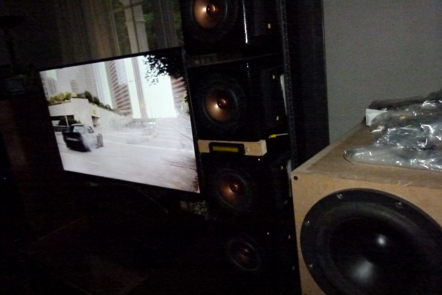

Testing new tweeters currently.
Ribbons act like mini line arrays. Mounted like you have them, the horizontal dispersion will be very limited. You will need to angle them directly towards your head which will probably make the sweet spot very narrow.
Mio
But in this case theyre only being used from 13kHz. They're definitely 'brighter'. Also 6ohms.
How about putting them on top of the array, mounted vertically, firing at the ceiling?
Or behind the arrays, vertically again, but firing backwards.
Things I'd try in this case. Unless you are sold on your present setup.
I'm not happy with it currently. It's very bright and the lobing effect is back, like when I had the Pluvia's stacked straight with no tweeter. I'll try mounting these tweeters vertically next and maybe a 1.5uF cap instead of a 2.0uF.

Mounting the these planar tweeters vertically gave a very small sweet spot. Moving head up or down made the highs disappear quickly. Googled planar/ribbon tweeters and found this was to be expected. Oh well, they were cheap. Going back to the Dayton AMT's and just going to enjoy the system for awhile.

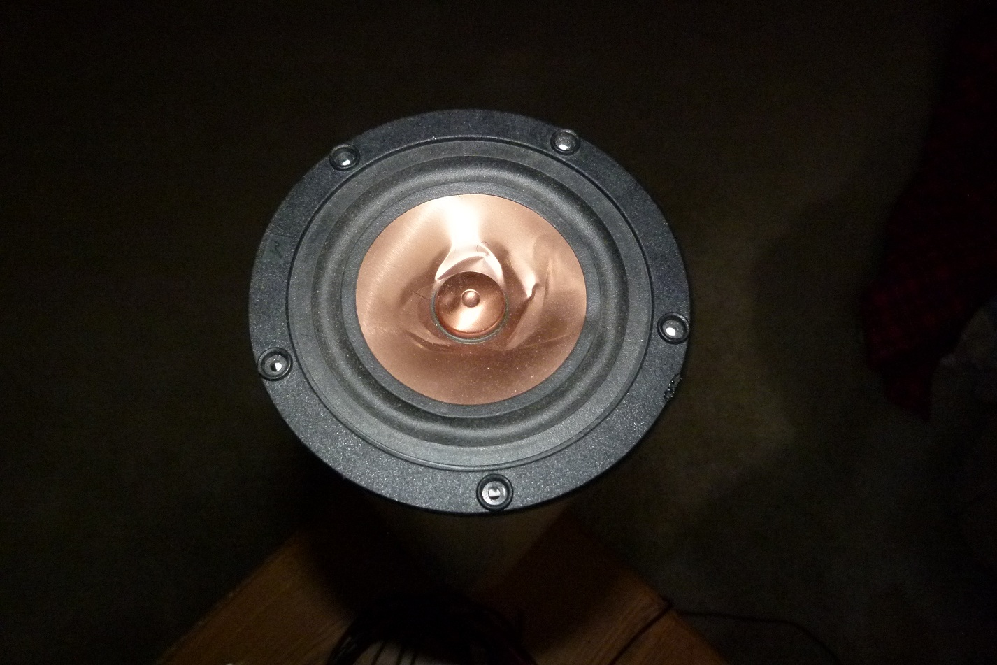

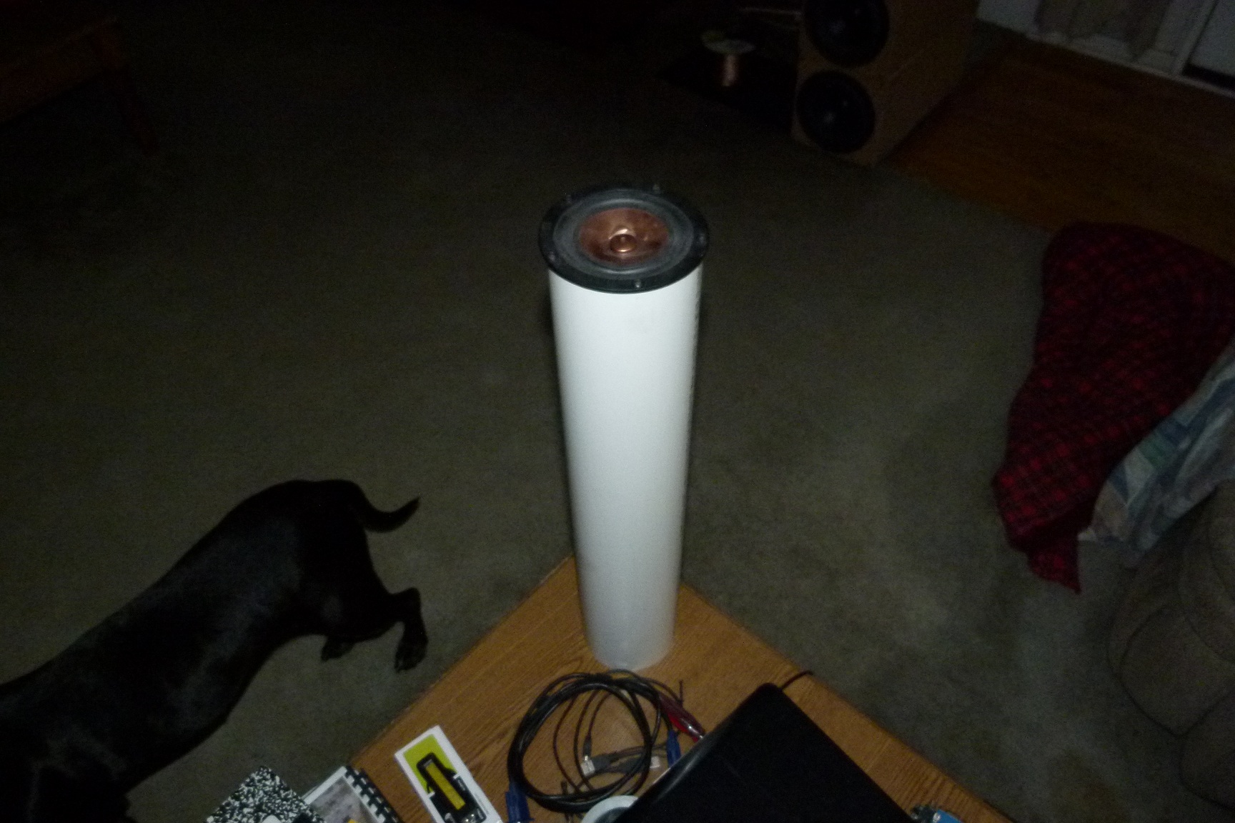

I decided not to dive in and get all the parts. Since I'm at least going to add 4 more P7's, it makes sense to get the 4xP7's and 4 PVC enclosures and do a listening test with a breaking in period for the P7s of course. It was only $50US for 4xPVC enclosures.
So for each enclosure I'll be using 2 Ft long 4" white PVC (I was eyeing more expensive black ABS), a 4" cap for the rear and a fem-fem coupler for the front. Once I cut each coupler in half, hopefully it will slide right over the front, it will bring the width out to 5".
Here's why I need the fem-fem coupler in order to properly mount the P7. It's function is to expand the mounting surface to 5". Sorry for my imperial measurement spec's AND the terrible pics... BTW that is one of my damaged P7's which was my fault early on in the build, but I kept it. Thankfully so.
Nice job on the cone crinkle 🙁
You should really be looking at a 5” tube for the P7s, a whole lot harder to get than 4” thou. I used 4” for the A5s which are a 2” driver.
