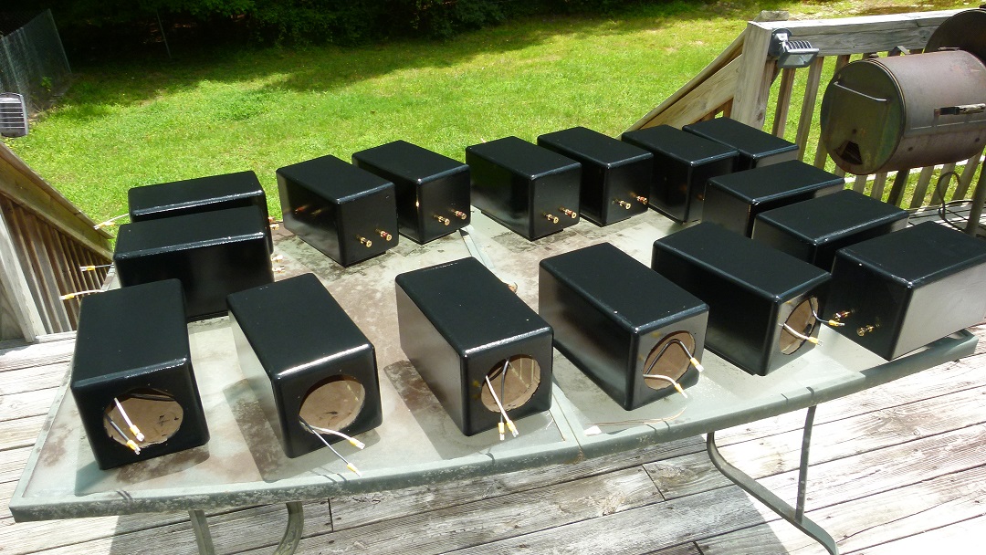

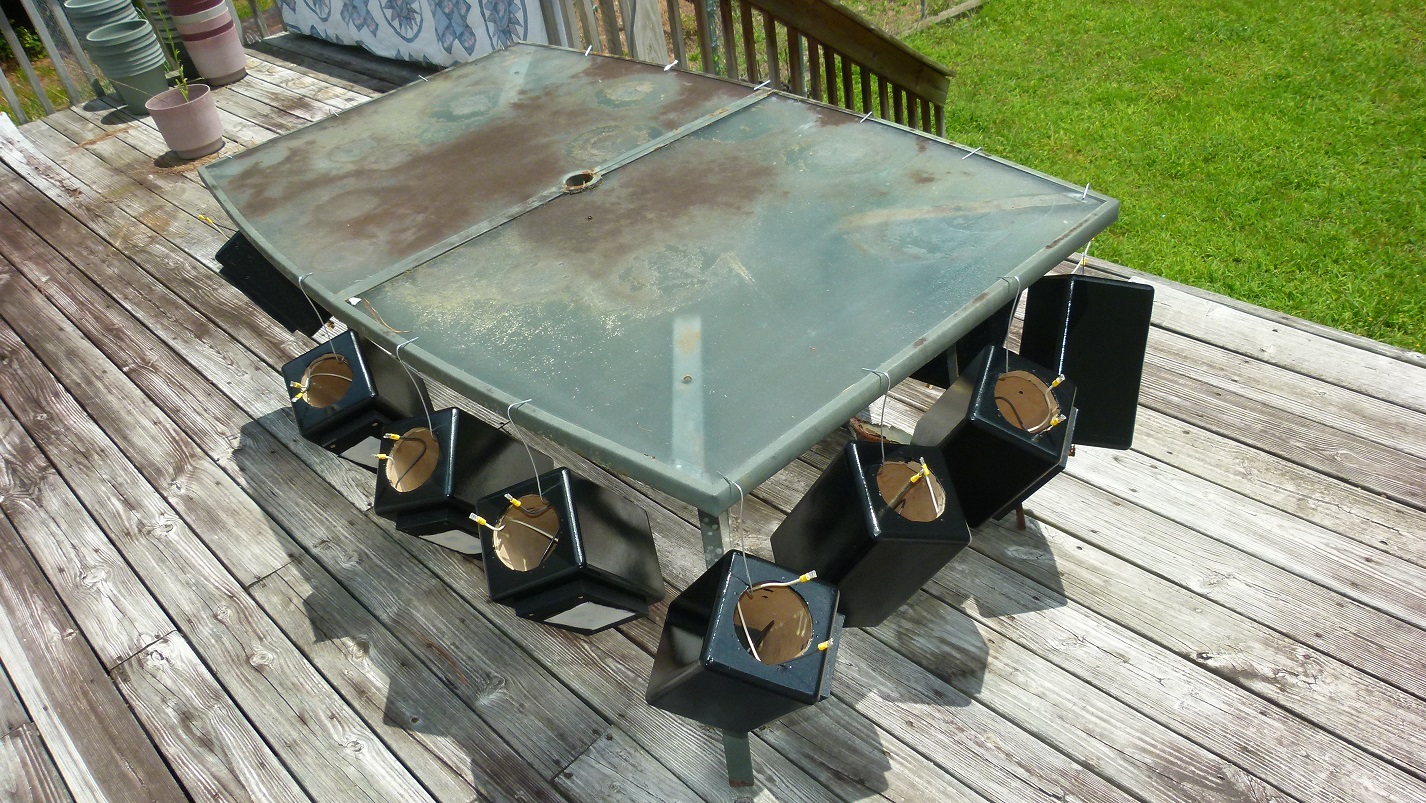

This is the 3rd coat of them baking in 92deg heat.

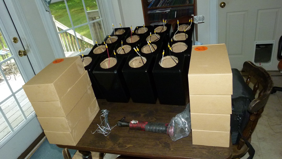

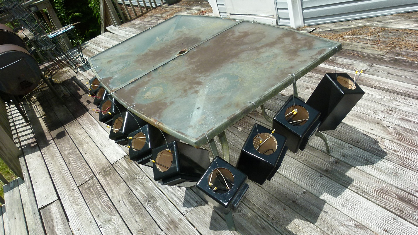

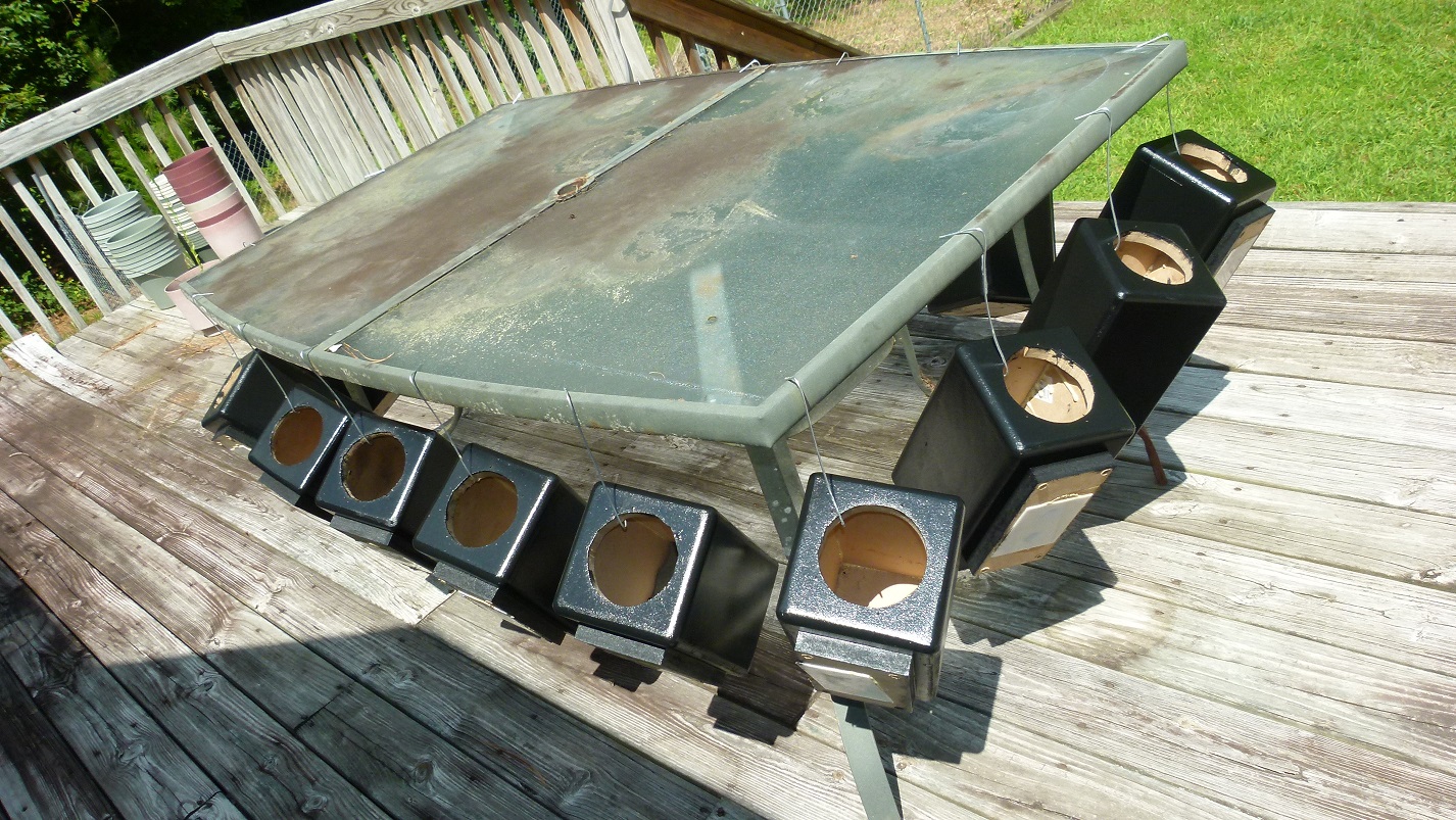

1st and probably last coat of polyurethane. I'm tired of painting 16 boxes. They've been baking a good 4 hrs so far in 85 degree heat. The black really seems to accelerate the drying process in the sun.
Already wired and 'stuffed'. Last step is to install the MA Pluvia 7 drivers. I hope to get that done today, although I am redoing my entire entertainment system today as well looking forward to listening to this system!

Inside, cooling. Nice hard finish from a single layer of polyurethane. If I was a real man, I'd have enough patience for 2 more layers of polyurethane... As it stands, I'm ready to install the MA drivers.

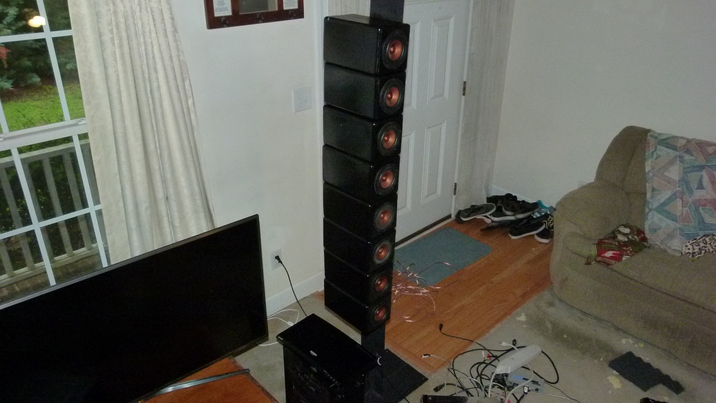

I should have a first listening test today. I installed all the drivers. The newest ones I mounted on the very top and very bottom of both sides.
1 driver got damaged during the prototype(3rd up on the left). I still have it hooked up so I can listen, the cone still moves freely, amazingly enough! I'm ordering 1 more today.
When mounting the MA drivers I took great care not to overtighten the mounting screws. When I was assembling the first box, I noticed that the frame was flexing if I overtightened the screws with the insulation in between the driver and the box. For the prototypes, I opted not to use the insulation in order to save them for the final construct.
Overall, there are alot of imperfections my eyes see, maybe the pics reveal them too... 1) boxes don't line up perfectly, 2) towers are arched from welding/heating, 3) box construction not so uniform, 4) paint very revealing of imperfections (MDF). But at least I don't think they're an eyesore, and this project should provide a great vehicle for experimentation.

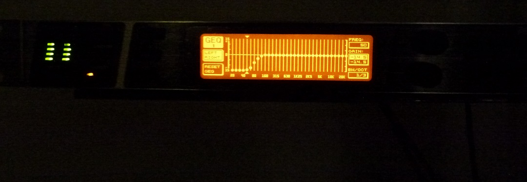

Second most drastic change from the prototype (possibly MOST important!), I gambled and changed from the original vented box of .5cuft to a sealed box of half the volume. I did this because I wanted to save these poor small drivers from approaching xmax, hence the active crossover DEQ2496 and the smaller sealed boxes. I'm cutting off at 100Hz

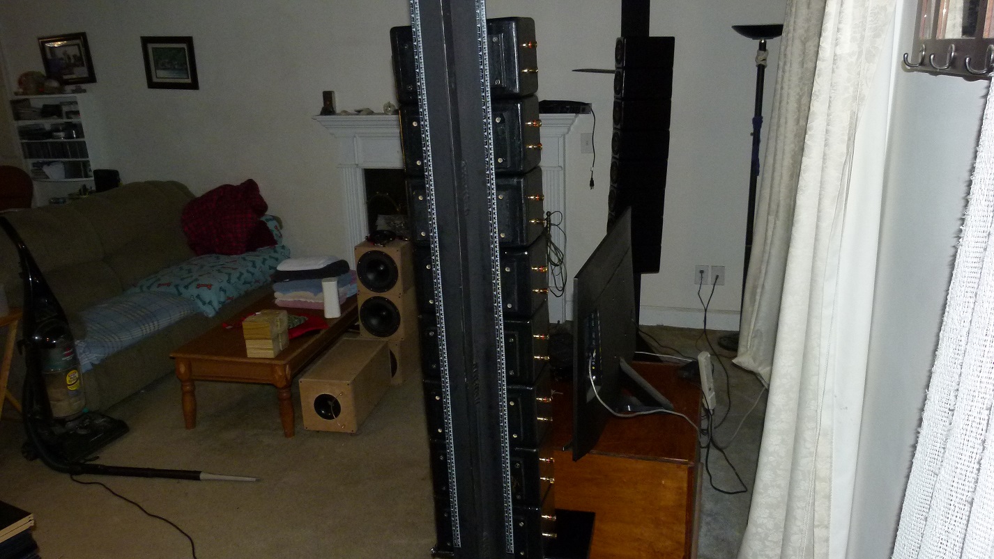

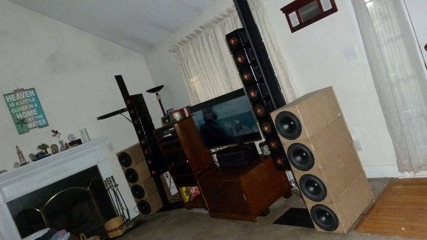

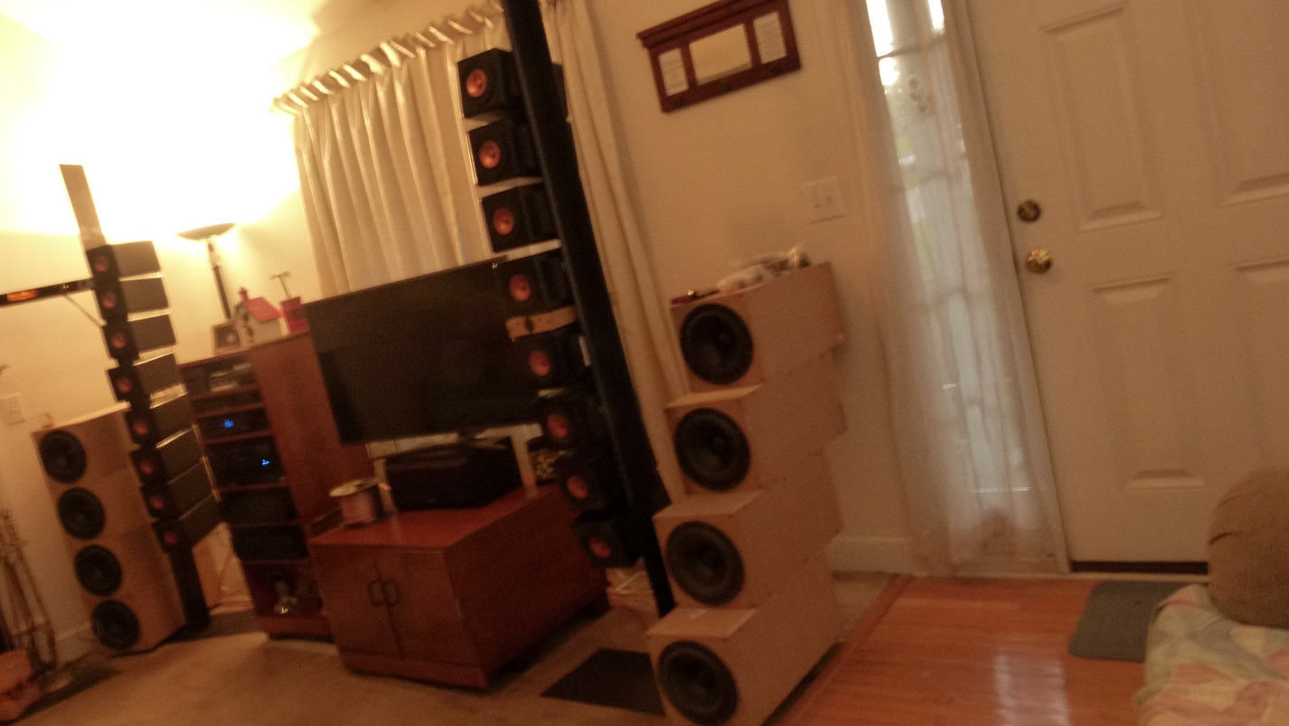

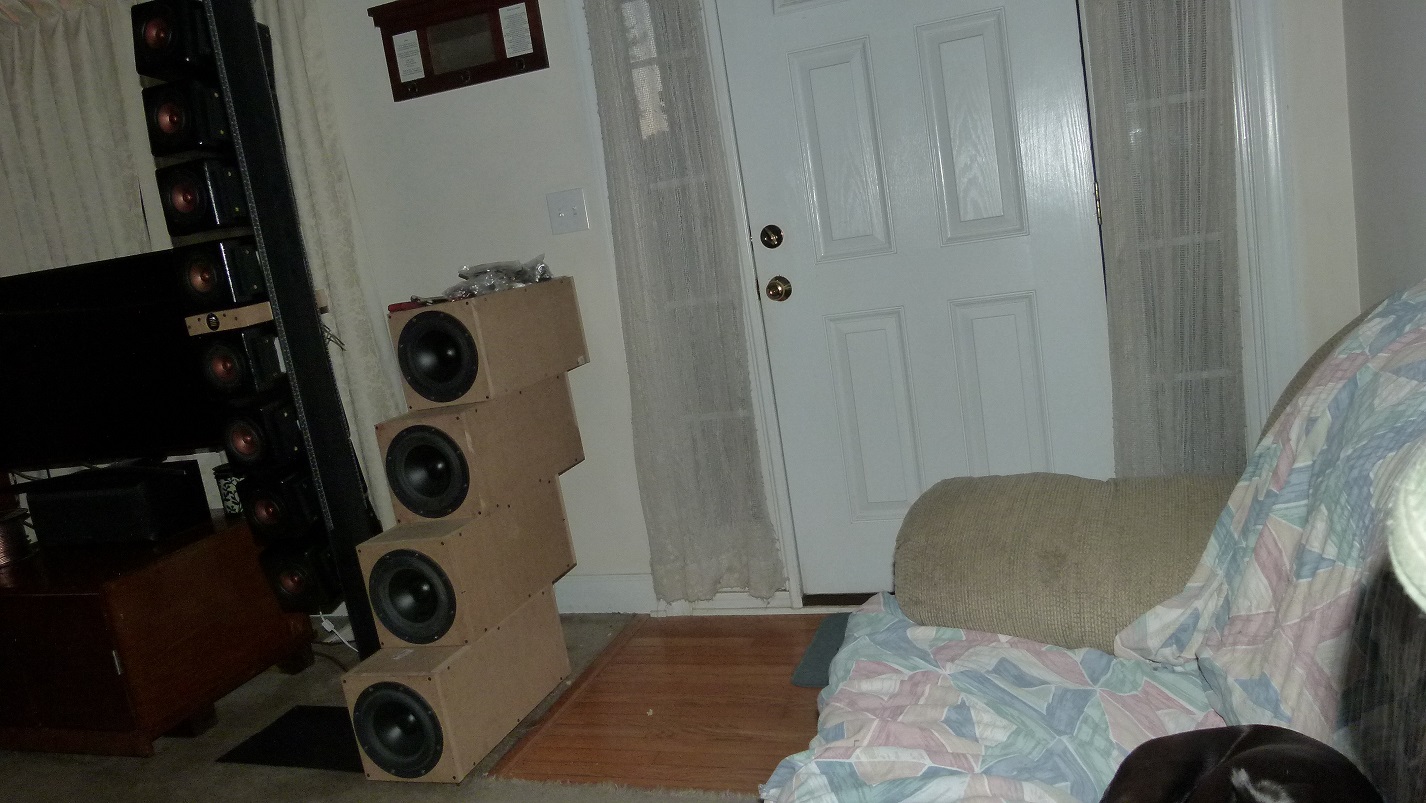

This setup is sounding awesome on the right side! Sorry for the bad pics. Also subs are not working yet. AMT Tweeter is hooked up. EQ is bypassed. Base is at least down to almost 100Hz F3 with these .15cu.ft. sealed enclosures.
Pink Floyd guitar sounds awesome in Wish You Were Here.
Working on the left side now.

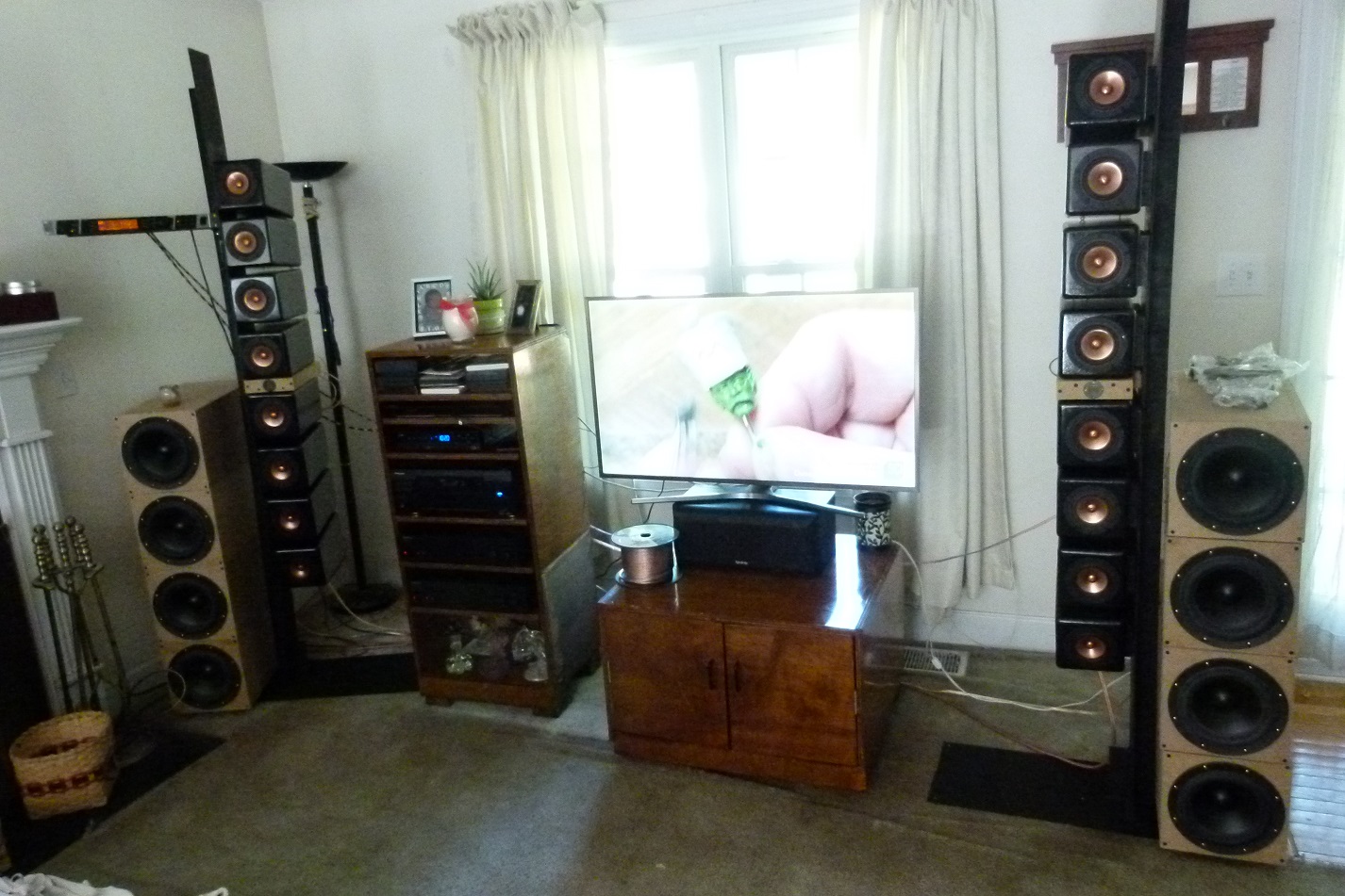

Finally got the subs working! I had a bad audio cable I custom made...
Also, hooked up the unpainted AMT tweeters.
As far as I can tell, the lobing is gone and off axis response left to right is excellent. Off axis response for these Pluvia's are not provided for some reason.
This is the setup I'll be listening to for awhile and today I can start testing FR with REW.
Just a few comments:
1) The amp powering the Pluvias and tweeters is a Pioneer VSX812. It has the ability to provide a 100Hz, 150Hz, or 200Hz crossover to the subs and Pluvias. I had forgotten about this and have it correctly programmed now. It only has 1 mono sub output I use for both channels.
2) The amp powering the upper 2 subwoofers on the L & R is an Audiosource Amp3. The output is set too about 75%. The amp powering the 2 lower subwoofers on the L & R is another Audiosource Amp3. That output is set to 100% since the bass is deeper as they sit on the floor.
3) The DEQ2496 isn't really even needed now, but I do use the expander function for some things I listen too. I will be using it to try to achieve a flat frequency response and see how much I like how how the speakers sound EQ'd.
