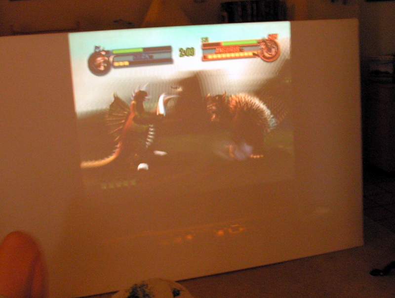

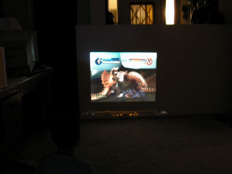

Yes, I took apart my overhead Projector. I built it for my kids Xbox - maybe 4 -5 hrs a week of play. I didn't feel the need to go crazy on the bulb.

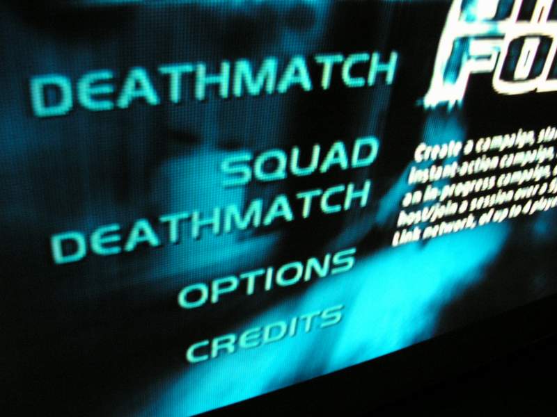

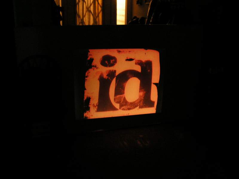

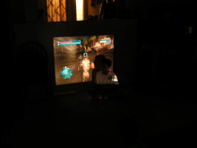

You know one thing I'm really surprised at is how good the image quailty is. It's pretty wicked - my kids say. The best thing about it is that it's portable and can be taken outside or to a friends house.
P.S. I really believe that coating the inside of the case black really does improve image quallity due to the fact that you don't have stray reflective light.
