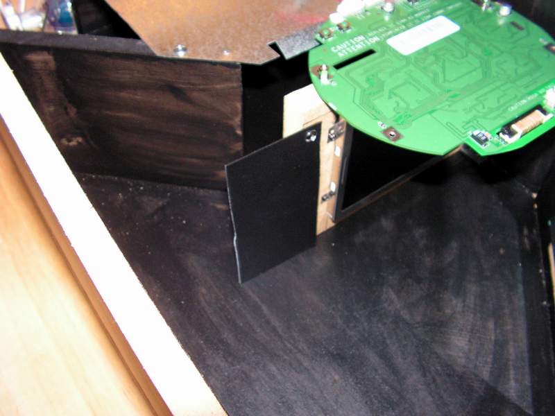

The exact measurements are 21"x12"x7.25" . This is the entire exterior measurements. I used 5/8 MDF board for the base and top and used 1/2 MDF board for all the sides and interior. Everything was wood glued together. I will be bracing the exterior soon.
just wondering if you could post a pic or two showing the light engine side of the projector. curious about the dtail there. I'm also confused as the images of the pj on show light comming from the fan near the lense but the interior shot shows a light blocking piece of wood.
Also am I right in assuming you have no condenser lense in your setup? just lamp > fresnel > lcd > frensel > pj lense (ommiting of course the mirrors)? I have a condenser in mine and it appears to be projecting the actual reflector pattern. I'm wondering if that is the cause. Thanks in advance.
Hi, I will try and take some more photos of the light engine soon. You are correct, I am only using the bulb - mirror - two fresnels (facing each other) - screen - FS mirror and Lens. The wattage on the bulb is 310w 82v - it was a complete strip down of my my apollo overhead projector. Also, i haven't done any mods of any kind. All my photos were taken using the RCA Jack. The Images are Amazing. I'm pretty proud of my little gadget. 😀
More Pictures
Just added more detailed photos of my setup. Dissident75, abolutely right, I did have an issue with light spillage. I hosnestly believe that stray light can destroy a quailty image and killing it is the only way. I am a big believer in painting the interior black to block reflections. If you notice, I place a black piece of metal on the side of the Screen this has helped tremedously in blocking light from my focus beam and coming out of the side fan.

Thanks for the reply, nice job on the pics and pj. I've been doing a bunch of thinking about my design and i am going to drop my condenser, shame though, it looks nice there 😉. I hope my results are as good as yours appear to be.
Are you satisfied with the size of the resulting projection? I'm expecting a result of somewhere on the order of 6.5 - 7 feet diagonal at 10 feet. Of course i am using a different lense. With the brightness of your setup do you think it will scale well up to that size and still be bright enough to give a decent picture? Do you think brightness would be an issue going to that size or should i rethink my goals?
My sincerest apologies - I meant to put the bulb rating at 360w 82v (it's your standard ENX bulb). :ashamed: I feal like any idiot.
Dissident75, I tell you what. With my LCD screen, I wouldn't go bigger than 60 inches. The pixels start to get to big for my taste. I mean I could and it's still bretty bright, but the resolution degrades. Maybe with a 640 x 480 panel.
