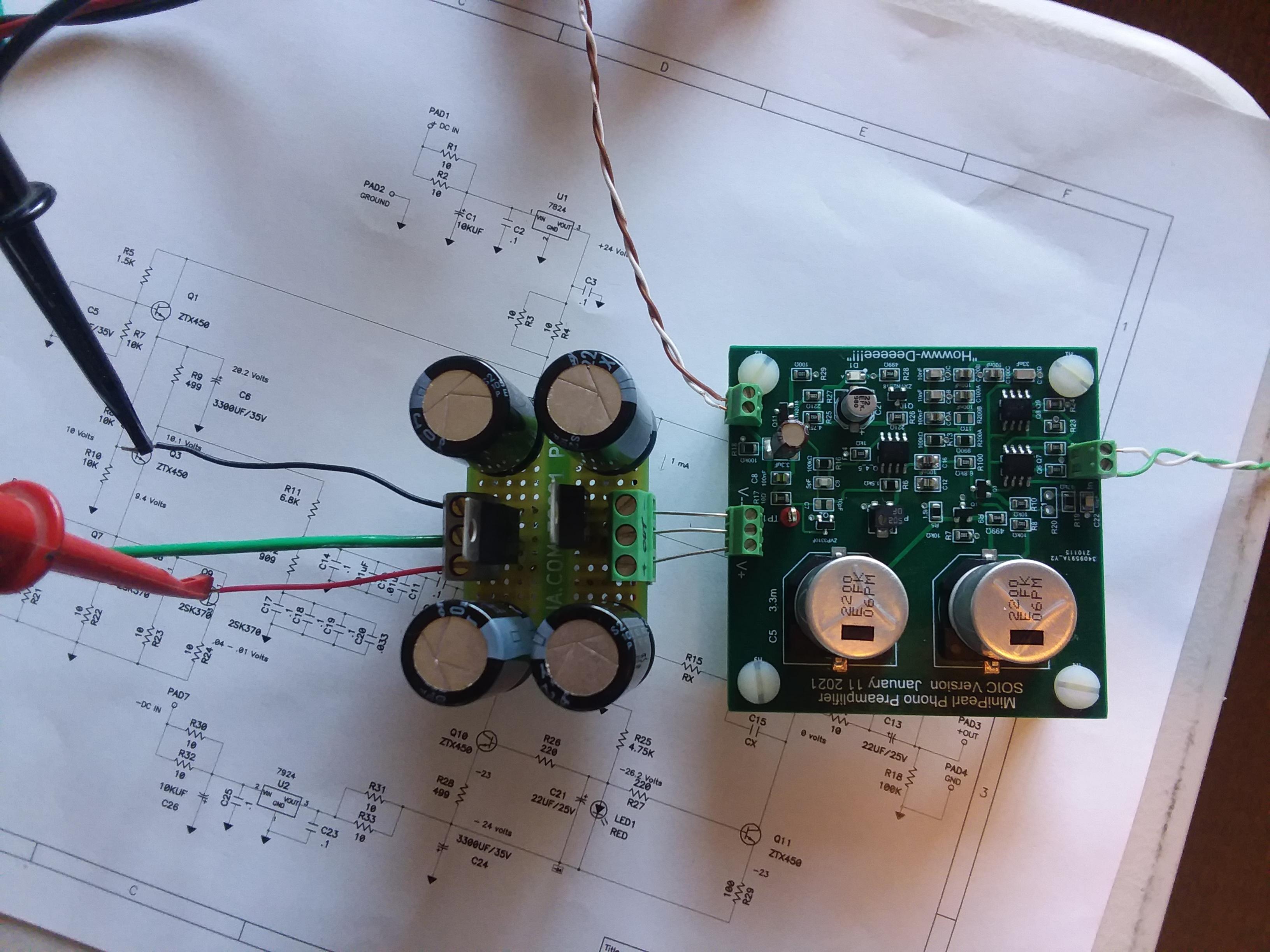

After reading my post I don't think my question was very clear, so let me try again.
The phono preamp ground, on the PCB, should be connected to chassis along with the turntable ground. My question is where the chassis ground should be connected to the PCB ground. The ground points on the the Mini Pearl PCB are limited because the ground plane is an inner layer.
The convenient ground connections are the input, output, regulator filter capacitors and power ground?
Try them all and report back. This is DIY.

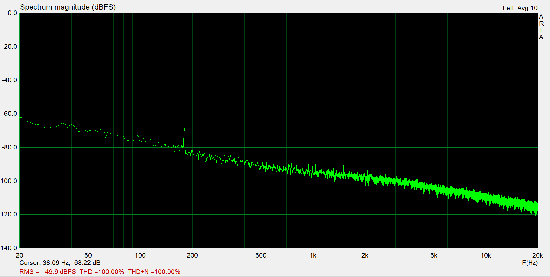

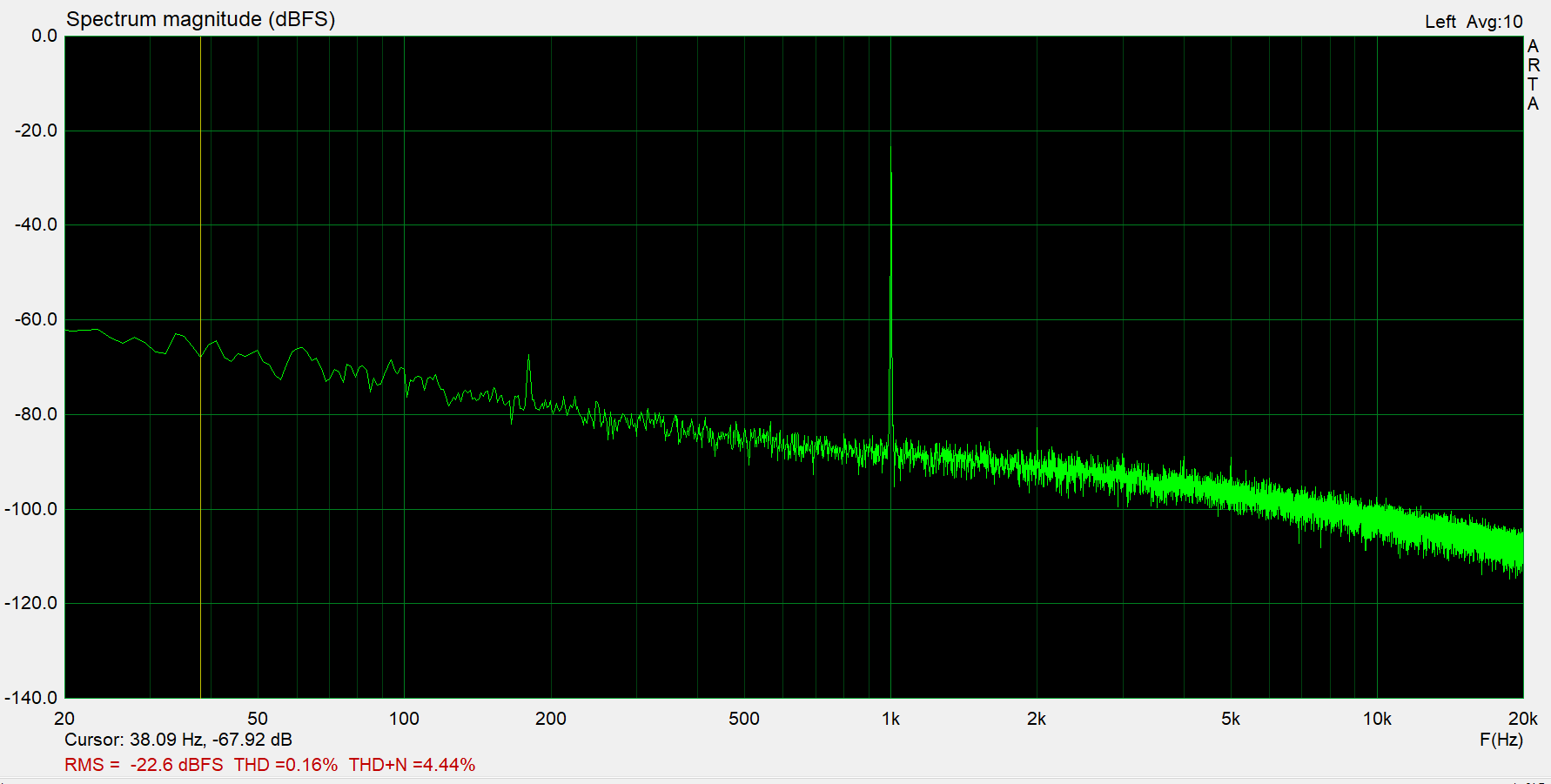

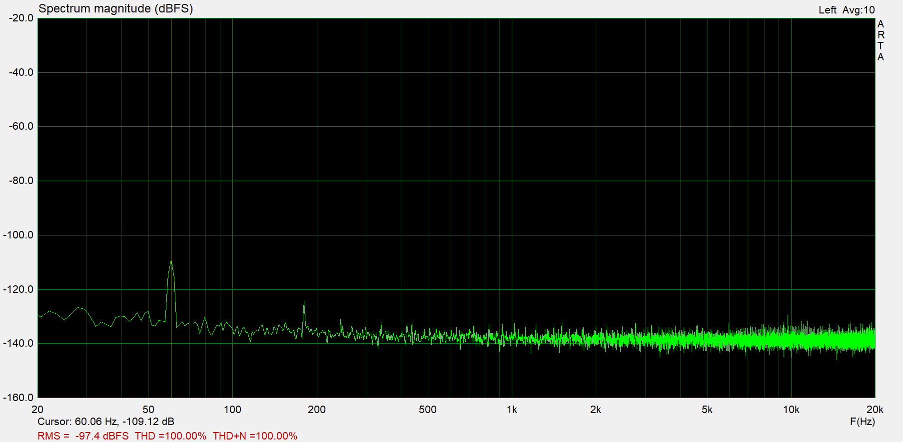

Completed my Mini Pearl SOIC boards. Measurements are with the boards on the bench and power connections made with clip leads.
Soundcard interface loopback
Mini Pearl noise
Mini Pearl 2mV input
The output was 590 mV, so about 49 dB gain

Made some RIAA measurements and the curve was within 0.15 dB across the audio band, 20 to 20K Hz reference to 1KHz.
Hooked up the turntable and had a listen. Surprisingly very little hum with clip leads and laying out on the work bench, so that is promising for when all is in the enclosure.
