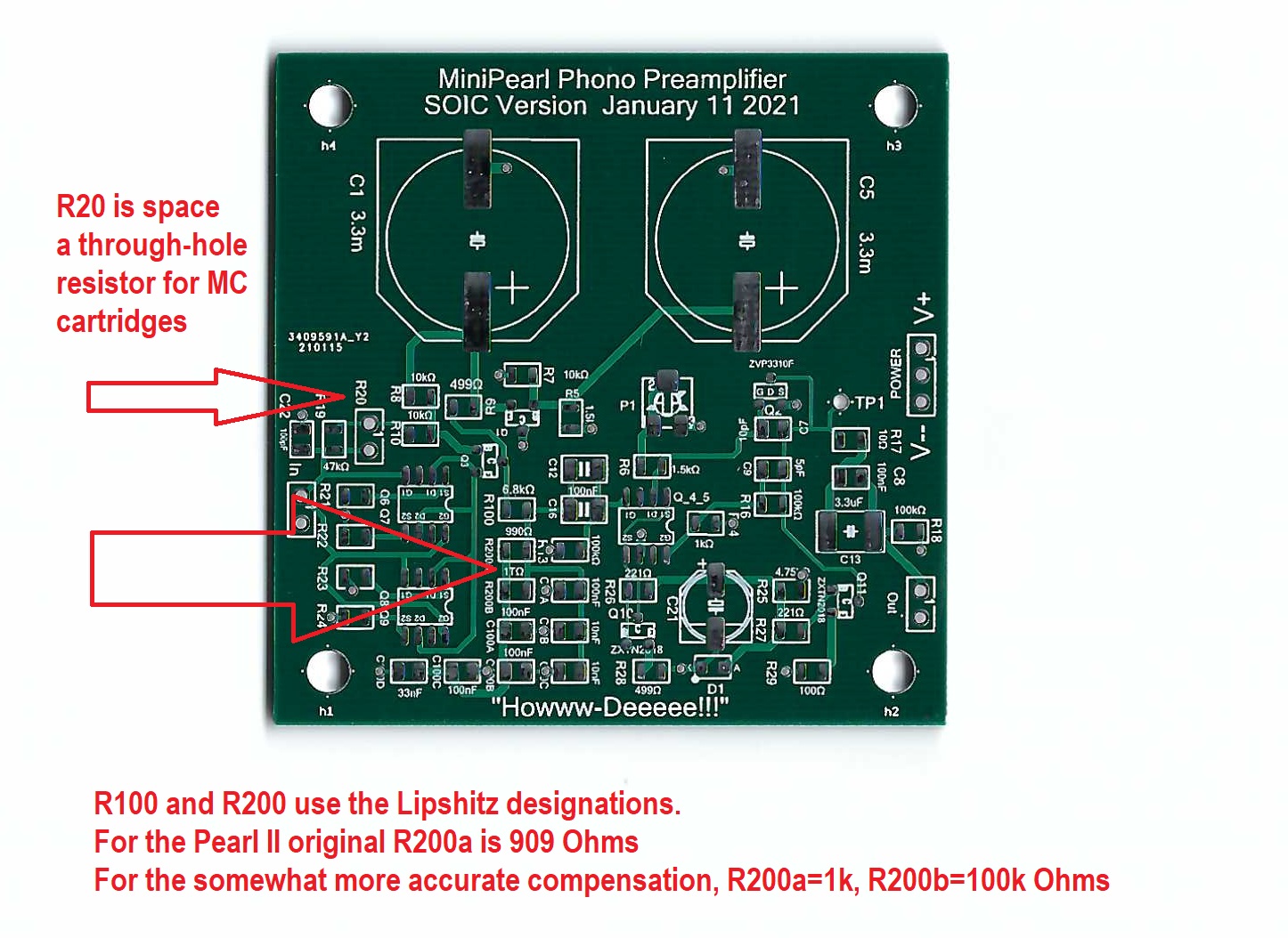

Note that in SMT-land we're not dealing with precision caps (resistors are always 1% or better) so to trim the passive RIAA I "tack solder" two pieces of #24 AWG wire onto the pads and play around with the values until I get a reasonably close fit.
The LF is going to fall off more sharply than "flat" -- (and a good thing to!) but you can remedy this if you like by using 1uF coupling cap for the gate of Q4.
I used the designations from the Lipshitz article, here R100=6.8k or 6.81k and R200 = 909 or 990 ohms. You will note that I have allowed use of 1k||100k as R200a||R200b.
Also -- a 0.100" provision for R20 which can be a through-hole resistor for loading MC carts.

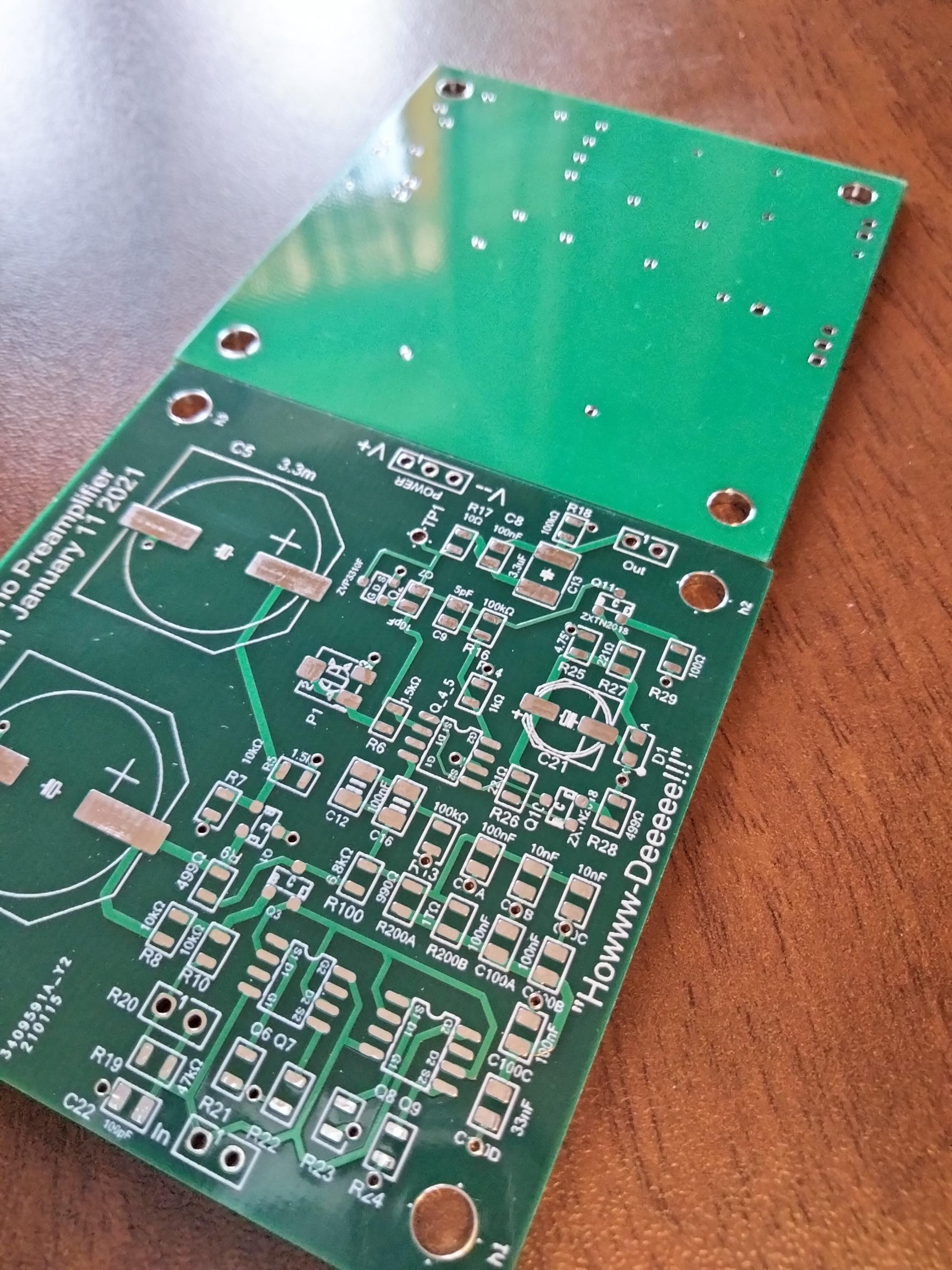

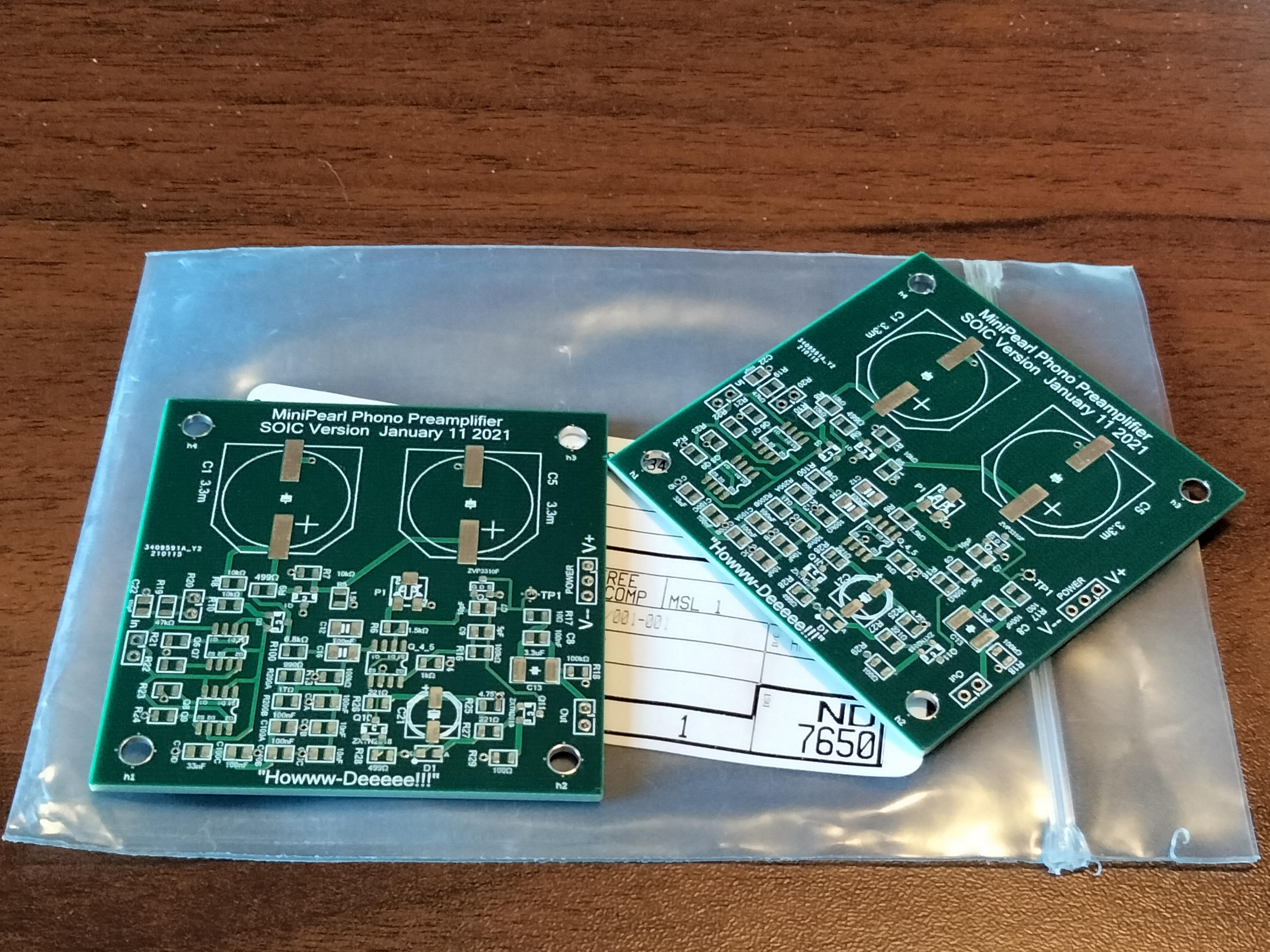

Got a pair of the SOT23 boards, they look great, thanks!
I don't have much experience with surface mount devices, but I'm using this project to learn something.
