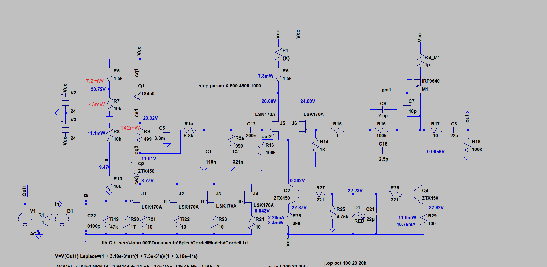

Resistor dissipation
R9, 499 Ohms - could be problematic if you use 0.100 Watt device.

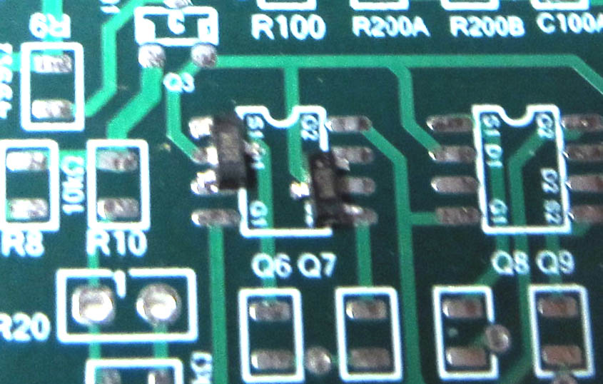

As Patrick (EUVL) has stated, Source and Drain of the 2SK209 are interchangeable. In the space allotted for the SOIC devices you can fit two of the 2SK209 or LSK170A. Note that two of the pads of the SOIC devices are are unconnected so you can jury-rig a connection. Sorry for the poor resolution:

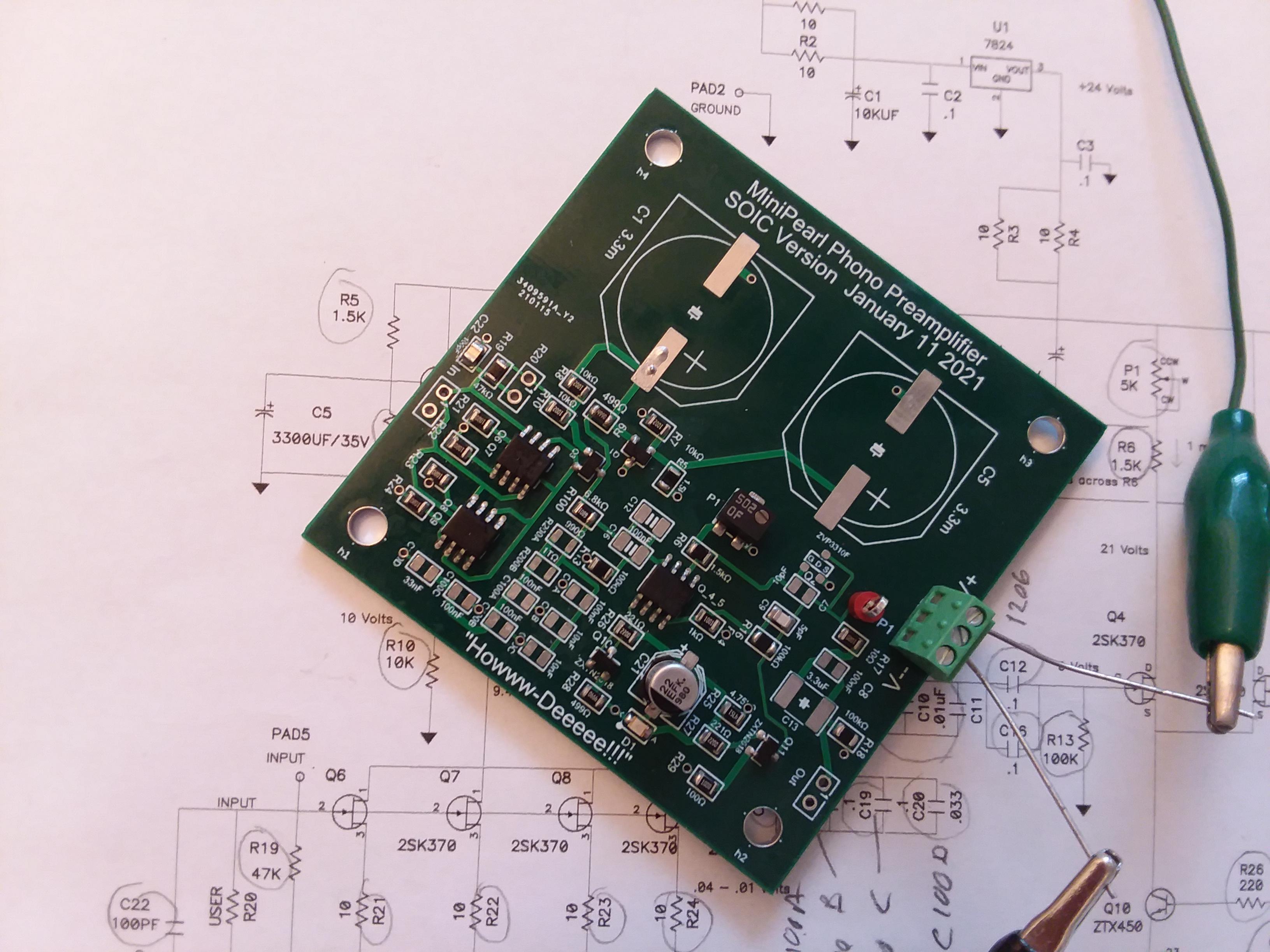

Ordered six of the Linear LSK389A SOIC JFETs from NAC to populate the two SOIC boards. I was able to get good matching within the six that I received. With the 10 ohm degeneration resistors the bias currents for the front end were 3.3 and 3.4 ma. Each JFET in the dual package measured within 0.1 ma.
The wattage on R9 ,the 499 ohm resistor is about 90 mW, good for 1/8 watt resistor.
