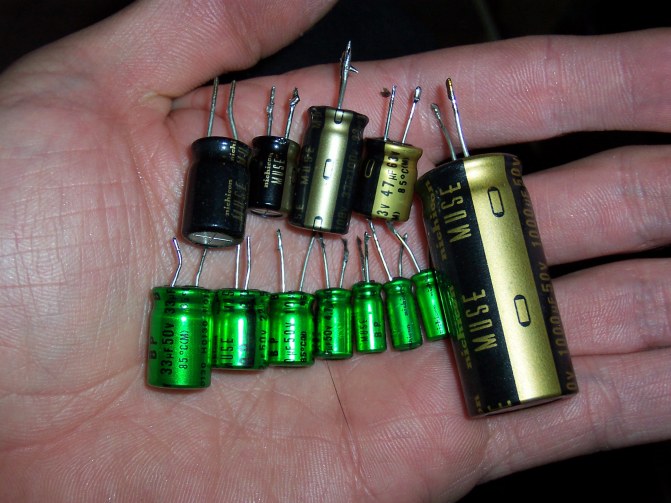

danielwritesbac said:. . . and powerful Nichicon ES too? How unexpected, and, its inspiring as well.
Those are Nichicon Muse caps kindly donated to the cause by motherone along with some LM1875s in exchange for some boards 🙂
BWRX said:Those are Nichicon Muse caps kindly donated to the cause by motherone along with some LM1875s in exchange for some boards 🙂
There's a trick with those. I make a "sharpie" marker stripe on the short-pin side before installation.
Similar Nichicon Muse series caps worthy of interview:
(you already have ES-220)

Yes, the ES caps are an unusual choice on first glance. You'll also find Blackgate "N" on some of the AudioSector rectifiers.
Fortunately, polarity on the Nichicon Muse ES (actually an NP) is same as polarized--short pin is negative. Unfortunately, you'll have to mark the stripe yourself, before you trim the pins.

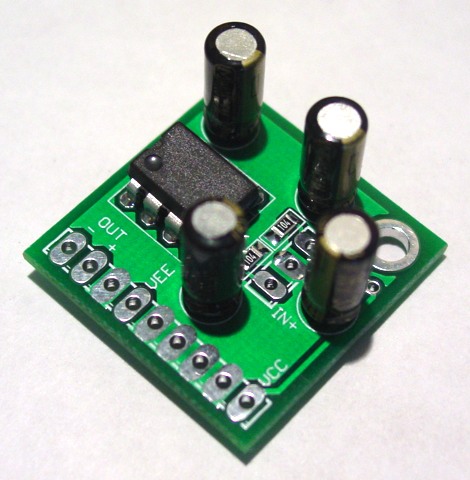

danielwritesbac said:Since Muse ES is shown here: http://www.diyaudio.com/forums/attachment.php?s=&postid=1487511&stamp=1208537188
Just for clarification, those caps in the picture are Nichicon Muse BP.
danielwritesbac said:I see that Brian has specified a 25v cap. That worried me. Now I see that he is test driving some Nichicon. I'm no longer worried.
I said that Nichicon Muse was an inspired choice because, although I have used smaller 4.7uF and 10uF ES for rectifier filters (similar to the way that Peter Daniels uses the "N" Blackgates), I had never thought of using them as Brian has pictured above.
Let me make it clear that I only "dry fitted" those caps on the board because they're the right size, I had them on my desk, and I wanted to see if the footprints for the capacitors was correct! I do not intend to use the Nichicon Muse caps on the supply rails by the chip. I will use 35V rated caps because I plan on using 25V rails. The cap voltage ratings should be determined by what voltages you plan on using, simple as that.
You could use nonpolarized caps on the supply rails, but I don't really see why you'd want to. If you think it will make it sound better then go for it. I plan on using 220uF, 330uF, or 470uF 35V Panasonic FMs on the supply rails.
BWRX said:If you think it will make it sound better then go for it.

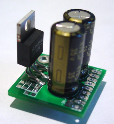

Also, a question--does the board contain space for an NFB cap (works without a preamp) or is the dc offset managed by varying the NFB resistors instead, so there's no cap in the NFB (as typically used with a preamp)?
I use the Panasonic FM caps in my LM3875 amps and have no complaints. They're great caps at a good price.
The board doesn't have provisions for a DC blocking cap in the feedback loop, but you could cut the input trace, scrape away some solder mask, and solder a cap in there if you really wanted to. If you need DC blocking you can use an off-board coupling cap on the input.

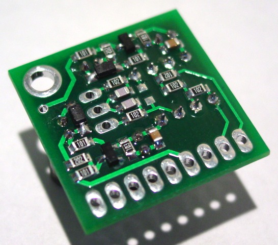

I didn't recognize the schematic on the right side, but if I guessed, by the looks of transistors and voltage divider, I'd think that it lowers and buffers voltage--can power the preamp from the same supply as the amp. Is that right?
You must be a magician to get such a big schematic down to a 1" board.
Or maybe you have one of these?:
Yep, that circuit off to the right is one of the simplest ways to make a regulated supply. In this case, it is meant to regulate down the LM1875 supply voltages for the small op amp.
No shrink ray was necessary, just the use of SMDs and plenty of time working in the layout editor 😉
BWRX said:Yep, that circuit off to the right is one of the simplest ways to make a regulated supply. In this case, it is meant to regulate down the LM1875 supply voltages for the small op amp.
Bravo!! That design is so impressive.
Hey Brian,BWRX said:Yep, that circuit off to the right is one of the simplest ways to make a regulated supply. In this case, it is meant to regulate down the LM1875 supply voltages for the small op amp.
This just popped into my head: the regulators will need to handle a pretty substantial voltage drop, no? How well will they be able to dissipate heat in this small package?
I know there won't be much current, so I'm not jumping out of my skin over this, but I have typically seen at least SOME heat sinking for regulators that will be asked to drop a significant voltage. Tell me I'm nuts on this one, and that you have done this before, or are pretty confident the parts will not overheat.
I did do a power dissipation analysis and changed some part values so that everything should be within spec for the parts I want to use.
