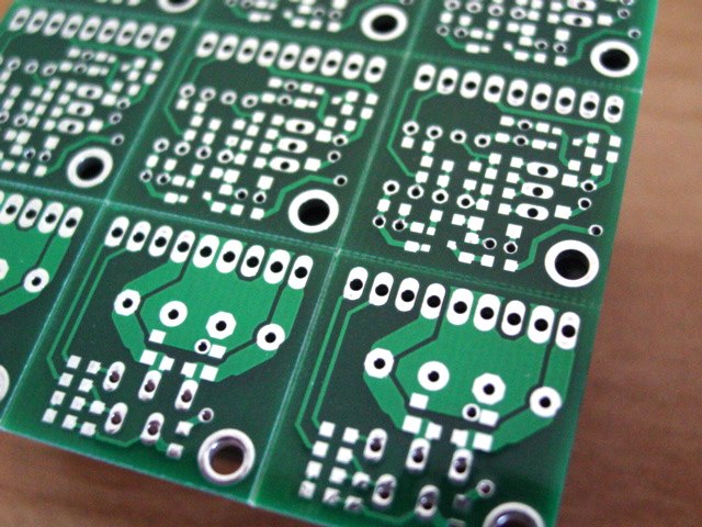

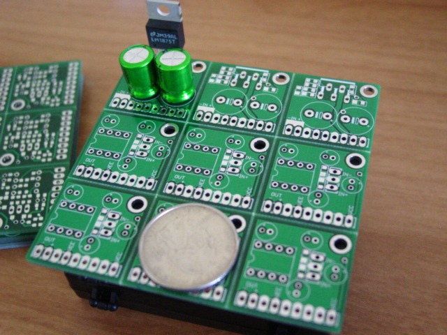

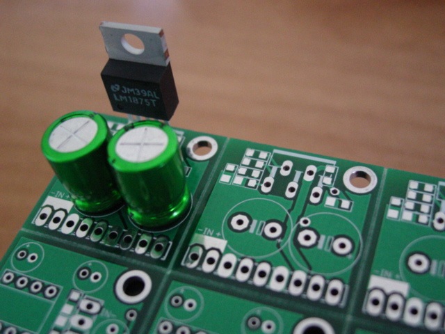

BWRX said:The boards came in the mail today. Time to get my act together and gather/order some parts.
That's a quarter on the PCB just for size reference.
Wow. WOW!!! Those boards are beautiful!
. . . and powerful Nichicon ES too? How unexpected, and, its inspiring as well.
I'm so surprised--very pleasantly surprised. Thank you!!!
