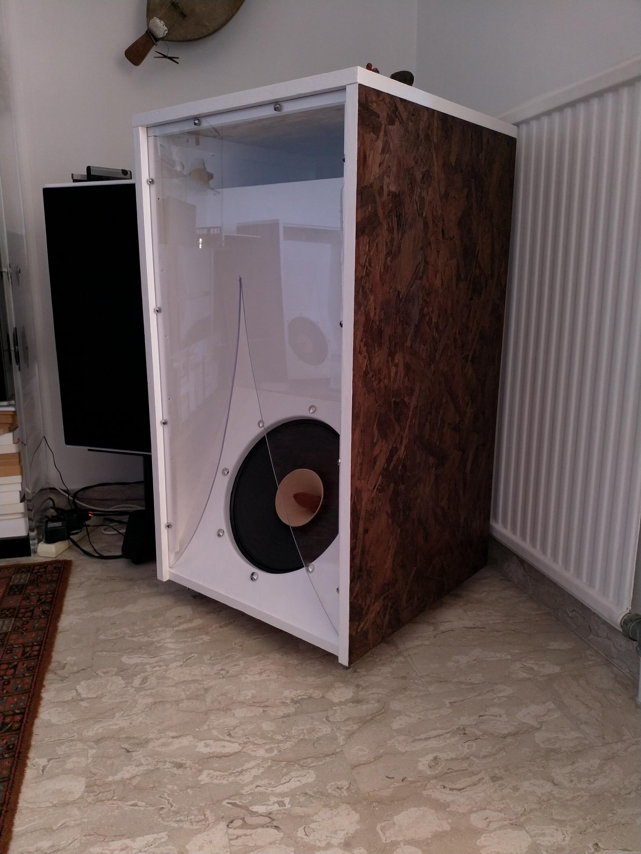

During this sad period where we all stayed at home, I took the opportunity to make what was a long plan, a big Karlsonator with the Lii F15 driver.
It is a big beast driven with a First Watt F5.
There is no damping at all, no joins, and it sound just like I hoped it would, big sound a very low level with all the details the recording provides. Moreover, there is no particular "sweet spot", you can sit anywhere or place the baffles a bit like you can if the configuration of your room isn't ideal.

With this Lii F15 I should be around 93db sensivity which is great with the FW F5. I repeat again, I believe OSB is a very interesting material for building enclosures because it heterogeneous, avoiding internal reflexions but a pain to work.

That plexiglass aperture should ameliorate some of the fears folks have about Karlson type speakers 😀

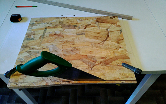

Did you cut it by handsaw ? - if by power saw, what type and teeth blade would you suggest to minimize fraying? How are the panels joined/glued?
I use osb for testing cabinets and cheap builds, some people really liked it varnished. I've found big differrences between OSB brands, check before buy. OSB3 and OSB4 grades use to looks better.
I cut osb with a circular saw with finishing blade, carbide tipped 160mm x 40 teeth. No big chipping problems in good panels. For finer cuts, try lifting the blade and move slowly.
Edge cut is always rough, I finish it with a roundover router pass.
Osb glues very well. Nothing special, just good carpenter glue D2 type (Pattex Express).

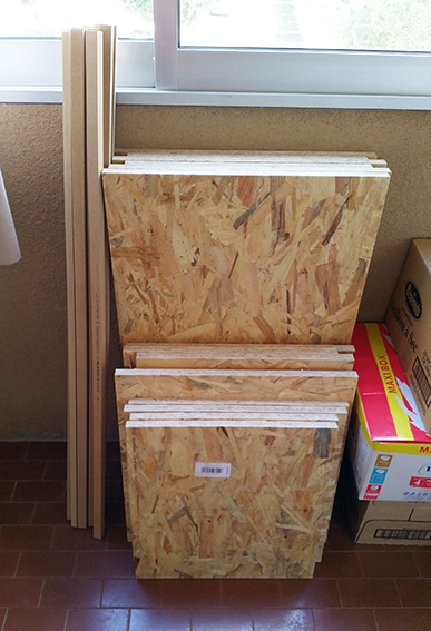

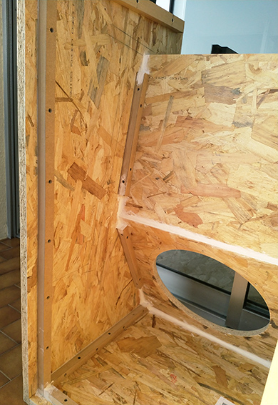

I drew every parts on paper to fit to the best the size of the sheets of OBS3 sold, and give it to the shop to cut.
OSB3 is water resistant and used for floor renovation.
I then get home with all the pieces cut.
But you know the storage is often lousy in these shops and the planks are swayed. So you always need to adjust afterwards.

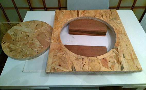

All is handsawed , any power saw makes too much vibrations for a straight cut ; don't forget it is all made on my kitchen table.

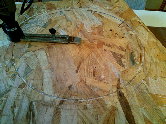

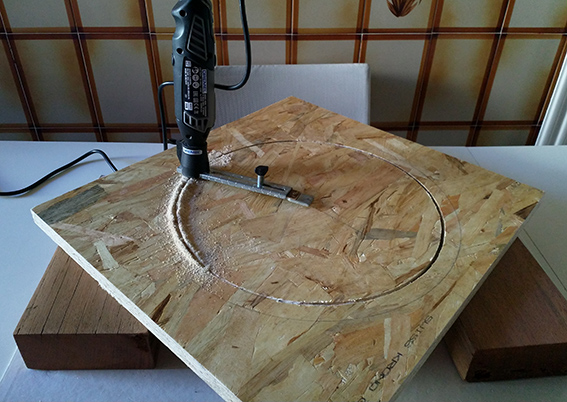

The only power tool I used was a dremmel to cut the main circular hole for the driver and of course a drill. But I had to modify it to get the right radius and made the cut in two operations. As it would cut just half the thickness of the plank, I need to flip the plank over and repeat the cut on the other side. Again due to vibrations, I had to do it slowly, it took me about 3/4 of an hour to make one cut then flip over another 3/4H.
When you live in a flat and have no dedicated space, you can't have the right tools to work.

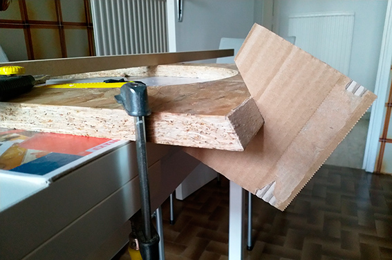

The big deal was also the chamfers, all made with wood grater, but the OSB chipped easily with this tool, so I first needed to cut the surface with a cutter to get something clean.

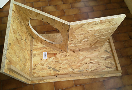

All is cleated, glued, screwed and small gaps are pasted or even injected with glue.
All the outside edges are protected with a coat of glue then a coat of paste.
The sides are tinted with two different colours then varnished with one coating only, the top and inside have one coat of pre and two coats of paint.
