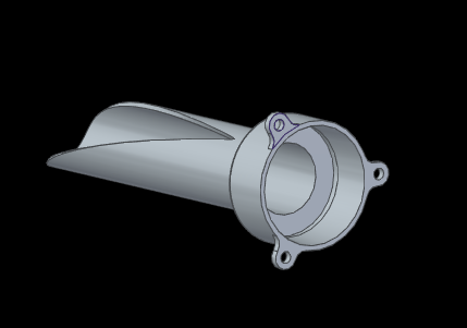

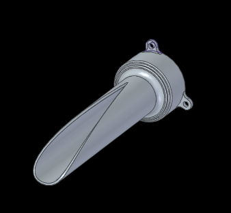

The tweeter is press-fitted in back of tube. I have attached the STL and STEP file of the one i made. The hole in the tube is the same size as the diaphragm of the tweeter.

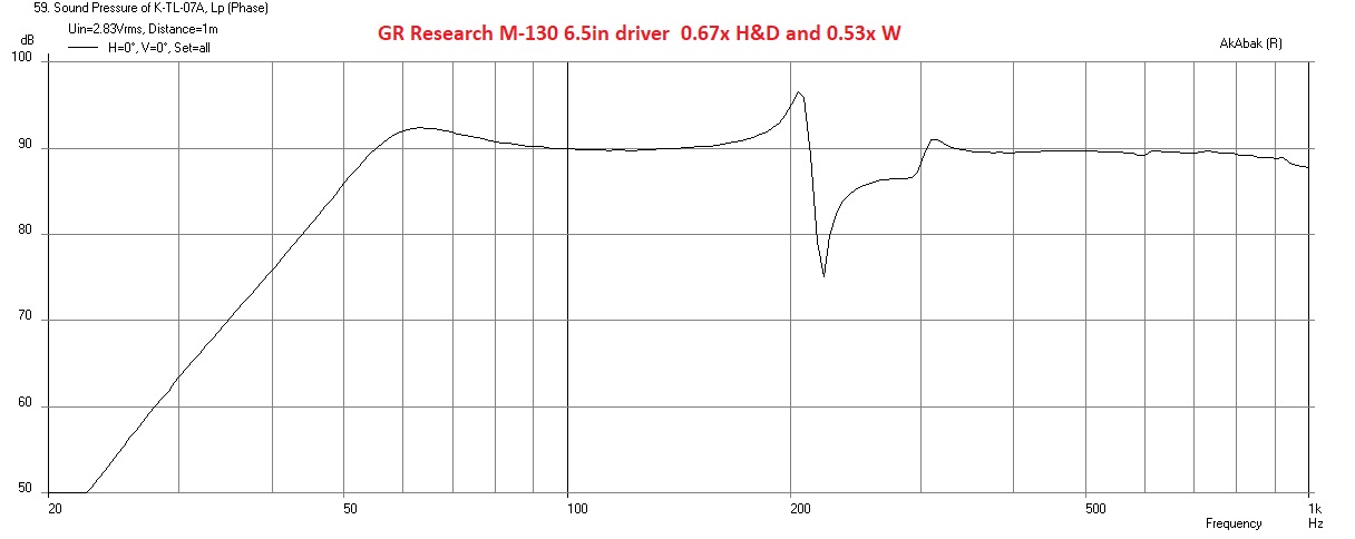

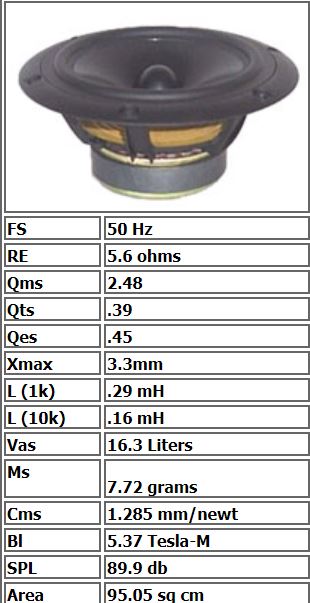

Please get me the TS parameters and I will run a simulation. They are 6.5in drivers so will have to check if bezel physically fits and if scaling gives best performance.

Here they are:
The GR Research M-130 driver needs a taller and deeper cabinet at 0.67x in H and D and 0.53x in Width. Should have -3dB of 52Hz and 90dB sensitivity.
It is not full range so you will need to cross with a tweeter somewhere.
There is a mild 2dB bump up at 62Hz, not a bad thing.
I think the slightly tall aspect ratio with a circa 20in height lends itself for a nice standmount.
Thanks a lot for your effort XRK for revealing the GR M-130's potensial. I regard the mild bump as a bonus. The dimensions are for sure within the spouse acceptance sphere.

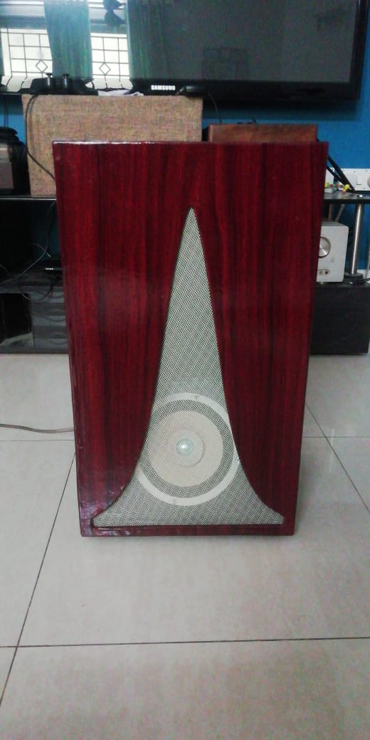

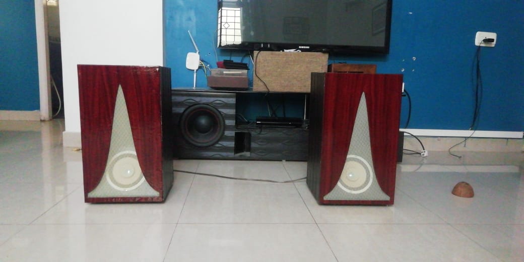

I had enquired about using F6 driver from Lii audio in post 3257 and freedi had confirmed in post 3261 that it can be used.
Based on this feedback, one diy enthusiast has built the K6. I think it came out very well. I had mentioned in the xKi thread that I will upload demo. Please see the attached files (unzip the files to find mp3 files). It is being played with Class D amplifier. It should sound even better with tube or class A amplifier.
Thanks to you, Freedi and GregB for design and guidance.

those Karsonator6" look really good, and considering that room with hard surfaces, sounds pretty nice too.
