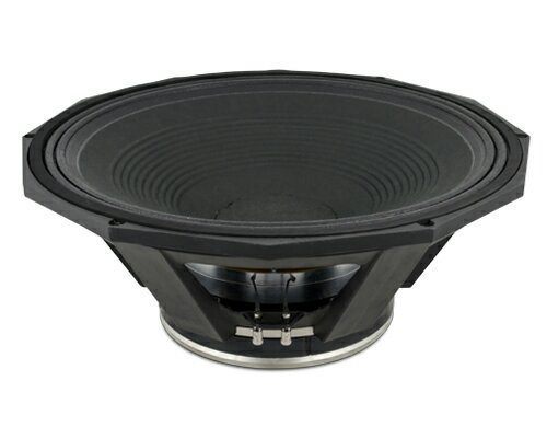

Alright, tough guy, how about one of these in a Karlsonator-
New 15" full range- FANE
I want to build a big single-driver K, and was thinking of something like these...
Think you can run a sim?

Sure, but be warned that it will be a big speaker, can you handle it? 7 to 10 cu ft thereabouts. Maybe half the size with an XKi.
Big speakers for big guys 😉
She made the mistake of saying she wouldn't mind a big set of K's. Depending on how huge they end up, a pair of these or something with a 10-12" class full range are the endgame here. Gotta get a plan in motion before she changes her mind!

If it ends up at 10 cubic feet or less it will be smaller than what I have, it will be very interesting to see what can be done with the Fane 15"!
