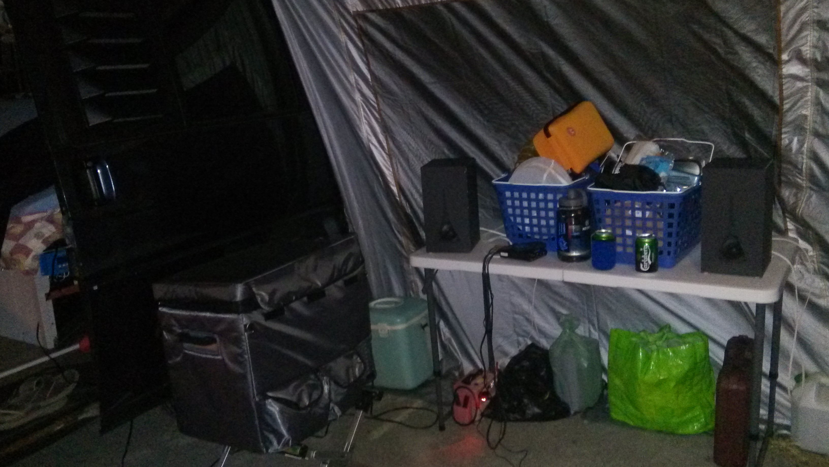

On floor for max bass, near back wall for more bass, away from wall for best 3D imaging but less bass. Similar to normal speakers. Main thing is almost 120deg uniform sound field.
Awesome! Tunes in the woods or on the beach?
Beach, of course!
Hoping to catch some waves tomorrow, then chase a clear sky for the eclipse in the evening.

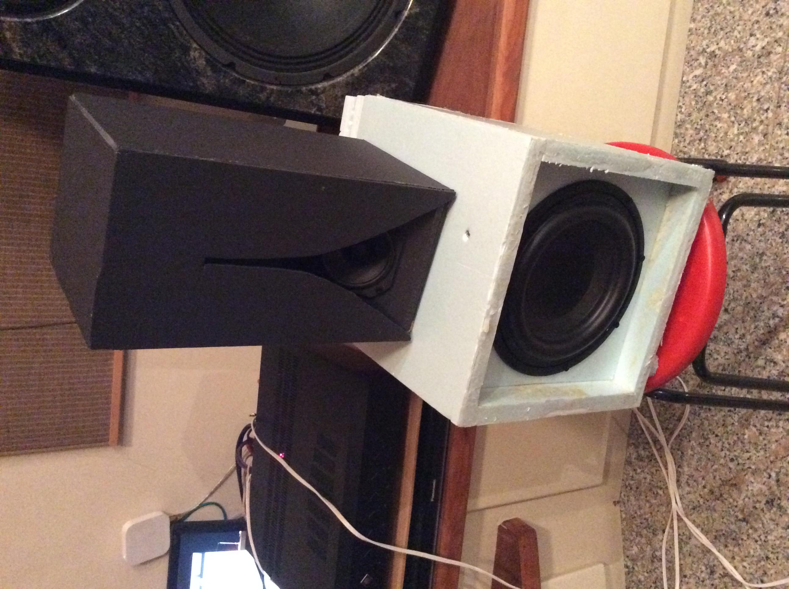

I did make a free shipping order at PE. I use a 12" sub for this PC and it needs downsizing. Tang Band W5-2053 was on clearance. I'm going to try it in as little as 4 liters.
I connected the resurrected .4xs to this pc competing with Behringer 40USBs. I had to cross those at 115-120hz to avoid bad things around 110-113.
There's no competition. I've dialed the sub down to 80 with the Karlsonators. They're playing through an unmodified TPA3116. I'm sitting here with a huge smile on my face. All this talk about dispersion and room filling and sounding better at a distance; well, they're astounding near field on the deskop. They need black paint. 😉

Do it in 1/4" ply!
