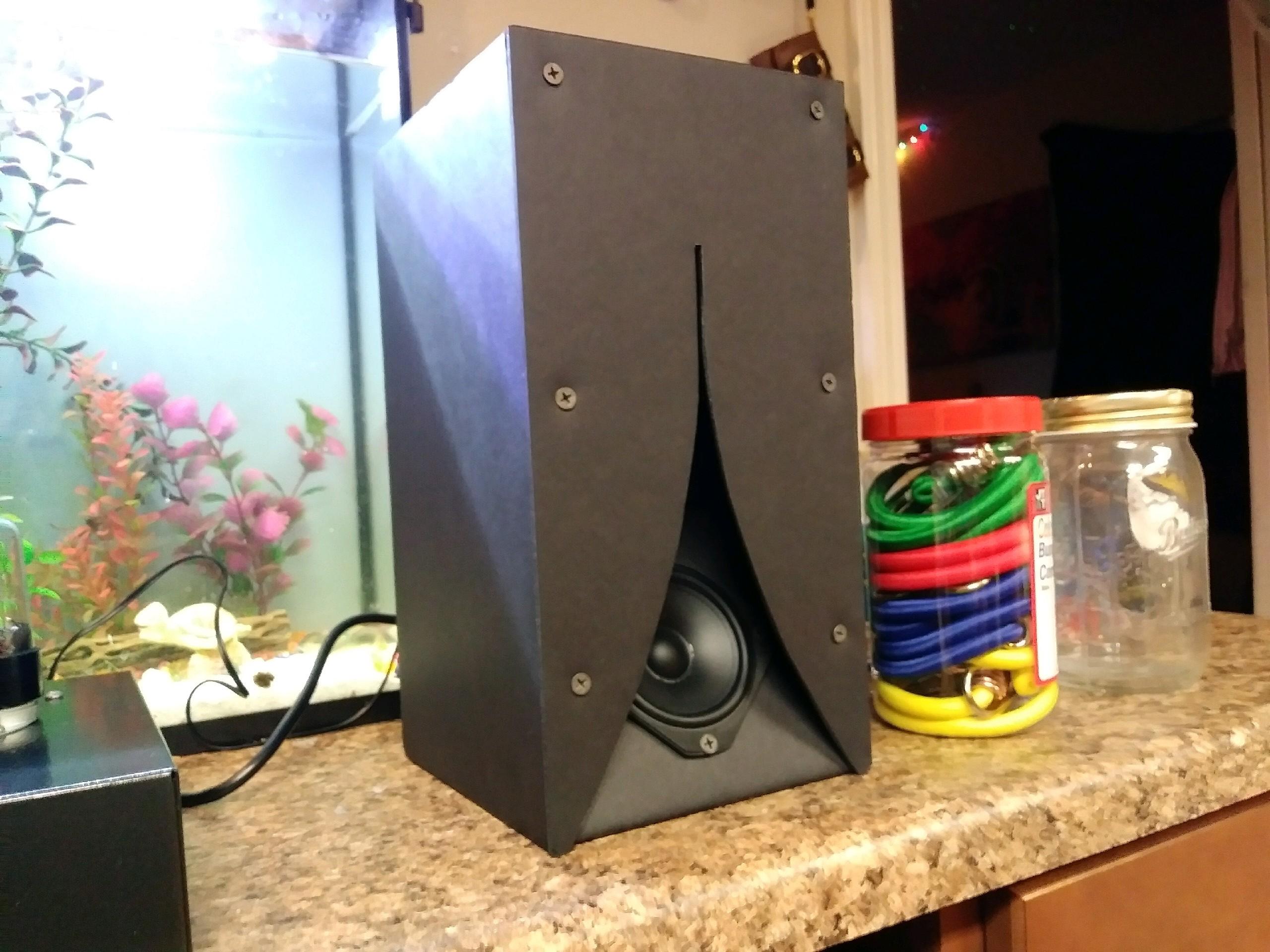

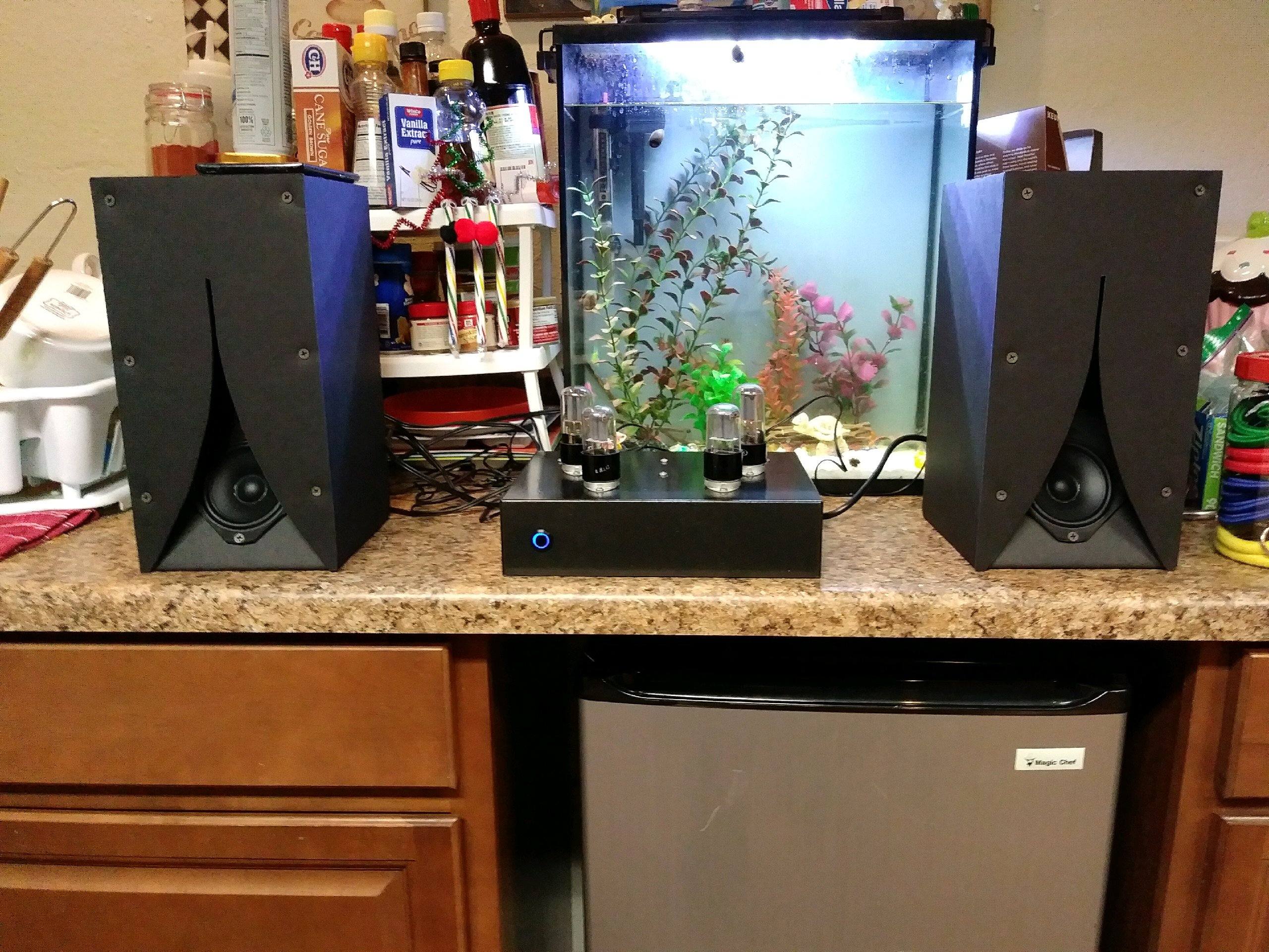

Finally got my pair finished!
Hot glue/white glue construction with the score and fold plans. Liberally stuffed as per the usual ways I've seen them built. I made little stacks of 1/2" x 3/4" stacked three thick as supports for the screws supporting the wing/apertures on.
They sound absolutely fantastic! A smidge heavy on the bass, but not objectionable really. That having been said, is there a passive line-level version of the BSC circuit I can do to try out and see how I like it? I'm not ordering parts any time soon, and don't have a local source for inductors.

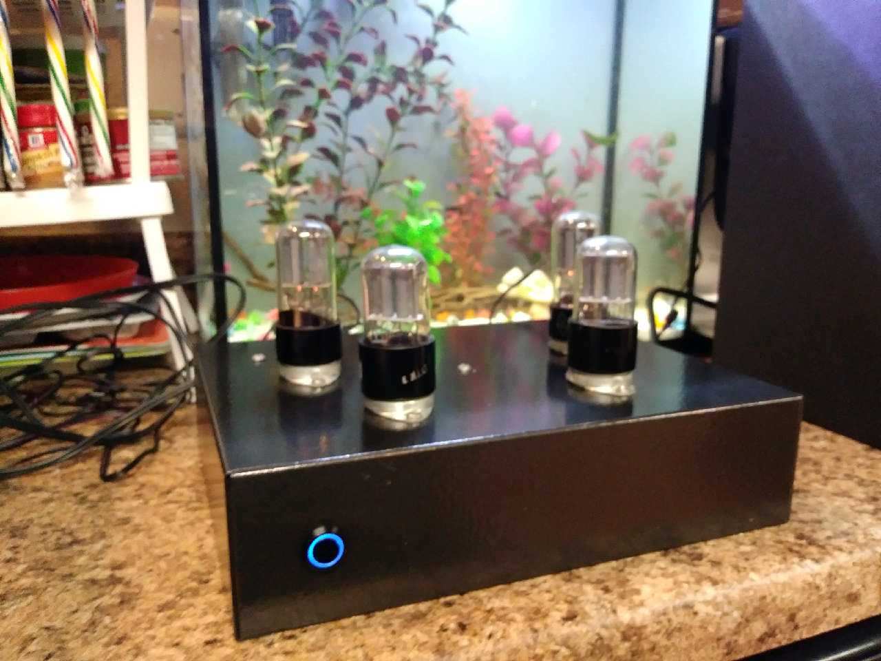

For anybody interested, I'm running them off of my 6SN7 push-pull amplifier and with about 1.1w total power, they can easily reach uncomfortable listening levels without audible distortion. Thread is linked in my signature 😀
Woah, big pictures!
Nice black ones... mine are on the way as well.
A BSC will lower the high end, and make the bass even stronger... Since you already say they are a little bass heavy, don't add a BSC.
Instead, move them to the edge of the counter and away from the wall.
Or open the aperture a bit higher, this will lower the bass.

I'm about the least knowledgeable builder around here, but I am around enough lately to field a question or two, I suppose. No caulk or weather stripping for the drivers in my build but I did caulk the inside of my cabinets very thoroughly. For the stuffing I just mimicked pictures of successful builds in this thread. I used thin carpet padding on the wall behind the driver and I used some acoustic underlayment (for wood floors) on the back of the wings. Whatever's handy is sort of the approach to many of these foam builds.
Yes, the black ones look fantastic, and I'm jealous of the amp. I have an el84 project with an old terribly abused Sears Silvertone console from 1967 on the to do list. I got behind it tonight and had the damnedest idea. The speaker cabs need to be Karlsonators. I'll try to post pics of it and the quad tomorrow. I've never posted pics here. Anything I need to know first?
