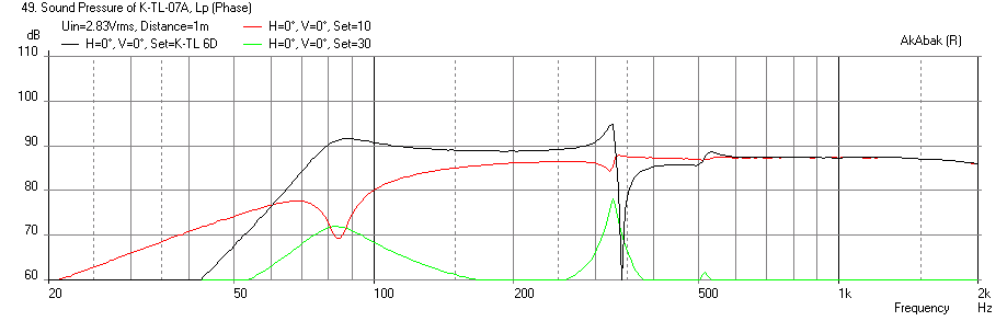

If you stick this driver in the 0.4x Karlsonator, it actually looks pretty good. Here is sim wihthout room walls nearby.
They are the Vifa 4" coaxial and are available at Apexjr. It is about half way down the page. It looks like a great little driver but need a crossover. For 14 bucks a pop, it is worth a try.

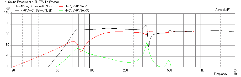

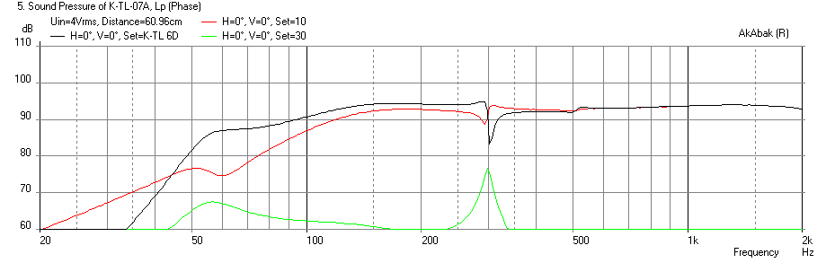

Effect of K-slot width
I just want to remind folks that there is a lot of room for experimenting with the K-slot and its impact on the sound quality/bass extension.
According to my model, if you use the default K-slot initial width (0.125 in) for the 0.4x Karlsonator with the Vifa you will get a response like this:
However, if you make the slot start as zero (a pinched off cusp), you get this:
Note the bass extension is deeper but the efficiency went down, but the discontinuity at 300 Hz is reduced.
What is nice about having a foam core front wing is that you can really play with this and go with what you like after hearing it. It is easy to change and easy to put back to however you like.

I like graph #2 best. If I didn't have subs, I may change my mind, but the reduced 300hz canyon is appealing to me.
