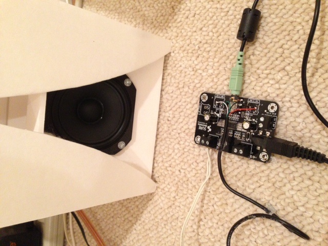

It sounds great on a desk (mine faces a wall) 2 ft away. Very good clarity and the angle that the driver aims upwards is perfect to hit your ear height. One thing I did not expect was the amount of bass that couples to the table surface and vibrates it. You can feel the bass on the desk surface. Not used to that much bass with my cheap PC speakers. I also tested this with my tiny TPA3110D2 amp from Sure ( at PE for $10 ) it is 8 watts and at 30% volume on my iPhone it is more than loud enough. I would guess it is 2 watts - which makes sense 88 dB at 1 m and this is less than 1 m so it is 89 dB which is about as loud as I listen to for casual music listening. You are in for a real treat. They sound wonderful !

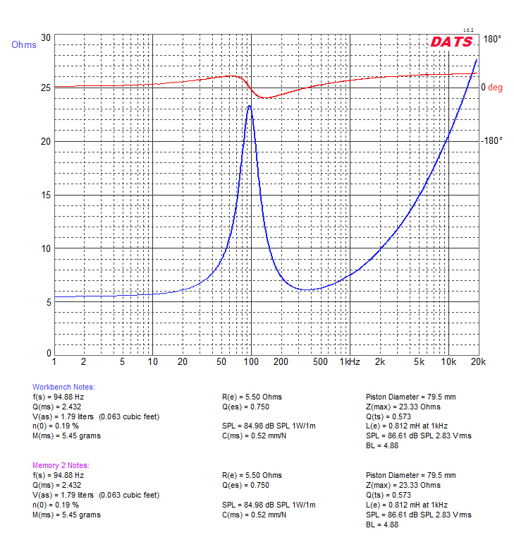

It's interesting how the price of the Vifa driver now matches the price of the Sure-built TPA3110D2 amplifier. This amplifier sounds superb - don't let the low price fool you because it has some of the cleanest highs and a nice bottom end with excellent imaging. Match these together and for $30 and your pick of a cabinet - you now have a sound system that will blow away any expectations of what a budget system hould sound like. Although I say desktop system just because of the credit card size of the amp (it will easily fit inside the 0.4x Karlsonator or any enclosure) - it is still powerful enough to full an average size room with great sound.
The Vifa TC9FD and the TPA3110D2 - a great pair. 🙂

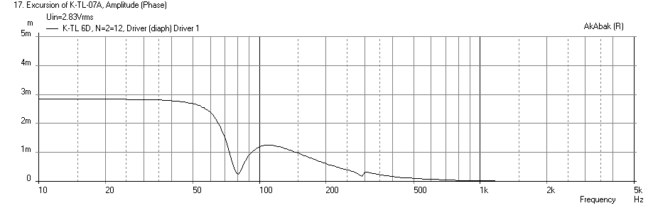

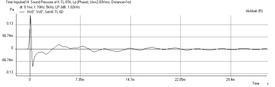

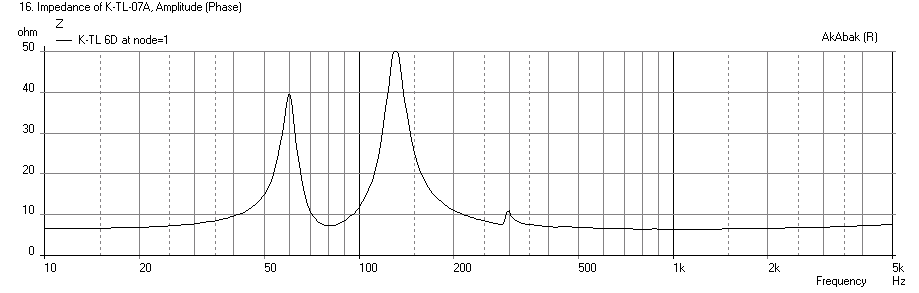

0.47x scale Karlsonator with Alpair 10.2

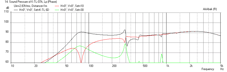

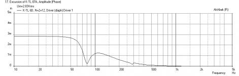

I had a request to see how well an Alpair 10.2 would work in a Karlsonator. Based on the size and optimizing for a smooth response, a 7/15x or 0.47x scale works well. Looks like it could be a great sounding speaker - just watch the cone excursion below 60 Hz.
SPL vs Freq, Impedance, Cone Displacement, Impulse response below.

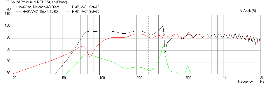

On your first graph, what is happening at 300hz? I've seen that same raise/dip on all the graph for the Karlsonator.

All Karlsons are band-pass devices. What we see here is the typical dip at the upper limit of the gain bandwidth. The K-slot allows for output above this, but there is some cancellation going on over a couple of octaves above this gain bandwidth, which can span 2-3 octaves itself.
Regular Karlsons really want low Qts, 0.25-0.35 usually simulates good. The taller versions discussed here with longer folded paths can likely do with 0.35-0.45. The scaled-down versions with small drivers might get away with even higher.

Thanks IG. I like the idea of a dowel. I have a couple feet of .5" walnut on the shelf that will work perfectly. SO? is that cancellation easily decernable? That is about a 15db dip.

It depends on the MLTL design - but my guess is that a MLTL properly designed will let the A10.2 reach a good 45 Hz or so - so it will be deeper. The Karsonator if at full scale of 30 in tall also reaches 40 Hz. When scaled to 0.47x - the path is essentially cut in half - this is needed to match the Qts/Vas of the A10.2. If you ran qnty 2 A10.2's per speaker you could run a full size Karlsonator and get the deep bass. The Karlsonator has other advantages that make it sound, in my opinion, better than a direct radiator MLTL tuned to the same bass extension. This results from the improved dispersion/directivity, and the dynamics (impulse response).
In my opinion, the dip is not an issue in listening to music. It also is not as deep when measured compared to the sims.
Here is a sim of the TC9FD with the mic (your ear) at 24 in away - near field use, and the desk 60 in away from a wall. With room reflection effects turned on, the dip is not as bad - quite narrow so it is not very discernible.
