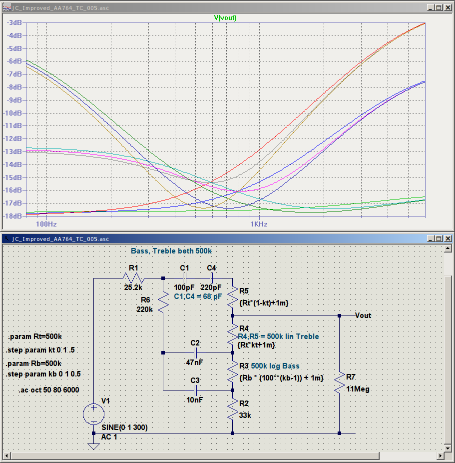

I like the two-knob version of Fender's FMV tone control better than the three-knob version, with its bizarrely ill-behaved mid control. So I spent a little time on my lunch-break tweaking the two-knob tone control of the Fender AA764 Champ, until I got the curves you see in the attached image.
Interestingly, in the simulation, the tone control behaves better with a log pot for bass, and a linear pot for treble.
I will try inserting this between triode and pentode. I'll probably need a MOSFET gain stage there as well, to make up the gain lost in the tone control.
I don't have a 68 pF cap handy, which is why you see 100 pF in series with 220 pF in the schematic. They combine to produce 68 pF.
Yesterday I tinkered with the amp a little more, sticking an external preamp in between guitar and 6JW8 input. A gain of 20 dB in that external preamp seems about right for (mostly) clean tones from the 6JW8, though that might change when I add the tone-stack between triode and pentode.
I'm thinking of trying out this topology: MOSFET input, gain control, 6JW8 triode, tone control, MOSFET gain stage + phase inversion, 6JW8 pentode.
-Gnobuddy

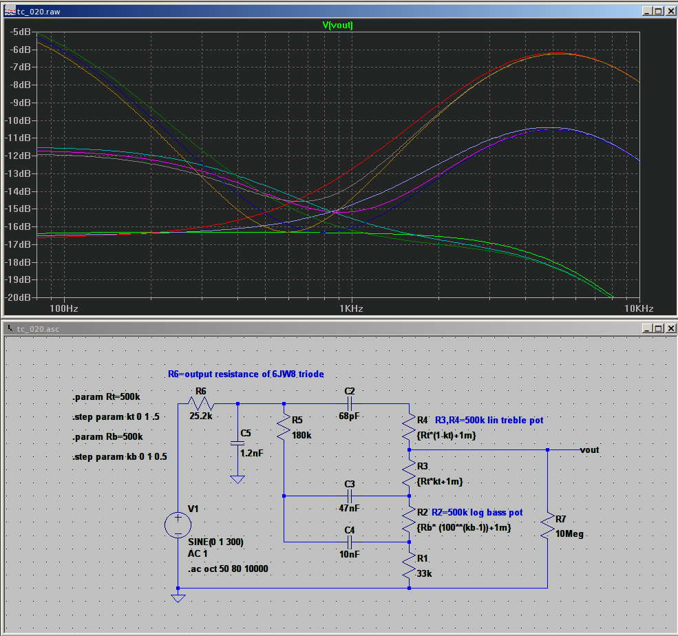

It's been a busy week (and a difficult one due to a family friend's very poor health), but I just finished soldering together the tone control from post #43 during my lunch break today. I will try and plug it into my mini-amp tonight after work.
Tinkering with LTSpice a little more, I realized I could add one more capacitor (C5 in the attached image) to roll off harsh high treble starting above 5 kHz or so. C5 forms a low-pass filter working with the output impedance of the triode gain stage driving the tone control, which I've estimated at around 25 kilo ohms.
The idea is for this treble roll off to help out the speaker-emulation filter which I will eventually add to the output of this amp, so it can plug into a P.A. system.
I played through the little amp for a couple of minutes before leaving for work this morning. I think it produces about the right volume level for daytime apartment use, at least with the ancient thrift-store speaker I'm currently using.
Even without the tone control, it definitely needs another gain stage. With the additional tone control insertion loss, it might need two. I have a few 6AQ6s, but I don't think I can get them to work on the meagre 135-volt B+ rail. So I need to consider other alternatives.
A second 6JW8 is one possibility. But that requires me to make a second breadboard adapter. A MOSFET or two would be simpler, and the two valve stages in this amp might still provide all the "valvey" sound signature we want. Some more tinkering is in order.

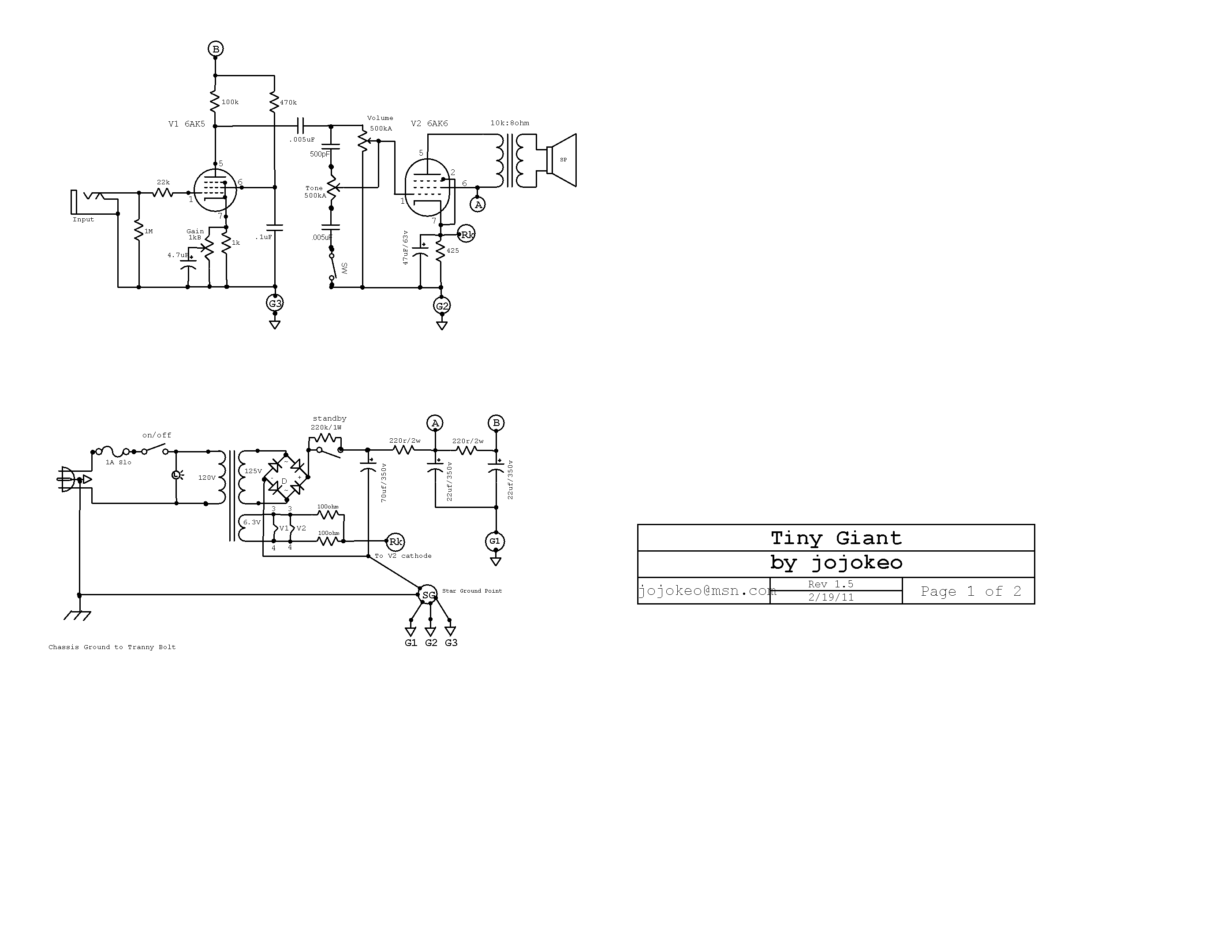

I stumbled across this EL34 World thread, and it featured a tiny little two-pentode amp (the "Tiny Giant") that might be suitable for this thread.
Here's the thread: Fun weekend project - Tiny Giant
I'm attaching the schematic. All copyrights belong to the original owners, of course. This is not my work in any way, shape, or form.
Speaking of my work, I will return to my own amp build soon. Just dealing with some difficult life stuff at the moment and needed a few days to get through it and recover my equilibrium.

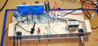

Meantime, stuff happened in my tiny apartment too...the mini-amp grew one more gain stage, a 6AQ6 in front of the 6JW8. There is now enough all-tube gain so you can plug in a guitar and drive the amp into clipping, and I've removed the external solid-state preamp as a result. The mini-amp is now self contained. All I need to do is wire in a gain control in place of the current jumper from 6AQ6 anode to 6JW8 triode G1, so I can lower the gain.
I will post the schematic as it currently stands soon. Until then, here is a pic of the whole thing on the breadboard.

Your breadboard looks great. Glad you found your gain, I have done the missed hole thing myself. On the find of the day, a lot of people moved from these parts to the west coast, these are not the kind of thing they are going to stick in the back of a truck and haul a thousand miles. We have the people that grew old and are now leaving their house for a old folks home, they hung on to the stuff. But even with that it has taken a lot of looking for me to acquire what I get. But this one was a surprise with finding out it was P-P. Some pictures.

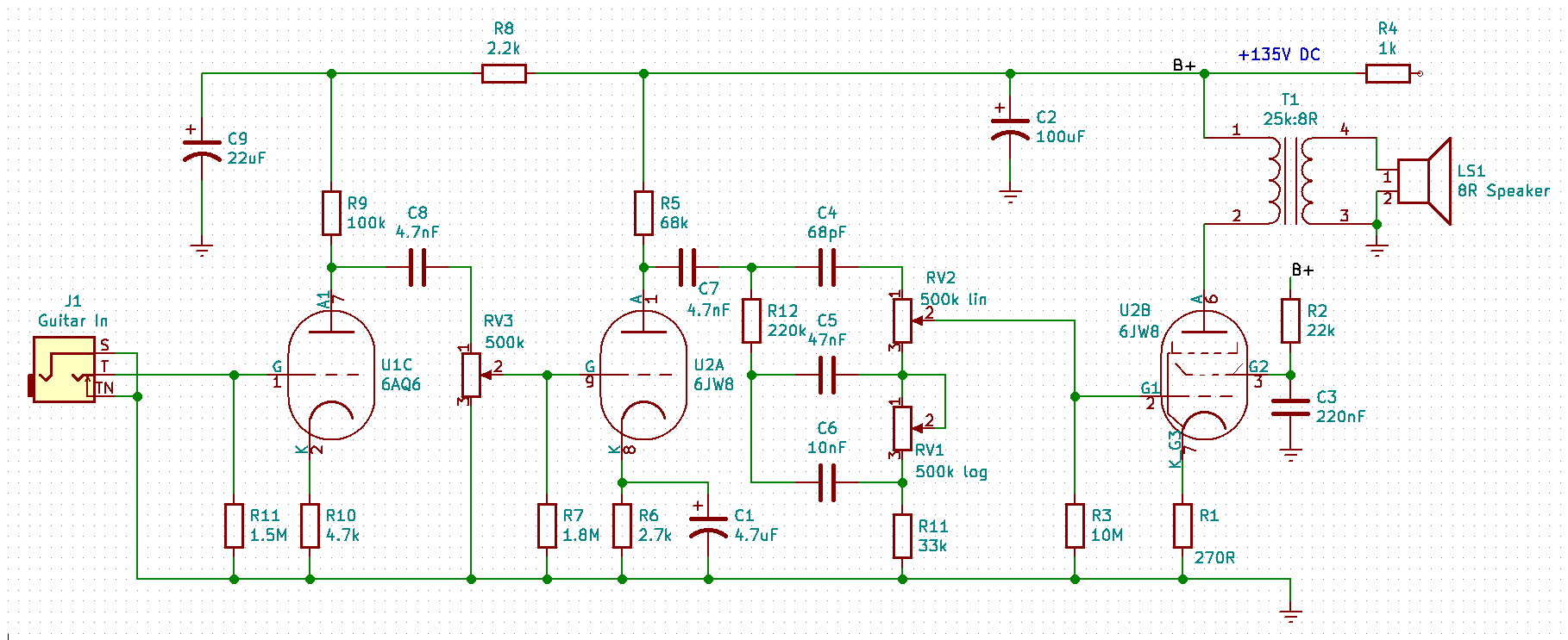

And now for the current schematic for my mini-amp. I had a long fight with Kicad last night. I lost and the software won, but I managed to make a somewhat readable schematic nevertheless.
There is surely tweaking left to do, but the thing does work fairly well as it is. It hums and buzzes a bit, not too surprising as it's on a breadboard and there is no shielding around it.
