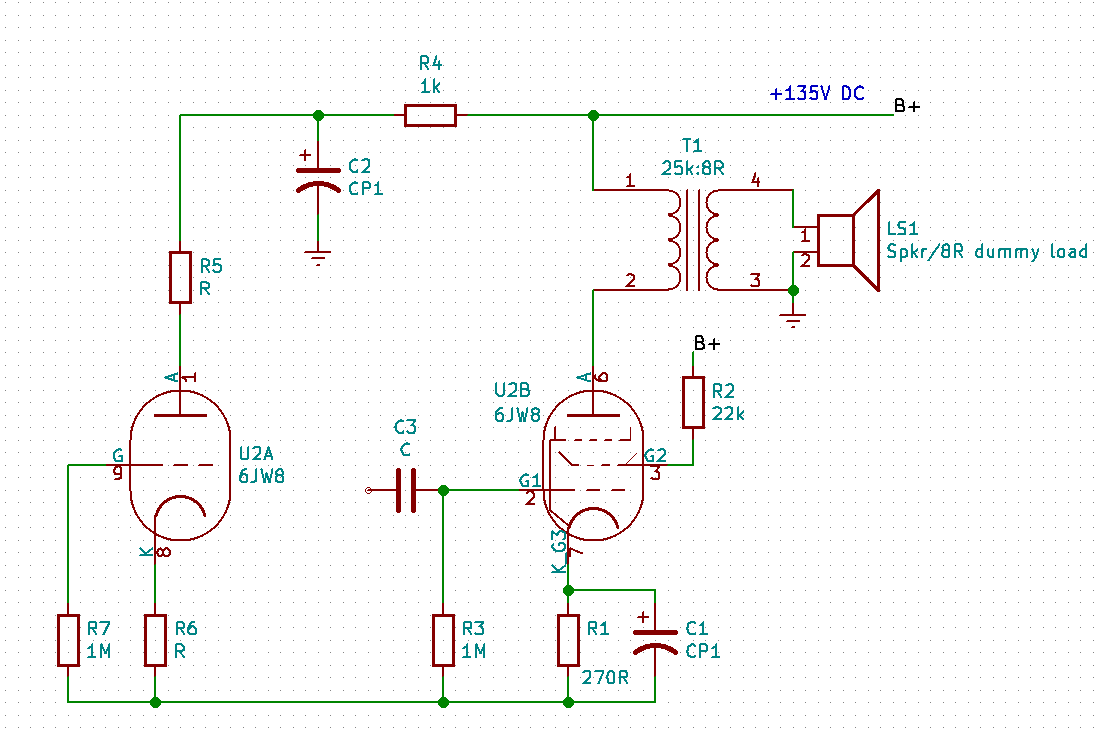

The 6JW8 mini-amp is clean enough to work well for these chords if I turn the volume knob well down. But if I turn up, I'm quickly into "classic rock" territory, and anything more complex than a two-note power chord sounds really nasty.

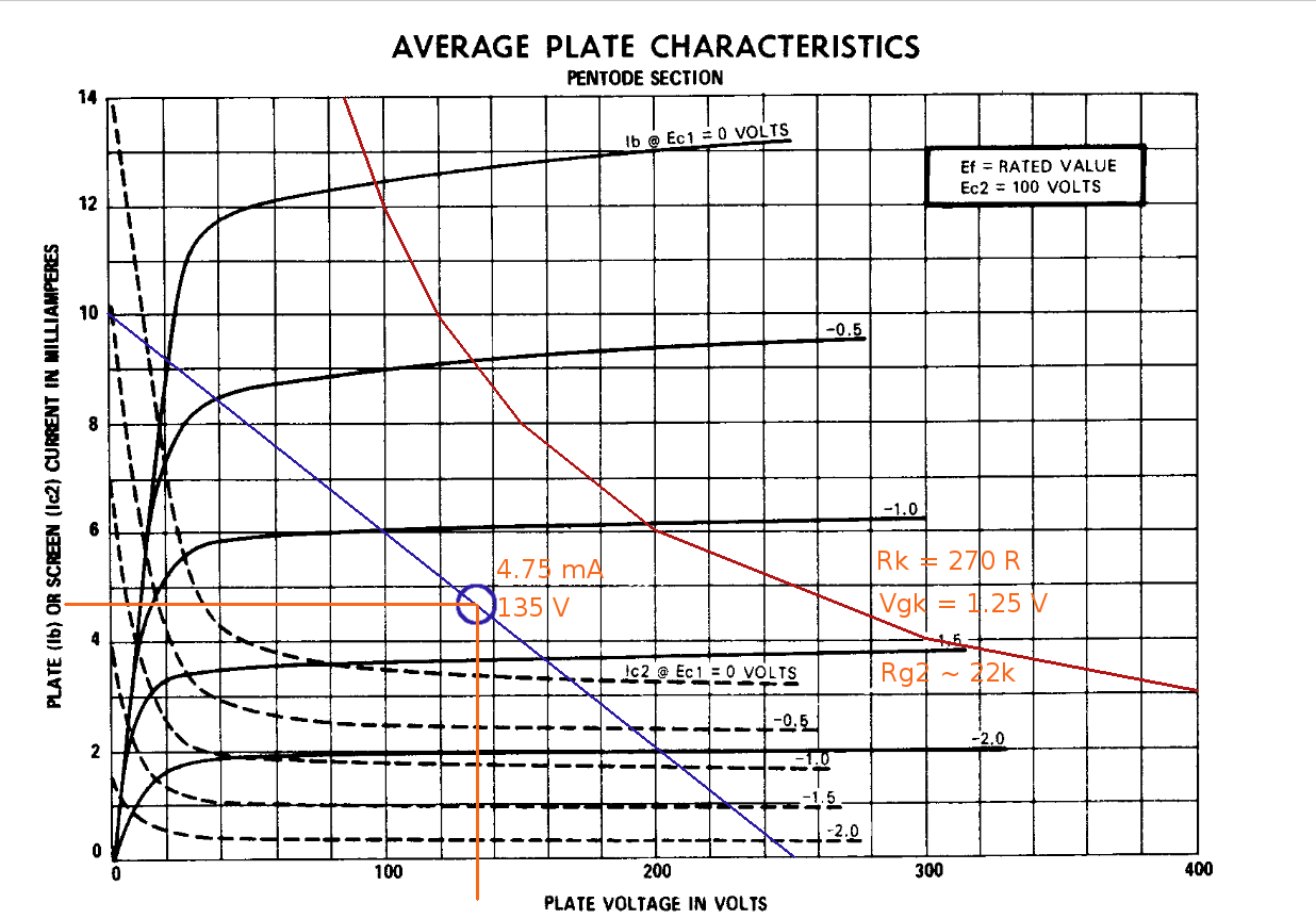

I was getting similar "stretched" sine waves by playing with the screen voltage in a pentode gain stage.
Exactly! In his valve preamp book, Merlin Blencowe talks about pentode load-lines, and how altering them can change the distortion and timbre. Combining his information with what I see on an oscilloscope, it seems that either lowering the anode load resistor, or lowering the screen voltage, tends to produce these asymmetrically stretched signals with lots of second harmonic distortion. (The load-line moves "above the corner" of the pentode curves.)
Going the other way, either raising the anode load, or raising the screen voltage, tends to make the signal flat-top on both positive and negative half-cycles, and the timbre is definitely different. (The load-line moves "below the corner".)

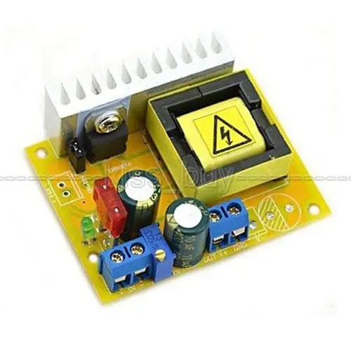

Completely oposite from the original concept of the thread, with all the talk about abusing tubes earlier I was thinking of building a board that I could hook up to any output tube and drive it with or without malice involved. Mostly just a simple amp in concept, some gain, tone stack, send it to the inverter and drive the outputs the way you want.
I want to try the step up inverter boards that I have so use one to get the high voltage, another that has a positive and negative rail use for the Mosfet drive. I did not include the terminal locations, going to have terminals to send out to the grids from the inverter capacitors. Biased with a cathode resistor. If fixed bias is desired short the cathode resistor and hook up the negative supply on the Mosfets. Still taking the drive from the capacitors mind you, will clip at 0V as normal. But move the grids to the source of the Mosfets and add the positive supply you get Class AB2.
Or at least that is the thought. If anyone sees an issue now is a good time to bring it up.
I'm wondering if there is sufficient current to charge up the input capacitance of the IRF820 gates in the available time, and if the 470k bias resistors can discharge them sufficiently fast.
I looked at the IRF820 datasheet, and it says there can be up to 360 pF input capacitance. Also up to 24 nano-Coulombs of stored input charge at the gate. With 1 mA of drive from the LND150, I estimate that translates to a slew-rate of 2.5 V/uS at the gate (one-fifth the slew rate of the often despised TL072). Alternatively, it will take 24 uS for 1 mA to stuff 24 nC of charge into that gate.
So charging (positive swings to the gates) are a little iffy, but discharging through those 470k resistors worries me considerably more. 360 pF input capacitance and a 470k resistance translates to a cutoff frequency that's a bit less than 1 kHz. I think that's too slow even for a guitar amp.
I have little experience with power MOSFETs, so I may be wrong. Let's hope George chimes in. (Or you can steal his MOSFET driver schematic, which he's posted on diyAudio a few times.)
-Gnobuddy
In the normal common source sense "input capacitance" refers to the gate to source capacitance which is large.......but we don't care!
We are wiring the fet as a source follower. The source follows the gate, IE stays at the same relative potential offset. This effectively "bootstraps" the input capacitance and removes it from the picture. In the real world, no follower is perfect, but a high Gm fet comes close, so it is wise to avoid those 5,000 pF fets, but 350 something is a don't care.
Next up is the output capacitance (drain to source). Since we tie the drain to a well bypassed positive power supply, and the source can drive 2.5 amps with 3 ohms of ESR, again we don't care.
The reverse transfer capacitance, Crss IS important to us. This is gate to drain capacitance, and since the drain is bypassed to ground, Crss becomes the input capacitance of the stage. My (old) data sheet says 2.7 pF, on par with many tubes!
When searching for a suitable tube friendly fet, look at the capacitance VS voltage curves. Silicon life forms always have more capacitance at low voltages, so look for those that have a low and relatively flat Crss in the range of voltages where it will be used. This one goes well over 100 pF at 1 volt, but drops to about 3.5 pF at 15 volts then gently decreases to 1.5 pF at 500 volts. Feed this guy enough voltage where it always has more than 15 volts across it, and all will be well.

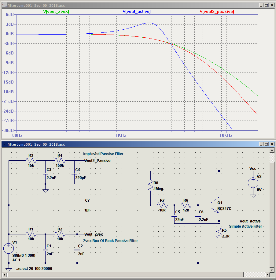

I spent a few minutes tinkering with LTSpice last night, and came up with the attached one-knob tone control idea. The frequency response tilts gently downwards over part of the tone knob's control range, which might be just what this somewhat bright little amp wants.
As a bonus, there is a slight mid-scoop at about the right frequency (roughly 500-800 Hz) for flatter "tone" settings. This might be good when dialing in clean tones.
Insertion loss is low, too, at around 6 dB.
-Gnobuddy
