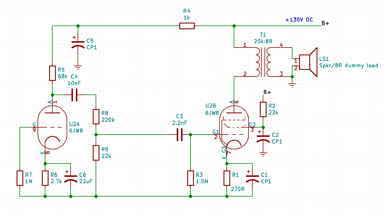

A bit more progress to report. It looks like the triode in the 6JW8 can also be coaxed into working with a relatively low 135 volt B+ rail, as the attached load line shows.
This is the same supply voltage I used for the pentode part of the 6JW8 in the preliminary schematic I posted earlier, which is convenient.
With a little careful juggling, this value of B+ also allows a quiescent operating point at Vgk = (-1.5V). This is about the same value of Vgk found in all those "classic" 12AX7 gain stages in Fender amps.
The chosen load-line also puts the 6JW8 triode into cut-off at roughly Vgk=(-3V), which is also similar to what you get from a typical half-12AX7.
Hopefully this means the input stage will have overload characteristics roughly similar to the usual stage made with a 12AX7 and 100k and 1.5k anode and cathode resistors respectively.
Estimated voltage gain of the triode stage is around 30 times, about half what you'd get from a 12AX7 gain stage running on 300 volts.
We've estimated the little pentode stage only needs 2.5V peak-to-peak to drive it to full clean output. So we might need quite a lot of attenuation in between the two stages, to allow the triode stage to be driven hard enough to provide some valvey distortion of its own.
This inter-stage attenuation will be chosen for best tone, and not to generate the desired voltage gain. The valves are there to be tasty tone generators, not voltage amplifiers; any voltage gain they produce is just a nice by-product. If extra (clean) gain is needed, it's easy to stuff a MOSFET or two wherever necessary. This is a luxury that Leonidas and Jim and their techs did not have back in the era of the classic valve guitar amps.
Speaking of MOSFETs, there is a phasing issue I'm pondering. The triode stage will distort in such a way as to output bigger negative half-cycles than positive ones. Since the following pentode stage inverts, this means the triode will try to make the pentode put out bigger positive half-cycles.
However, the pentode by itself has more gain at higher anode currents, which means it tries to generate bigger negative half-cycles than positive half-cycles.
So if the distorted triode output is fed into the pentode, there is a conflict. The triode is trying to make the pentode spit out bigger positive half-cycles; the pentode itself is trying to spit out bigger negative half-cycles. This means some of the distortion will be cancelled out because the two stages have opposite kinds of nonlinearity.
So there may be a case for sticking an inverting stage between the the triode and pentode. It doesn't need to have more than unity gain, or produce any distortion of its own. The obvious answer seem to be the use of a MOSFET "source-o-dyne" stage.
Is this a good idea or a bad one? I think this one will have to be tested by ear.
-Gnobuddy
Fender AA Champ. At high input, the first triode and the 6V6 distort the same way, ~~5% each; the 2nd triode is not working hard (note heavy tonestack here) and has low distortion (~~1.5%).
Excellent point. Thanks for that!
I hadn't really been thinking about tone controls yet, but it would make sense to stick them between the two stages to provide the attenuation that is necessary there.
If I stick a MOSFET in between to provide phase reversal, maybe it can also do something useful (such as implement a separate mid control.)
-Gnobuddy

I had social obligations today that kept me from the electronics workbench, but I found a few minutes to estimate the triode parameters of the 6JW8 triode around the operating point I plan to use.
I wanted to know the anode resistance, so I could estimate the gain stages output resistance, so that I can plan for that when designing the tone controls. Having found ra, I figured I might as well also estimate mu and gm. They are in the attached image.

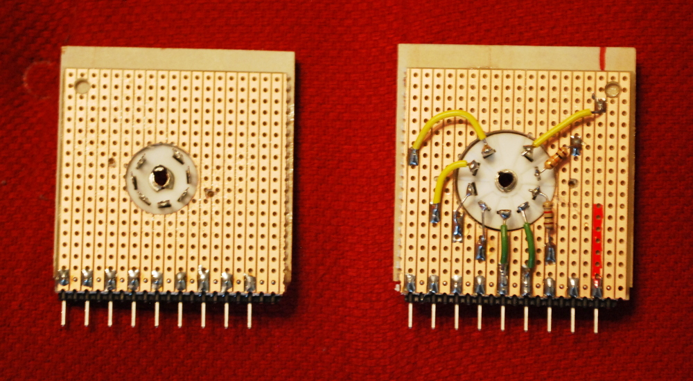

I don't know how far along anybody is with actually building anything

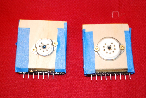

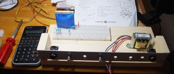

Not far. Just beginning to prototype on a breadboard. See attached breadboard pic. :)
The other pics show a pair of valve-to-breadboard adaptors I made recently. Legal disclaimer: these adaptors are not safe to use at the voltages valves need, so please don't copy mine. I was dropped on the head one too many times as a baby, that's my excuse.
With a little luck I might get to apply power tomorrow, and at least check out DC operating conditions. With a little more luck, maybe I'll have enough time to put the signal generator and 'scope to work for initial AC measurements.

The pinout puts the output right next to the input making for some good oscillators.
I'm probably asking for trouble sticking one in a solderless breadboard, then. We'll see how it goes!

making for some good oscillators.....I'm probably asking for trouble sticking one in a solderless breadboard
If you are using the triode to drive the pentode, then the pinout works in your favor, since the triode plate is next to the pentode grid. Going the other way with conventional common cathode stages makes oscillators since it puts two in phase signals with a bunch of gain right next to each other.

Life keeps getting in the way, but I found a few minutes to solder and wire today, in between feeding the cats and cooking dinner. The Hammond OT is now mounted securely on a small pine plank carrying the breadboard, and it's wired up to a 1/4" speaker jack. The primary is also wired up to the appropriate places on the breadboard.
All it needs now for initial DC operating point testing is a supply rail filter cap, and heater and B+ power to be connected. Maybe tomorrow.
-Gnobuddy
I got as far as applying power and doing a few DC checks today.
It took 1.5 ohms in series with the heater to drop the 7.3 V RMS (!) from the supposedly 6.3V transformer down to an actual 6.3V RMS, as indicated by my DMM.
But that was the only unpleasant surprise. All other voltages and currents checked out remarkably close to the numbers I'd estimated from the load lines.
For the pentode Vgk settled down to (-1.54) volts across the 270 ohm cathode resistor. Cathode current is 5.7 mA, and screen grid current is about 1.23 mA, so anode current must be 4.47 mA. Right on the money, though Vg2 measured 108V instead of the 100 V I was shooting for.
The triode also biased up nearly exactly as expected: Ia=560 uA, Vgk = (-1.505 V).
I've plugged in a roughly 6" driver from an ancient thrift-store Sears speaker. There is a little audible buzz, not too surprising with no metal enclosure, AC heater power, and a quick-n-dirty power supply.
Touching the control grid of the pentode with a fingertip makes the buzz considerably louder. So we definitely have enough gain and output power to make at least a little noise with a speaker. And this is just the pentode - the triode stage hasn't even been AC-coupled to the pentode stage yet.
I guess the next step is to couple the triode output to the pentode input, wire up the input jack, and just for fun, see if there is already enough gain to play guitar. With no tone-stack losses, I expect there will be. :)
I still find it amazing to be using a 1.8 megohm resistor in series with the power indicator LED. It's nice and bright at 100uA LED current, instead of the 10,000 uA we would have had to use just a decade ago!
-Gnobuddy
I just did that, and yes, there is. In fact there is enough gain to get just a little grit on the sound if you strum a six-string chord on a guitar with humbucking pickups.
With the unbaffled, decades-old, thrift-store driver that came out of a box labelled "Hi-Fi", the volume was ample for midnight apartment playing. Maybe a bit too much.
I think the next steps are:
  1. Plug into a better speaker.
  2. Add a tone control of some sort.
  3. Add some gain ahead of the triode to see if we can get a little musical nonlinearity out of the triode itself.
  4. Add a phase inversion between triode and pentode to see if that enhances their combined sound.
-Gnobuddy
