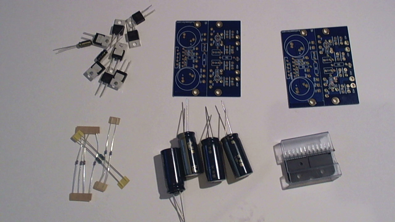

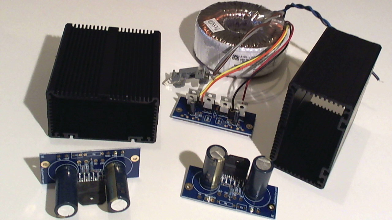

Amp is the LM3875 GC - Daniel's Basic Kit

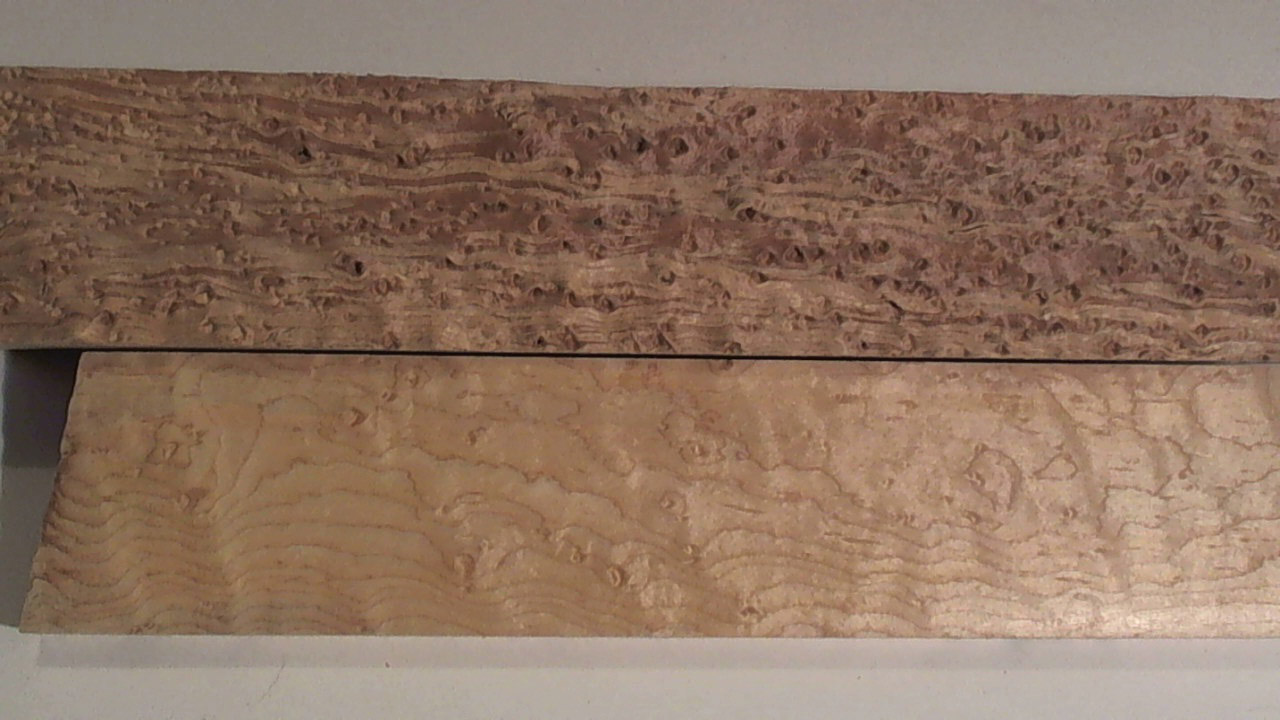

I have decided to build my cabinet with the 3/4" 11 ply birch and the additional maple on the outside, as Bernie is building these cabinets also. I am planning on varying the thickness of the maple to create front and sides with varying thickness. I will post drawings when I have picked out a cabinet. Do not worry, Scott, I will be following your internal plans exactly. I hope your plans tell me how to draw that big curve on the back! (that is not something you can do with a drafter's compass!)

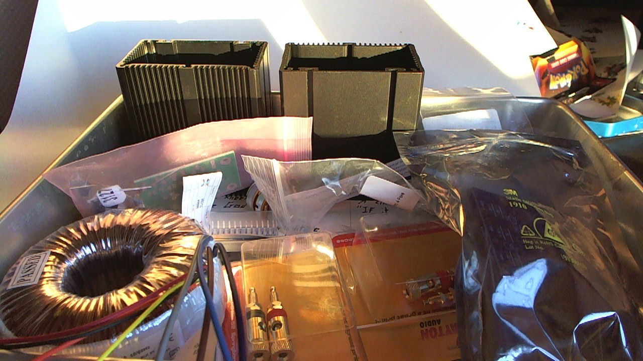

I have GC amp to build,

The garage sale will wait.
This is going a lot faster then I planned. I got the plans from Scott and picked up some baltic birch from Menards today. It seems everything is falling in place with this project, as Menards will no longer be stocking this item, it is becoming a special order item only. They had 5 sheets left after I got mine, I did not want to take any chances.
There are other things I really need to be doing, but I have I strong desire to get this build going! This is irrational isn't it? Shouldn't we be focusing on, auh... ...paying bills, eating well, maintaining the house, staying in shape, providing for our families, getting to death safely?..
...There are only two things that will stop the inspiration I have right now and that is an act of God and spending time with my duaghter. Well, my duaghter is on holiday with her mom, and it seems to me, God is helping me get this done! So...

Geting Warmed up
Okay everyone, got the important stuff done on the weekend in reguards to life... Actually it is very serious stuff, which is why I need a project like this to keep me in high spirits.
I started building the GC amps, pretty cool really. I have worked on electronics before, but never built anything from stratch like this. Got the boards done, now comes my favorite part, designing the enclosures...

Nice find
It is always nice when you stumble across something like this in the shop... It was in the rough when I found it, but as you can see, it sands down really nice! I am thinking this will make reallly nice fronts for the GC, with a complimentary trim wood of some kind. I would like to use this to detail the speaker cabinets also, I just do not have a lot of this. I'll be starting the cabinets soon, now that I am warmed up. My room is almost reversed, just need to install a new phone jack for the internet connection. I hope you all are having a great night!
