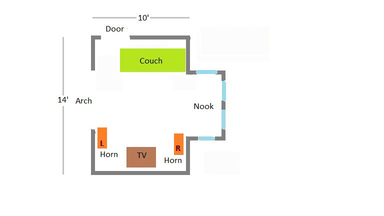

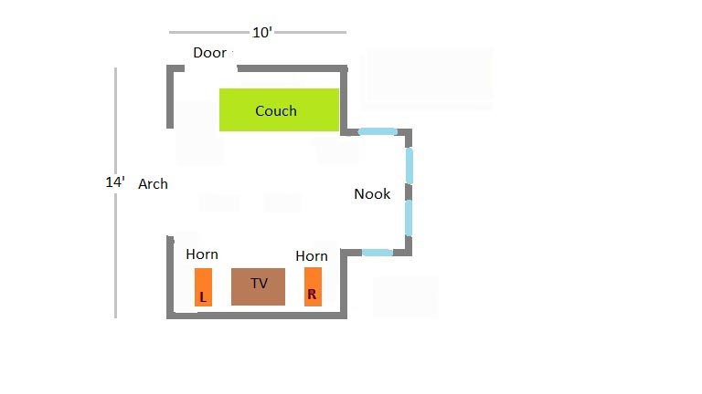

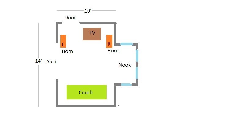

The door and other ideas
I am sorry, Chris, I got you all mixed up about the door -vs- archway in my room😕. I have no intention to ever add doors to the archway on the left wall in this room. You are right, the acoustical balancing of this archway and the Nook of the right wall is excellent, it is one of the acoustically special things this room offers. It is the door on the front wall, behind the left horn in the drawing above, that we are addressing. It is a stardard door jamb that has a solid core door that opens into the room towards the left wall. However, the solid core door is currently in my basement, as I have removed it, because when it is open, it blocks a hot air heating vent and when closed, it messes up the air circulation of this room. These problems can be fixed by rerouting some of the heating duct work, which should be done for optium preformance anyways. Either way, my gut does not like the idea of the door returning. An alternative idea is to reverse the room - see drawings below. The only drawback to this is that the couch sticks out into the doorway more then I would like. What I do like about this set-up is the equal accoustical balance for both horns and how the sound will project into the adjacent rooms (I listen to my main system as background thoughout the whole house).
It looks like this room is a perfect canidate for the Victor system (first drawing).
Also, it appears with this reversed arrangement that we would have a better listening distance for the Hiro system also (second drawing). A wall of bookshelves on the front wall would look good with them, but I get ahead of myself. However, the Hiro set-up would not take advantage of the archway or nook either.
Opps, I got the Left and Right horns labels backwards!
So ultimately do I want the horn mouth to project out of the front or the back? I am guessing front mouth is more directional, disreet, and forward. I am guessing the rear mouth has more depth, scale and width. Which works better sonically with the driver or is it personal taste?

Allen:
The flipped room layout has a better feel about it (now your only expense might be a shorter couch 🙄)
Having heard more than a few examples of front and rear single and double mouthed horns, I'd generally opt for the rear mouthed versions, for the reasons you assumed - but as you opined, this is an area that can be very subjective.
This room also is a very good candidate for a BIB - a vastly simpler construction project than Scott's more elaborate manifold / horn designs.

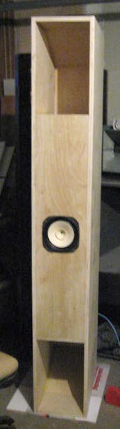

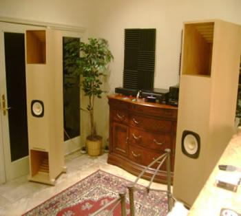

A couple of additional thoughts:
-There have been several Hiro builds over the past couple of years -see the attached. One is a DIY build, the other a licenced commercial variation from the defunct CarderSound (Jeff had the misfortune to time his startup right when the bottom fell out of the world finances). From a DIY POV, of the Saburo / Hiro / Sachiko family, it was always the least popular. I don't know why, but I'd speculate that since it isn't physically much smaller than Sachiko, most people built that one instead.
-Vulcan has recieved positive feedback thus far, but since it's very new, for obvious reasons, it doesn't yet have much exposure. Avebury is at a similar status so you'd neet to be quick to have the first. 😉
