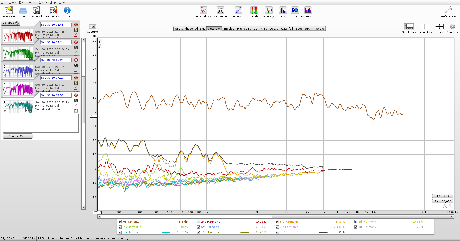

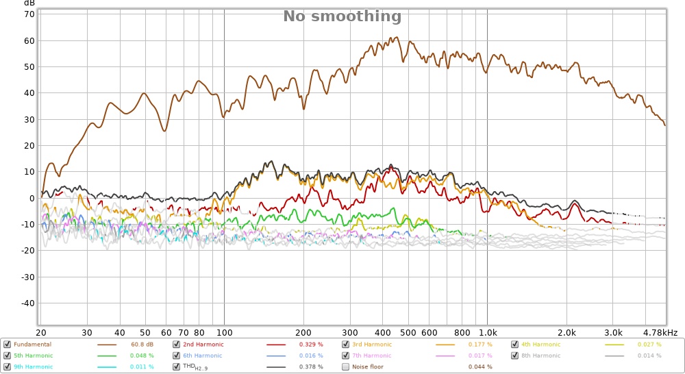

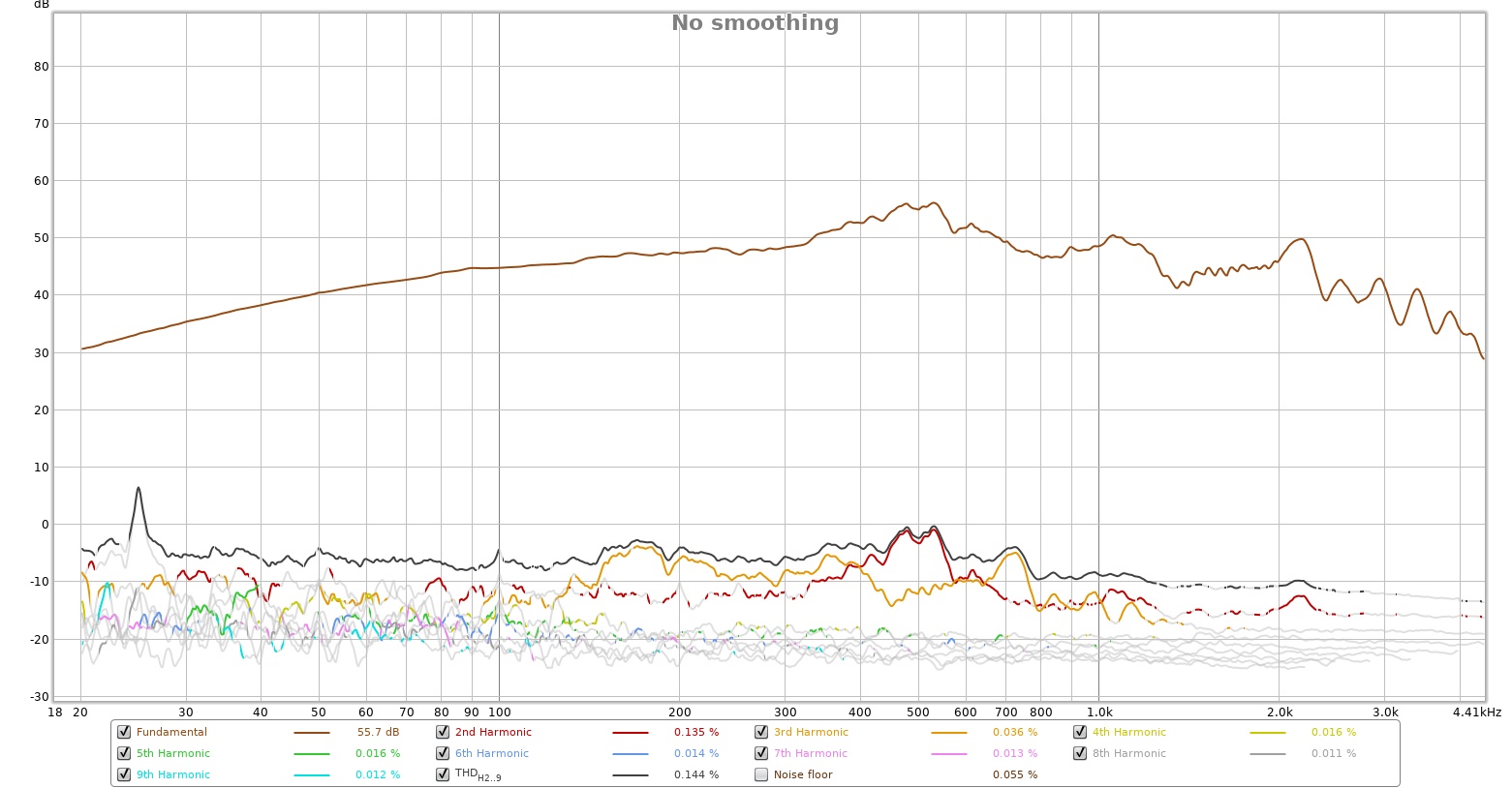

I have finally finished them.
Distortion seems relatively low. I have more problems with furniture rattling in the room.
Crossed at ~400Hz to B&C 8PE21. Probably it would be even better to cross it lower, but I wanted passive crossover.
I have MTW configuration because otherwise tweeter is too high when I sit. Vertical dispersion is very limited.
