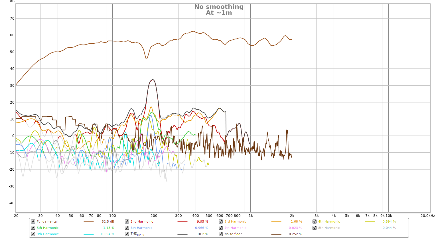

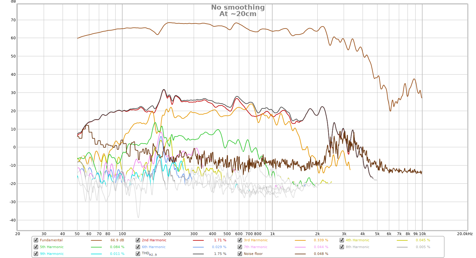

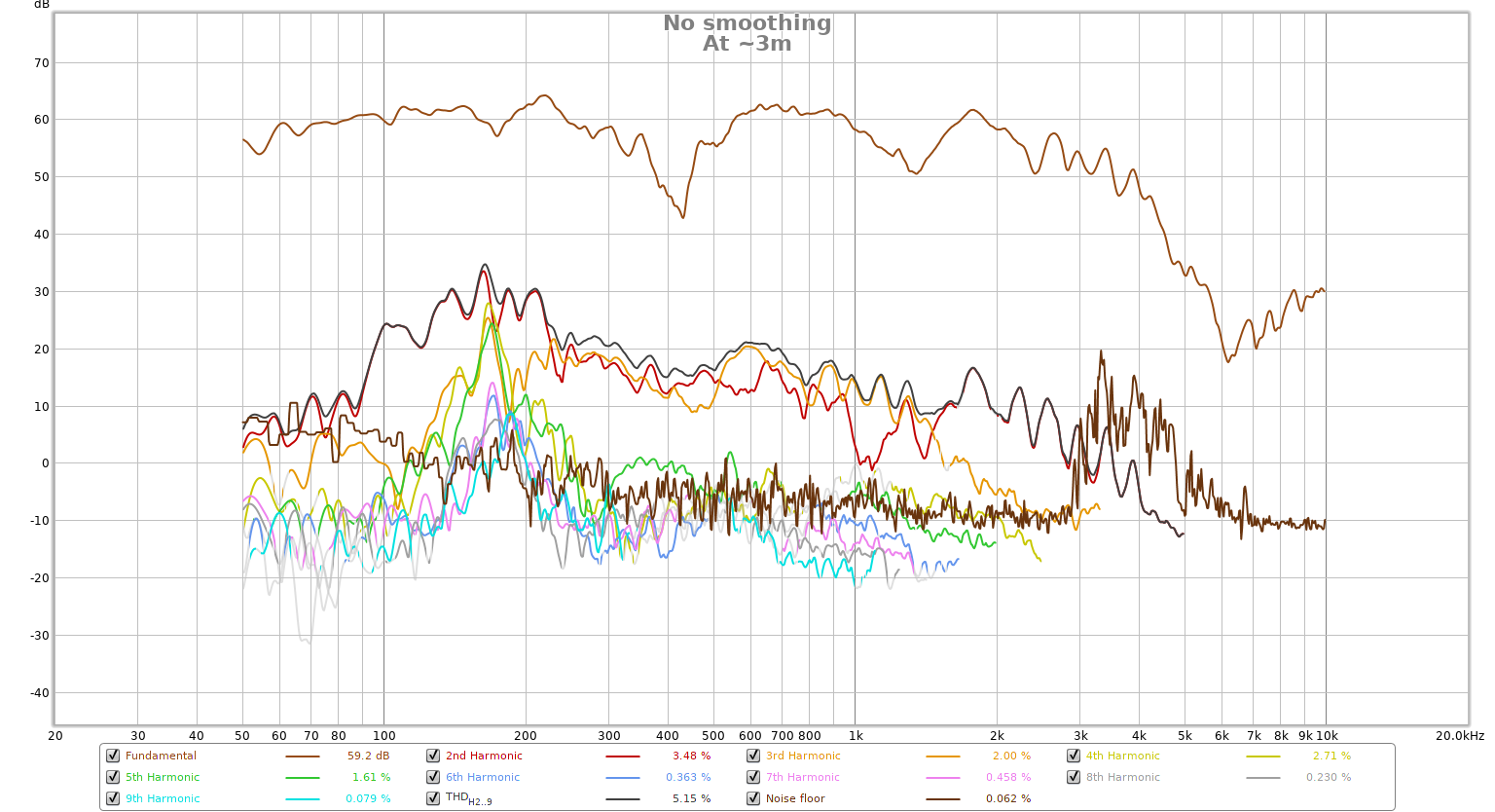

I finally put them in box and measured outside. Now I'm even more confused.
Something really weird is happening from 100Hz to 300Hz. Distortion peak moves a bit when I reposition mic.
Anyone has any idea what this might be?

Yes it is vented. I did not try to stuff port.
Length is 30cm and diameter is 16cm.
Maybe port is not sturdy enough? It is PVC (sewage) pipe.
Maybe it was cable vibrating (I could hear it, if I did not hold it). Cable went through port. Maybe it was still vibrating inside?
Mic is not calibrated. It was definitely more than 60dB. Should have been more than 100dB. Box is 25mm birch plywood.
When I'm saying "Box resonance" I do not think about materials or stiffness etc. But the distances between surfaces and driver, and how they relate to eachother.
It's actual resonances inside the box that escape through the port, not a bracing or stiffness related issue.

It could be a cable vibrating, but I somehow doubt it. The distortion seems to stem from the squiggles centered around 170hz to my eyes, and it may correlate well with certain box dimensions (IE tall-ish box for 15").
It is a bit tallish. I didn't notice that dip, I thought it is reflection.

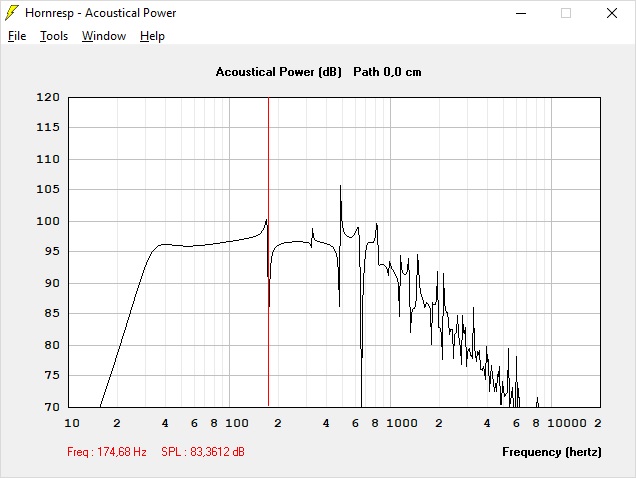

I think it is possible that it is second harmonic of box. When I simulated as MLTL it showed small dip at 210Hz.
Didn't know this also causes distortion.

I had to guess at some dimensions, and simming the box like you said, I see the resonance centered around 213hz.
But if you just for fun add 20cm just to see what happens if you move port away from bottom, you get a resonance centered at 174hz (ignore everything else, it's just for looking at what can come out of the port after bouncing around a bit).
