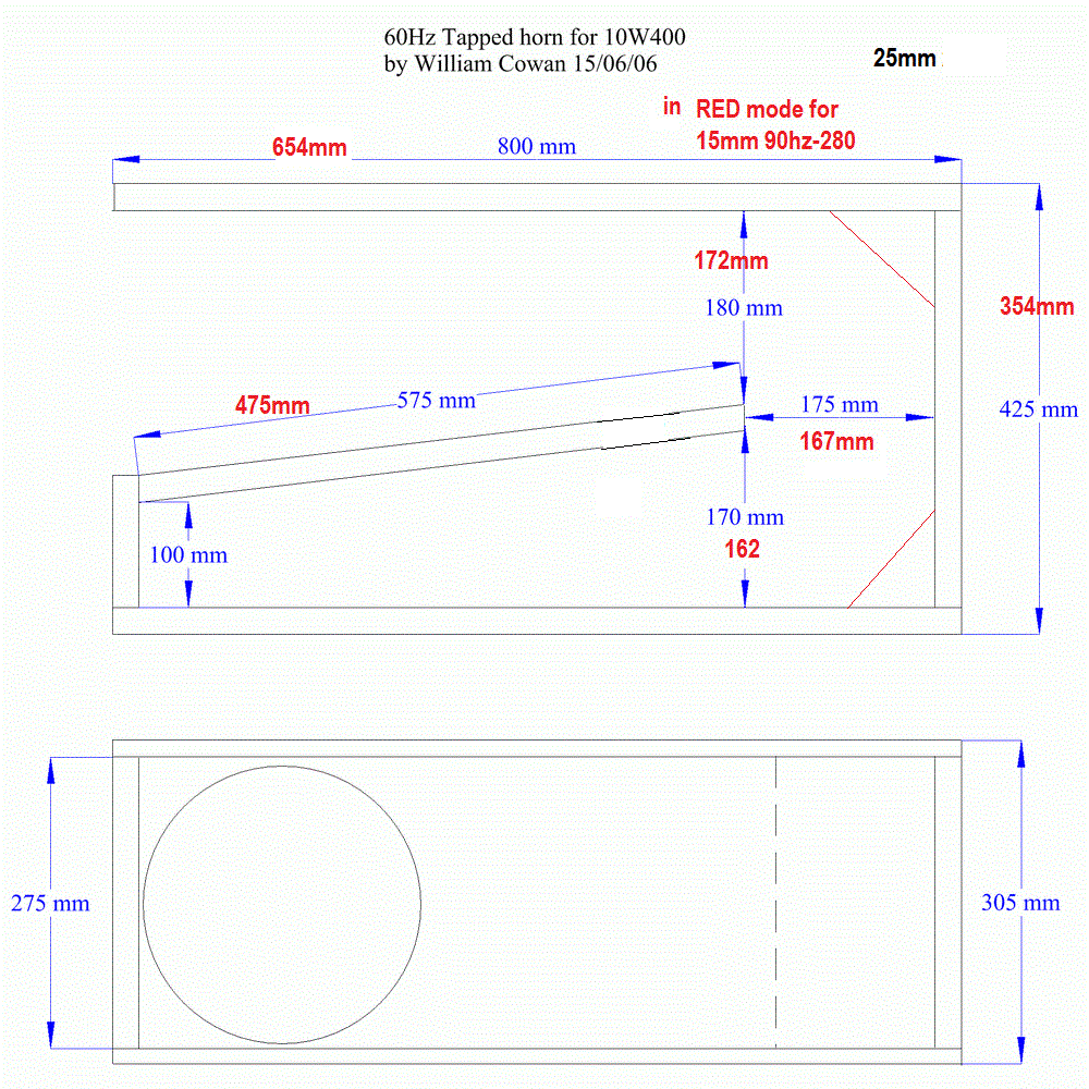

Is there any 10" BPH?
May be this will fit?
It's a modification of Cowan 10TH which I very like.
Double version should work up to 300hz.
Or ... may be not.
