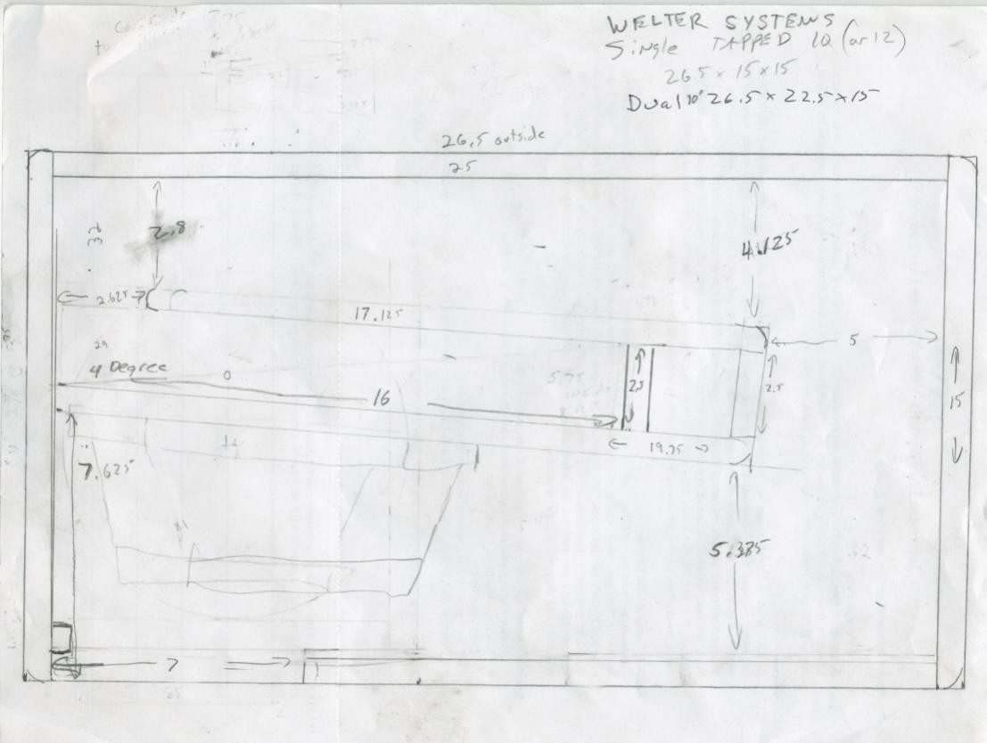

I have built single and double TH using Eminence Kappa 10" speakers.
Below is the response curve for the single, which is only 15" x 15" x 26.5".
It weighs 72 pounds using 3/4" birch plywood.
The dual 10 version was 15" deep by 22.5" tall, 26.5" wide. For PA mid bass use, the exit could be shifted so the cabinet would be 22.5" deep and only 15" tall.
I did some distortion tests on the single, unfortunately burning a portion of the voice coil which was rubbing due to a cobby cone repair Frankensteined together that resulted in uneven voice coil alignment. Also, the test was done in 100 degree temperature with the magnet structure directly exposed to the desert sun, it was too hot to touch when it burned out. Normally I only expose the speaker to high power sine wave for about 2-3 seconds, then wait 10 seconds before advancing to the next tone. In this case, I was (slowly) typing levels, then shifting to the next frequency rather than doing screen shots and extracting info later. I think the driver easily would have easily survived the test if I would have used shorter duration sine wave tones and the driver was shaded.

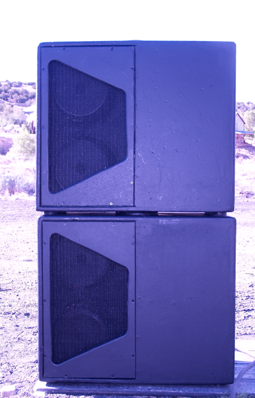

The upper output is impressive for a box that size, 126 dB using 54V (365 watts @ 8 ohm) one meter with less than 10% distortion. Distortion would probably have been less with a stock Kappa 10", the box works quite well as a drum fill, crossing a pair of 4" above it at around 200 Hz. The picture shows the little 2 x4" with an EV tweeter bolted on to it, used it for side coverage on a recent show.
Art
P.S. The 45 Hz sine wave test was first, it is well below what the cabinet does well. Next test was 60 Hz, where the TH has good kick, then on up to 250 Hz.
I then typed in the frequencies for a 45 Hz and 50 Hz test, but burned up the speaker before finishing typing in the 50 Hz fundamental level, the 45 Hz test was not done.

The 1x10" and 2x10" TH really were just done to re-use some existing cabinet shells and speakers that were gathering dust. Not an optimum design in any respect, but they do well in the kick bass range with a healthy bit of EQ.
The Keystone exit smoothed out the response slightly compared to the straight mouth, but you will have to approximate the size from the photograph, as I did not write down the dimensions before selling the cabinets.
Art

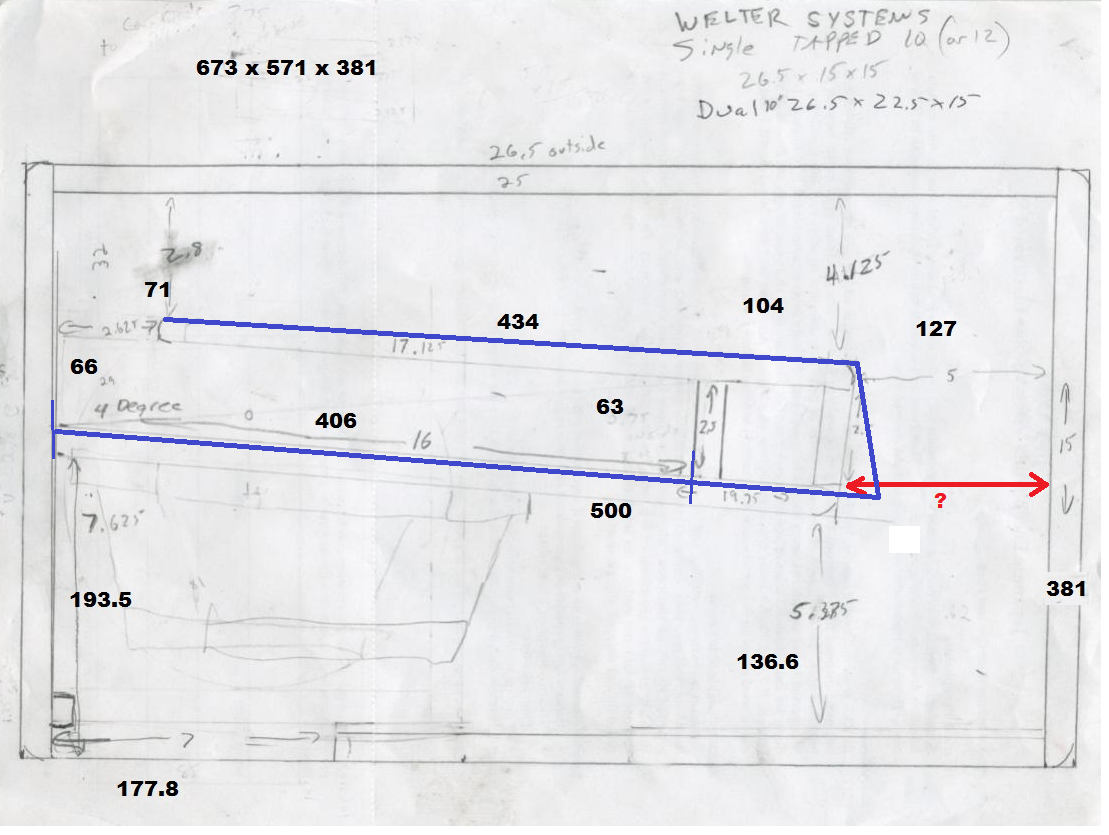

Tried to build it today... There is something wrong. When I followed those dimensions I ended up with something like that.
Or am I wrong? (black is metric size).
The question mark dimension is 5.25 inches, 25" (interior dimension) -19.75"= 5.25".Aloha Art.
