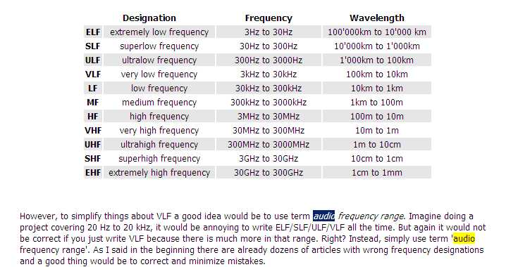

I forgot to define "ULF". I'd argue it's anything below th Schroeder frequency

As to ULF here is a reference for the proper designations of frequency ranges: Frequency bands
I'll attach a quick screen print from this article for reference.
